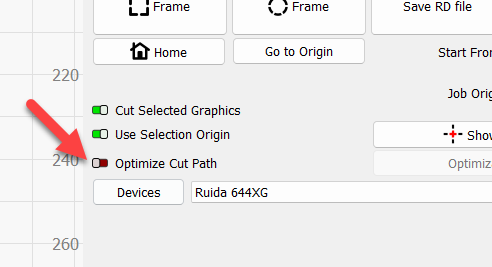

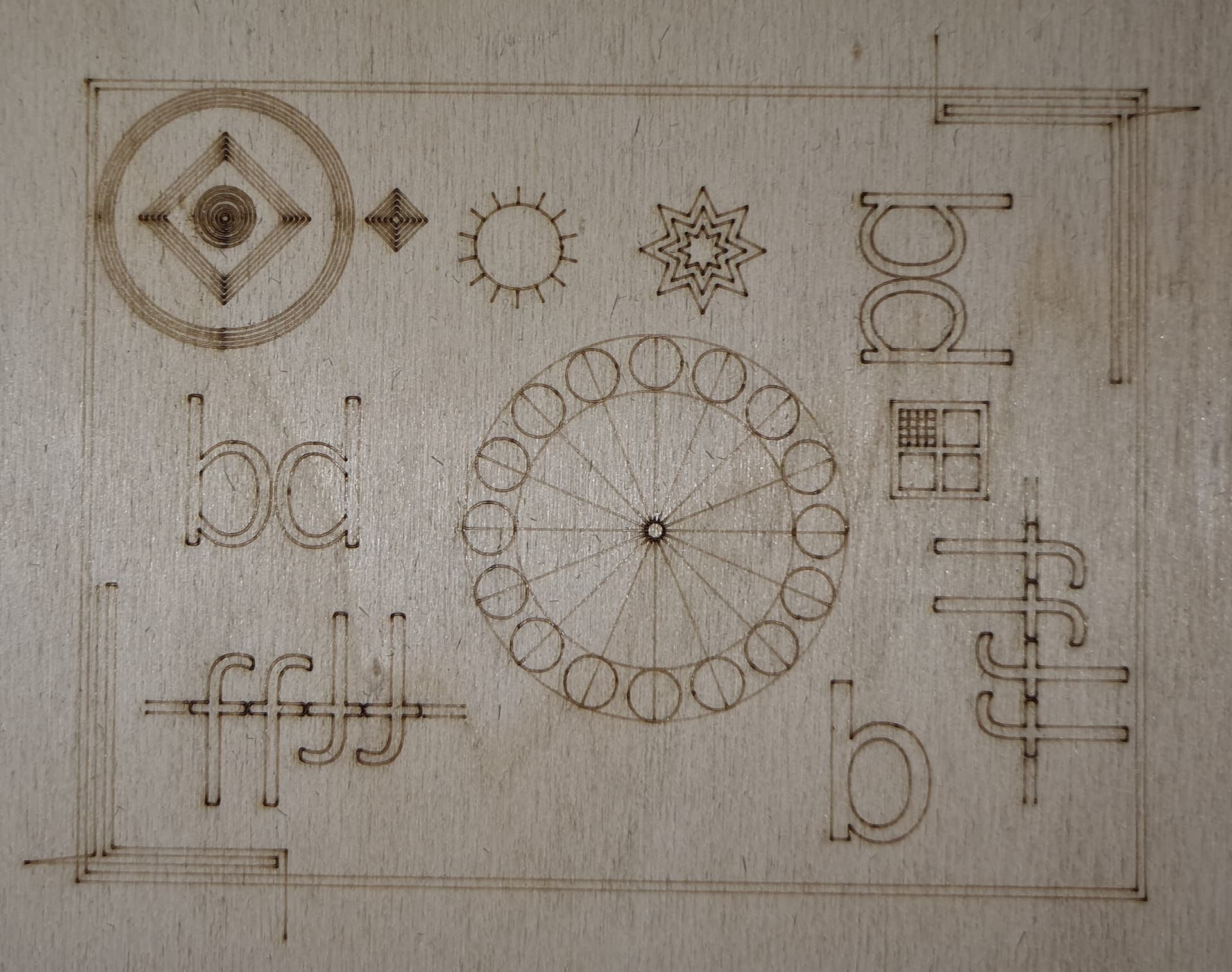

Try running this attached test file on any scrap material that will mark (134x104mm) - I’m trying to get a better picture if the extent of the lost steps.
Test.lbrn2 (73.5 KB)
Please turn off ‘Optimize Cut Path’ for the test:

BacklashTest.lbrn2 (161.3 KB)
