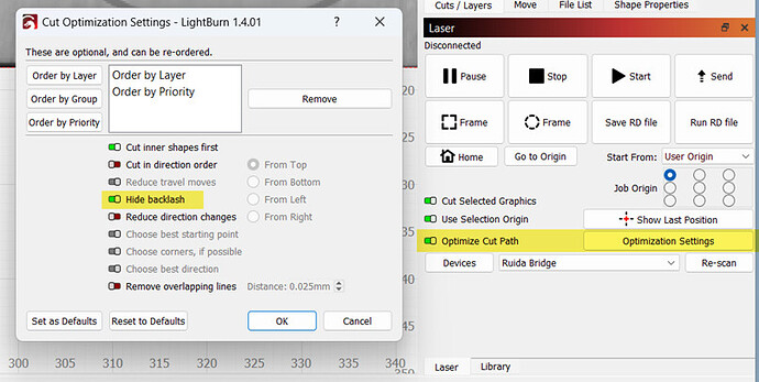

There is evidence of some backlash in your Y-axis;
You may be able to reduce this backlash by identifying any slop or play within the drivetrain, and tightening/tensioning where possible according to your machine, however over-tensioning will cause new problems.
If hardware troubleshooting yields no improvement, LightBurn has software compensation for backlash which can be enabled with the ‘Optimise Cut Path’ setting ‘Hide Backlash’:
