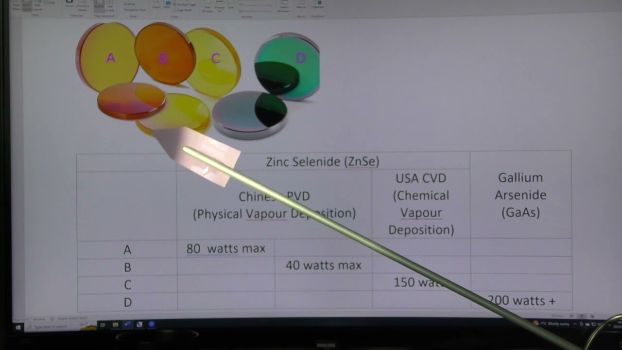

Here are a couple of videos that I watched a few years back and a newer one I haven’t. Might be worth a watch…
Good luck
