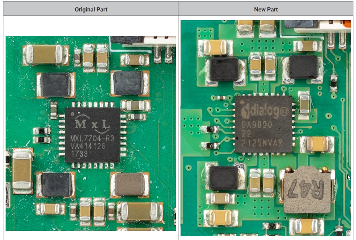

It seems that around 2022 the Raspberry Pi 3 Model 3B+ had a revision with an updated PCB and a new DA9090 PMIC that required different firmware.
Was reading here:
https://forums.raspberrypi.com/viewtopic.php?t=361383
The newer firmware may not have made it into the bridge image which hasn’t been updated for some time (we’re looking into it, and will update the bridge image soon if needed).
How to tell if you have the revised model:
As suggested in the pi forum post, I guess right now you could try manually updating the firmware in the bridge image and see if that helps.

After talking with the LightBurn support team, they suggested that my Raspberry Pi 3B+ might have a newer hardware revision that requires updated firmware files and they explained me how to proceed.
So, to fix it:
  1. I downloaded the latest Raspberry Pi firmware from this GitHub repository.
  2. I extracted the start*.elf and fixup*.dat files from the ZIP.
  3. I replaced all start.elf, start_x.elf, start_cd.elf, start_db.elf and fixup.dat, fixup_x.dat, fixup_cd.dat, fixup_db.dat on the LightBurn Bridge SD card with the new ones.
  4. Inserted the SD card back into the Raspberry Pi 3B+ and… it worked! :tada:
