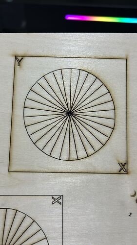

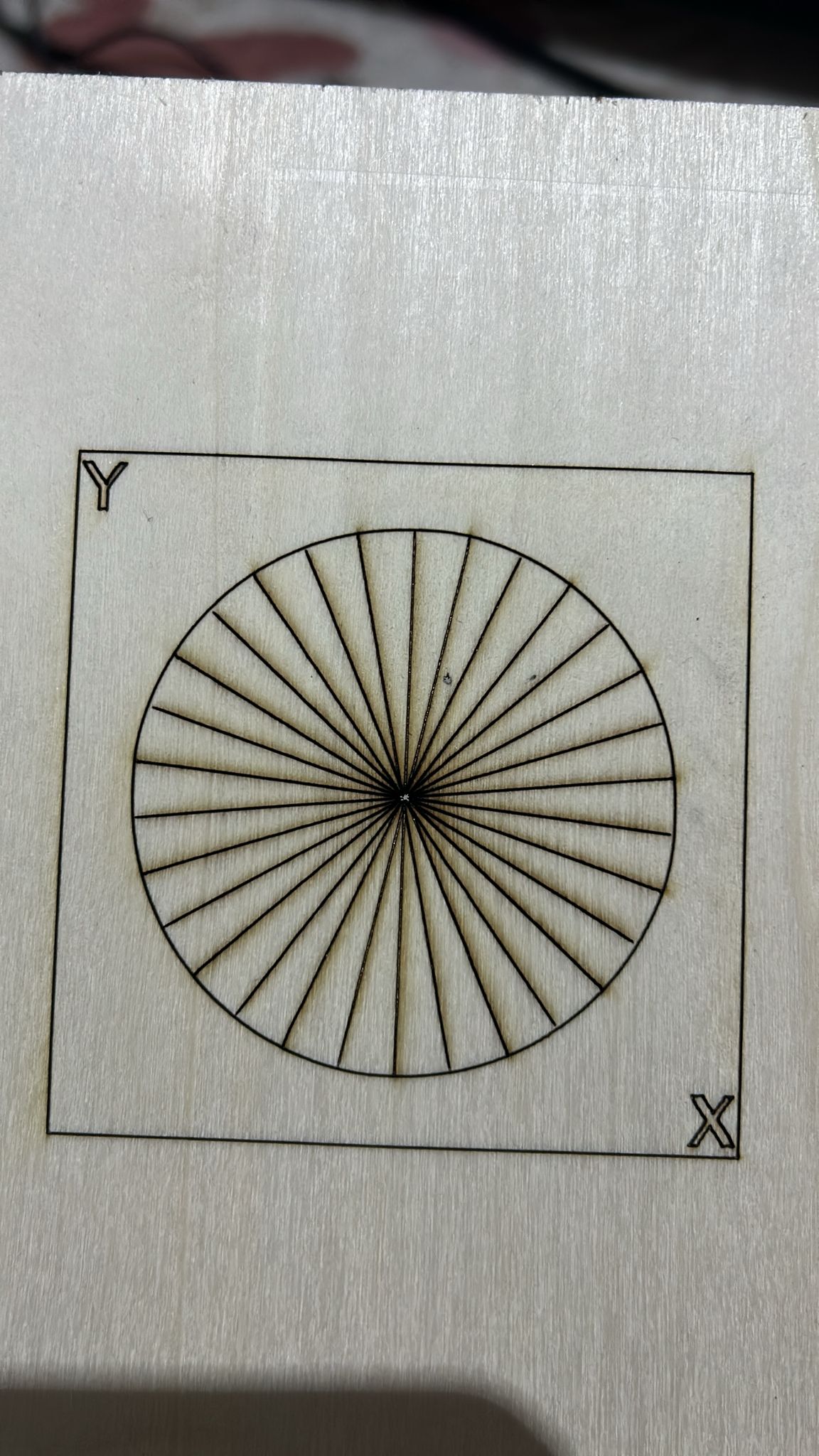

My names and logos appear shadowy. It seems like there are layers. Where do you think the problem comes from? Thank you.

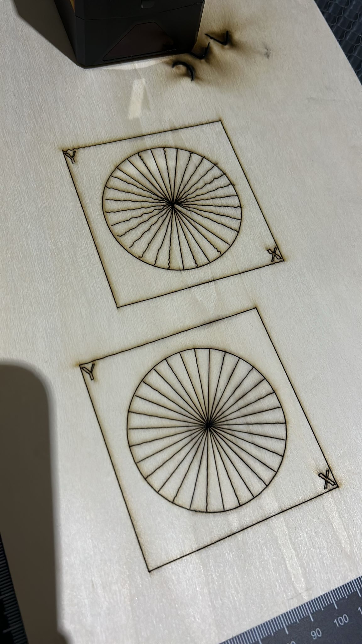

Your X axis belt needs a lot of tightening as you hare having a lot of ghosting
Can you run this in cardboard or plywood? post picture of results upclose please

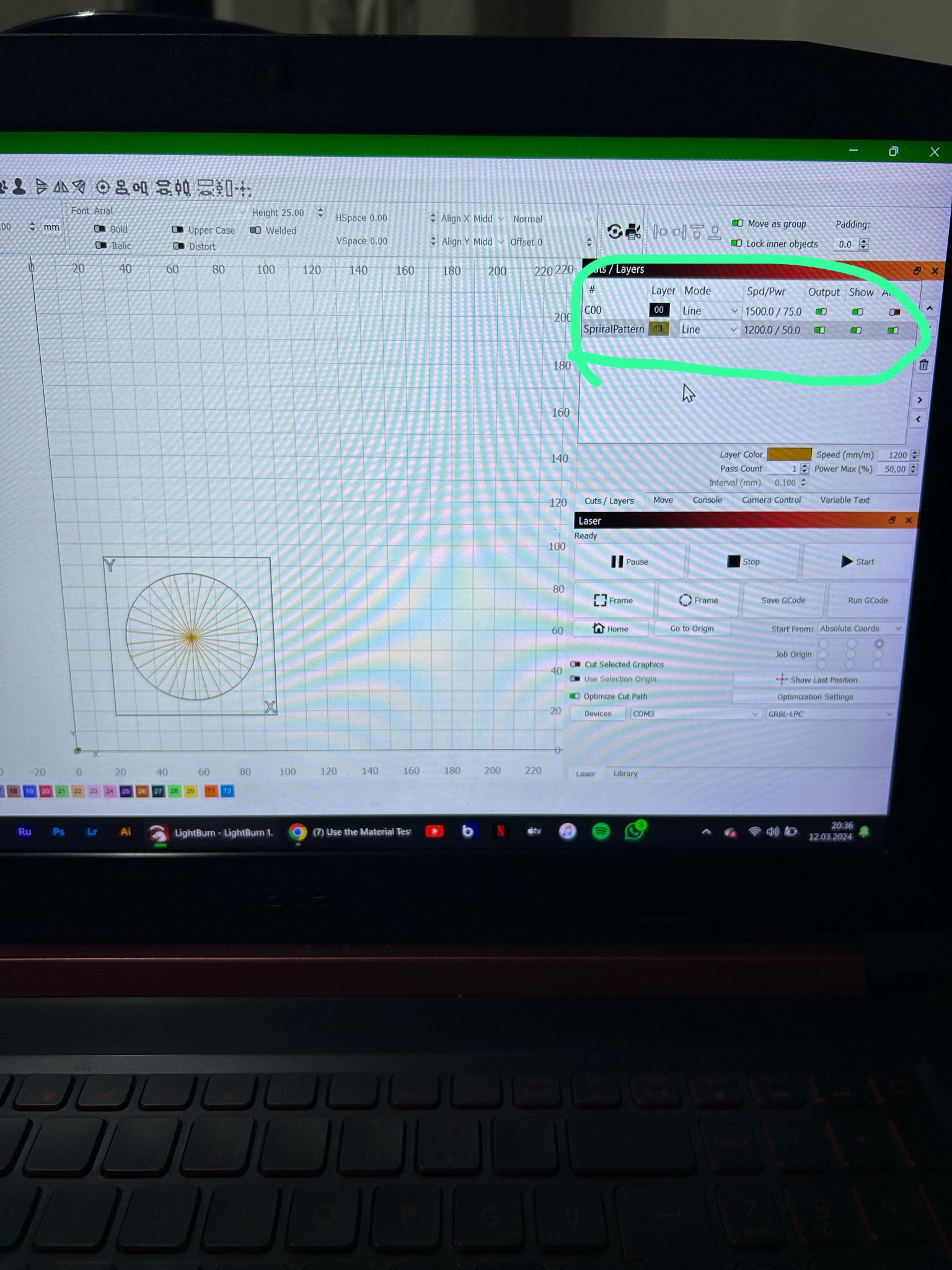

Dot Test with Angle.lbrn (46.3 KB)
This looks like the result of a mechanical issue. This article from our troubleshooting documentation might be able to help you.

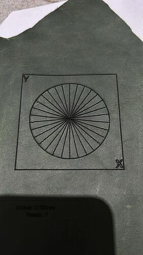

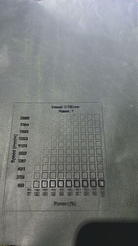

my 2 attempts above
My 1 attempt below
third time I tried
Something in your frame/Table top is VERY loose.

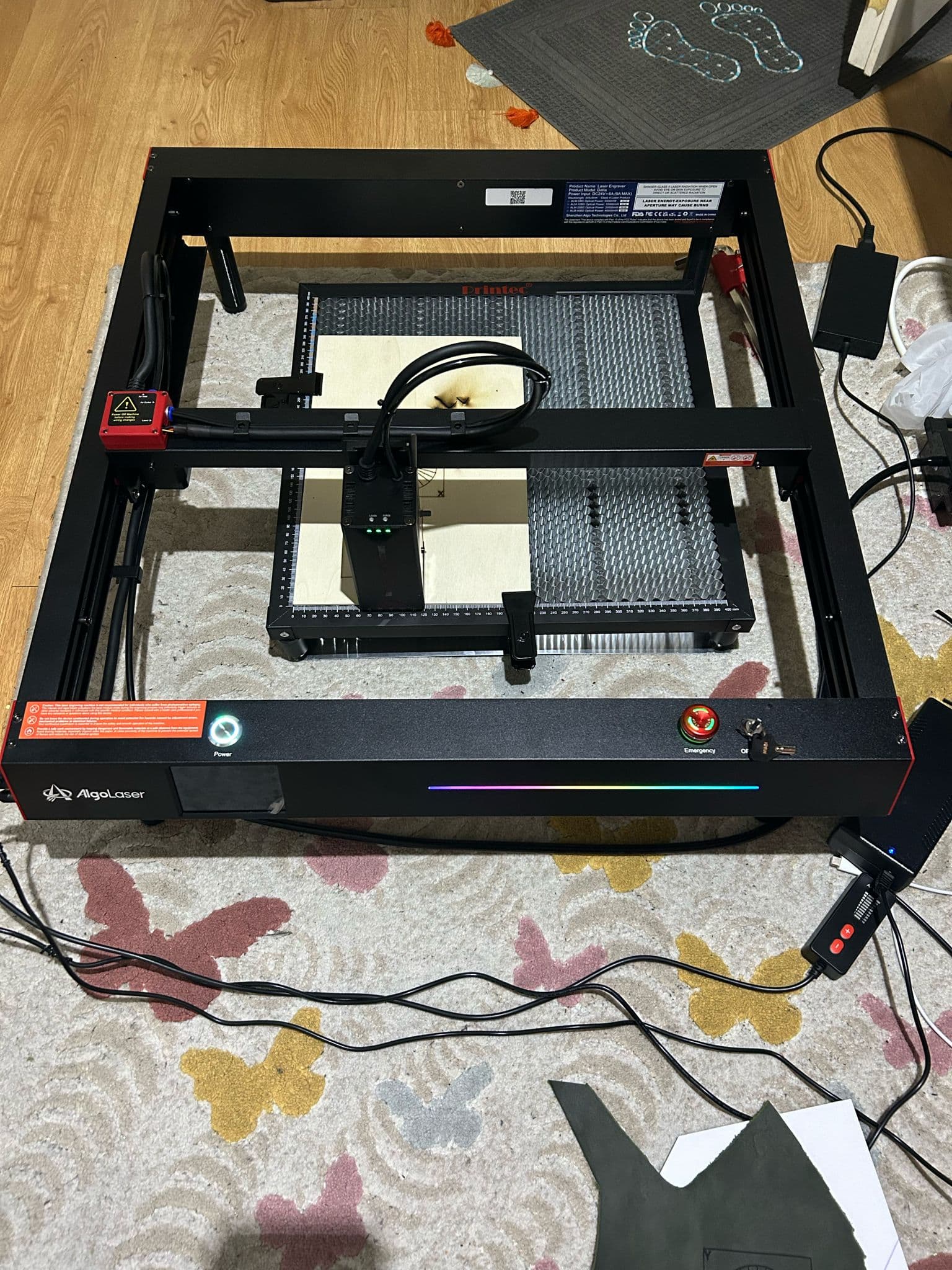

  • Is your machine setup correctly on a sturdy stable table? what happens if you set the machine on the ground and repeat test?
  • can you send a image of your belts, you have some tightening to do on both X and Y belts (X is normally pre tensioned from the factory but you need to tighten it a bit)
  • did you change the file settings or just ran as is?
now it makes sense

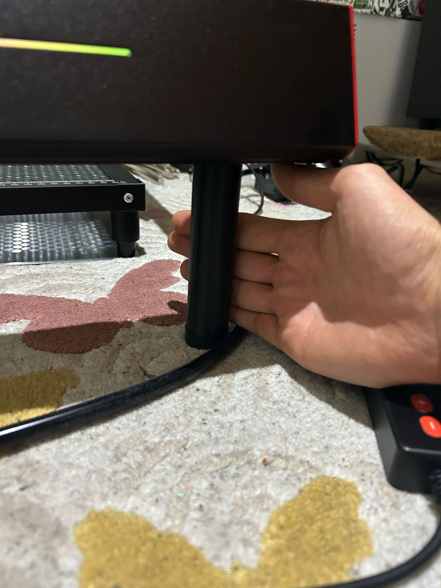

a) Tightem more the x belt by tightening the right hand side bolt (center one)
b) You are lifting the machine a lot necessarily, unless you are planning to do Rotary .
This lower the center of gravity of the heavy module a lot, causing those ripple effects
Try this, remove the extension legs, set the standard ones and retry the file
Okay, I will remove the long legs again and replace them with the original legs. I tightened the x straps and tightened the (y) straps on the right and left a little.
I am using the settings you sent. I did not change the settings

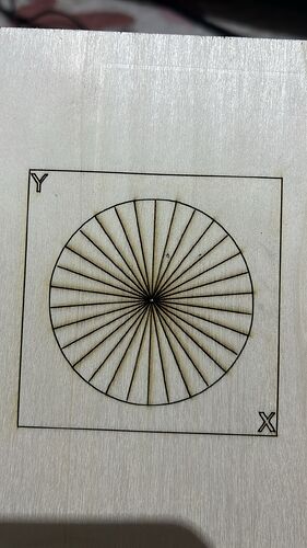

looks good!
thank you sir
How is it sir?
Now we talking
There is a slighttt tension issue on the X
If you move the laser head to the left/Front
Then you pluke the belts as if they were a guitar string, they all should sound high pitch and pretty much alike
If the x is “lower” pitch than the Y then you need to tighten it a bit more
Remember there is a smaller cross screw that tighten the X tension block you might need to loosen first
I would however work like this for a few days, as belts tend to settle
THEN revisit the belts tension
Yes, I may have tightened it too much. I’ll loosen it a bit. now
I will try what you said today. I didn’t know that
Notice the flatness of your Circle on the left and right
Your X belt is loose, tighten it progressively until the Y and X font is perfect and circle is as well
