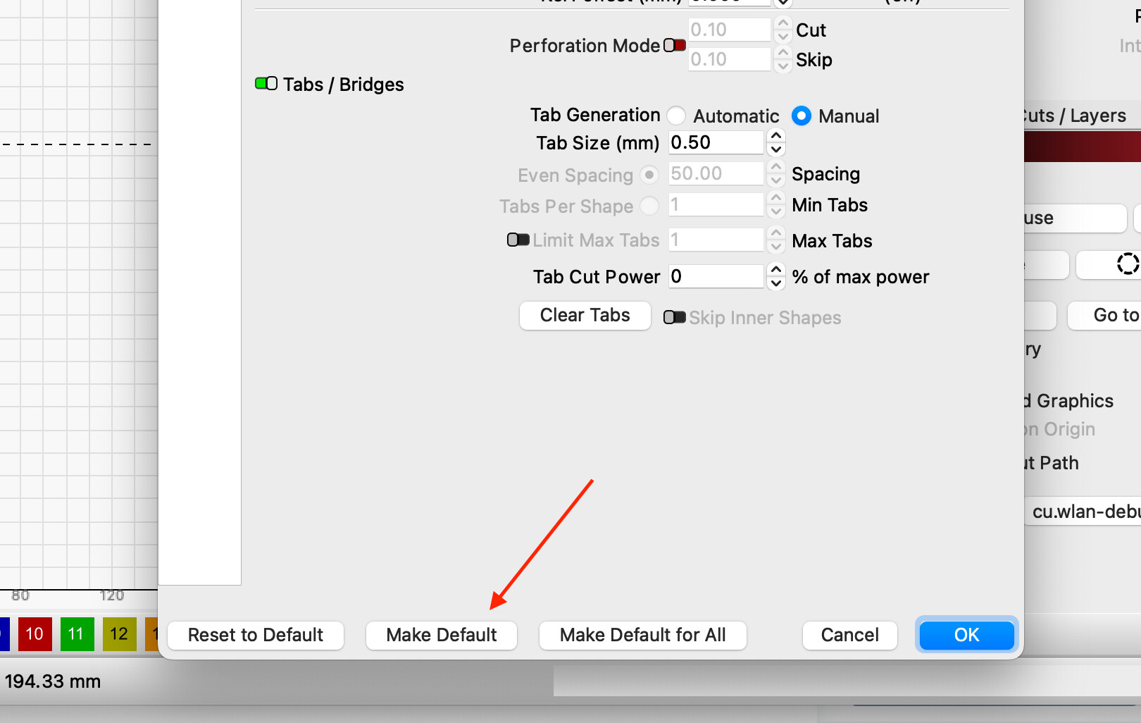

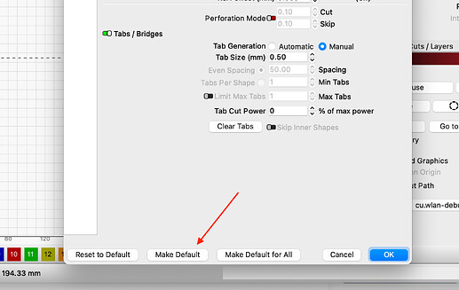

Hi Andrea,
To add - if you just want default layer settings to be different when beginning new projects. You can setup your desired settings for a given layer in a given profile, then click ‘Make Default’ in the bottom left of the Cut Settings Editor:
Overview - LightBurn Software Documentation

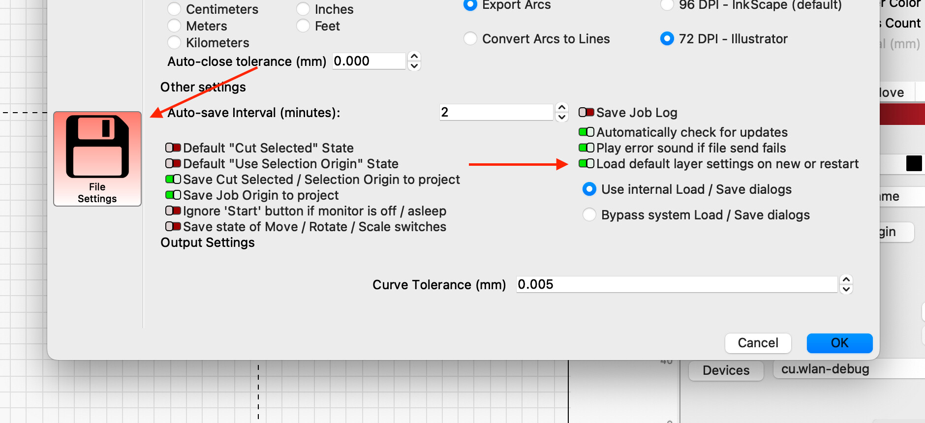

In the LightBurn Settings window, under ‘File Settings’, be sure to toggle on ‘Load default layer settings on new or restart’:
https://docs.lightburnsoftware.com/UI/SettingsWindow.html
