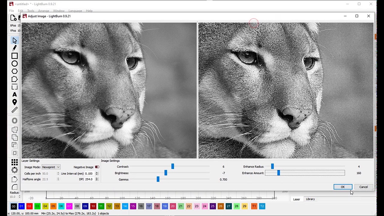

Take a look at the following. In particular, the new ‘Print’ feature allowing you to output LightBurn designed work to print-driver driven systems. This link jumps to that section of the video, but there are goodies throughout.
