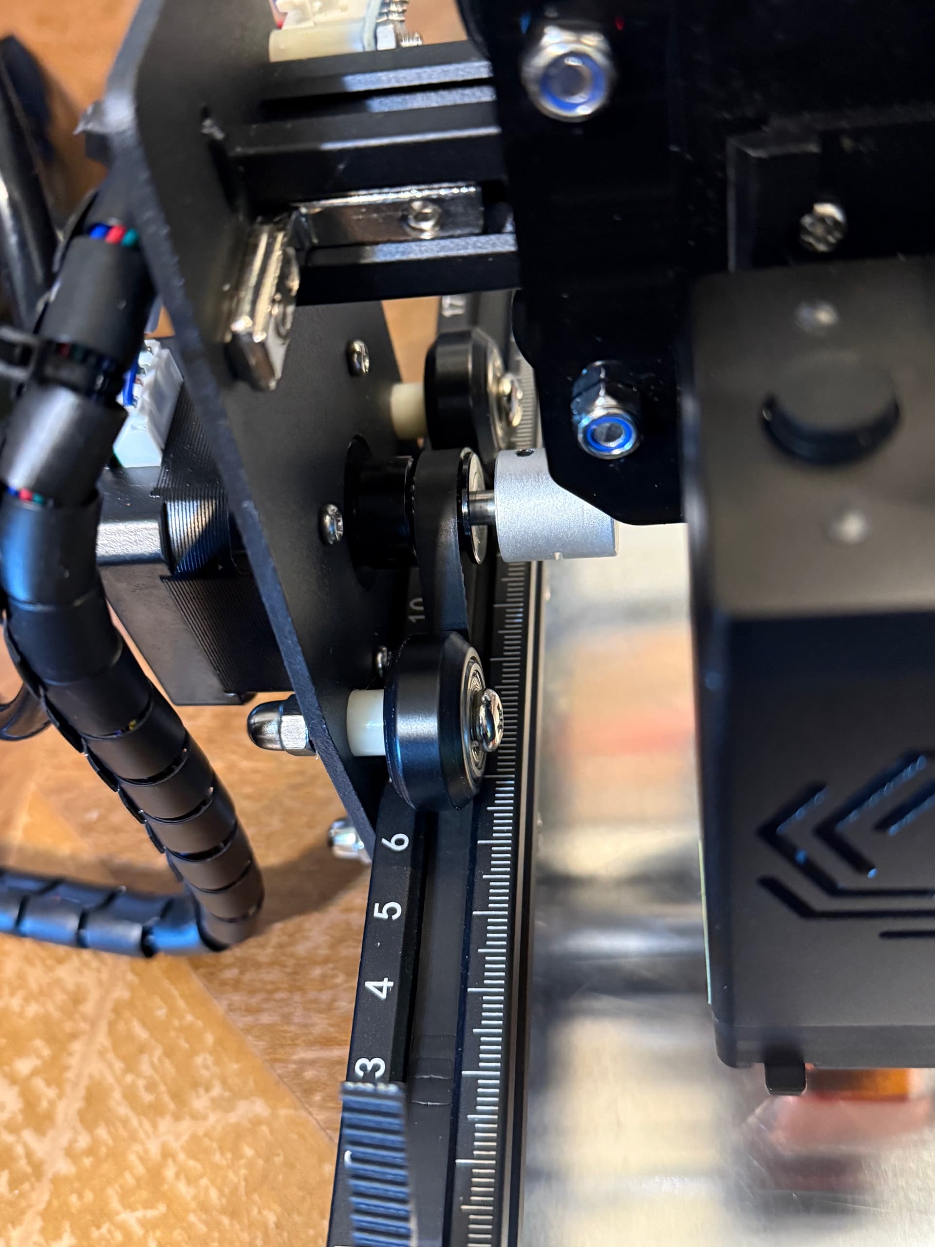

Do the plates on the ends of the Yaxis have wheels riding on the rails? If so, there might be an adjustment there (eccentric cam) that adjust for the ride on the rails.
Yes there are wheels there. I will check that out.
That fixed the tilt test problem!!! It rolls freely now at a consistent speed when I do the tilt test. Finally something positive!

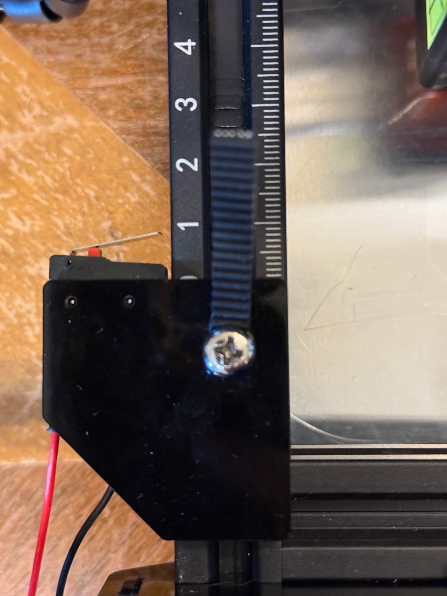

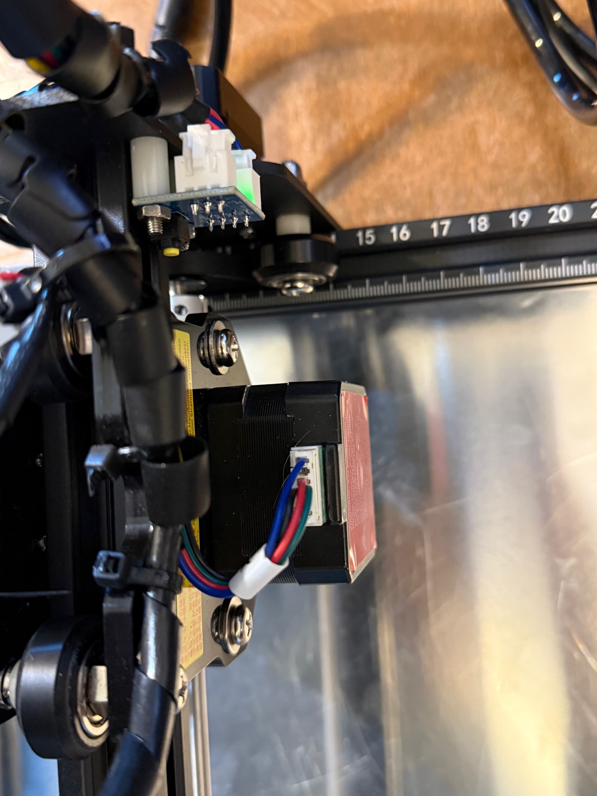

You said you only see 1 limit switch. There has to be 2, one for each axis. One should be on the gantry and the laser head should make contact with it when it moves fully left. The other one should be on the frame and the gantry should make contact with that one at the front. They can be installed incorrectly where contact isn’t made and that would account for the grinding when homing. You need to verify their presence and that contact is being made. Make sure the wires are connected correctly as well.

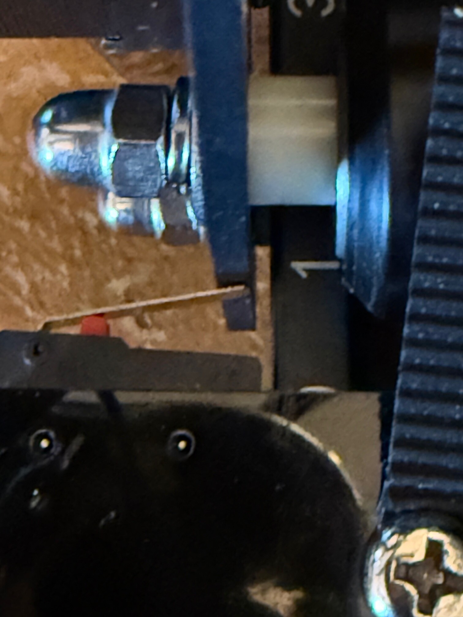

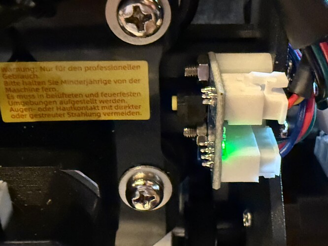

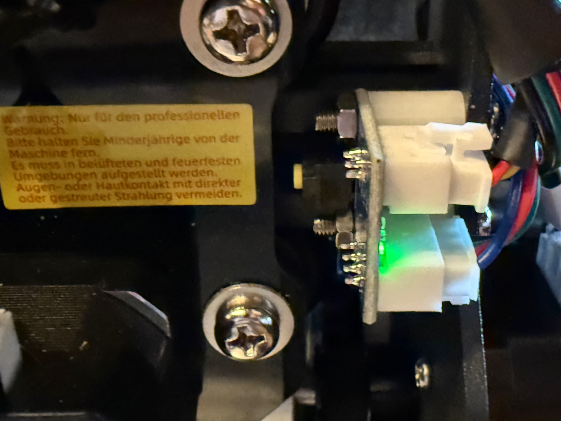

It was pre-assembled. I still don’t see a second switch. Maybe it’s the thing in the picture that looks like a little yellow button. It kind of looks like the other switch but without the silver piece that sticks out. But it still does make contact.
There’s a green light next to it. The thing the laser is mounted to touches it an activates it when it goes to the left. My pics are not as clear as yours but maybe they will help.

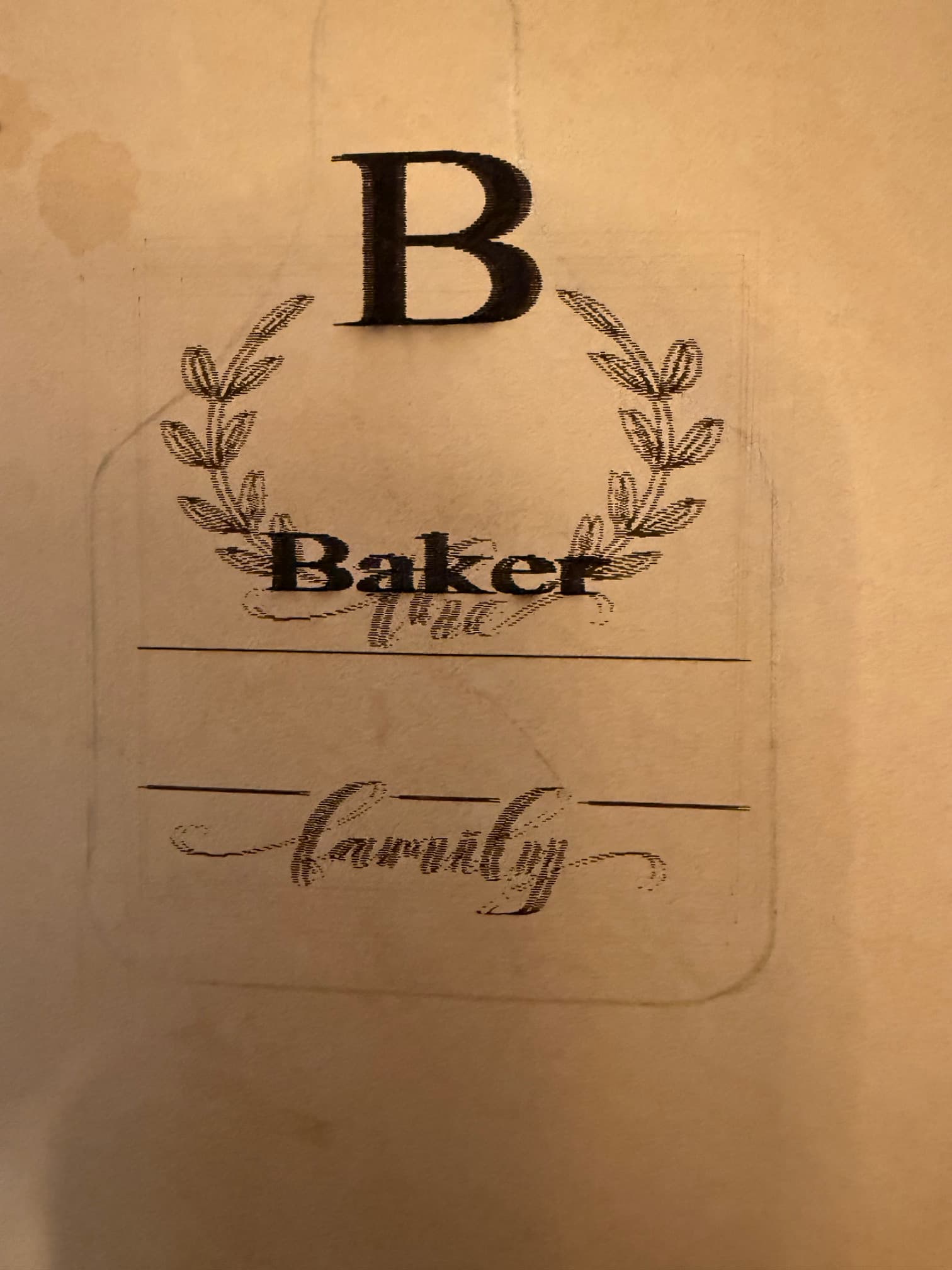

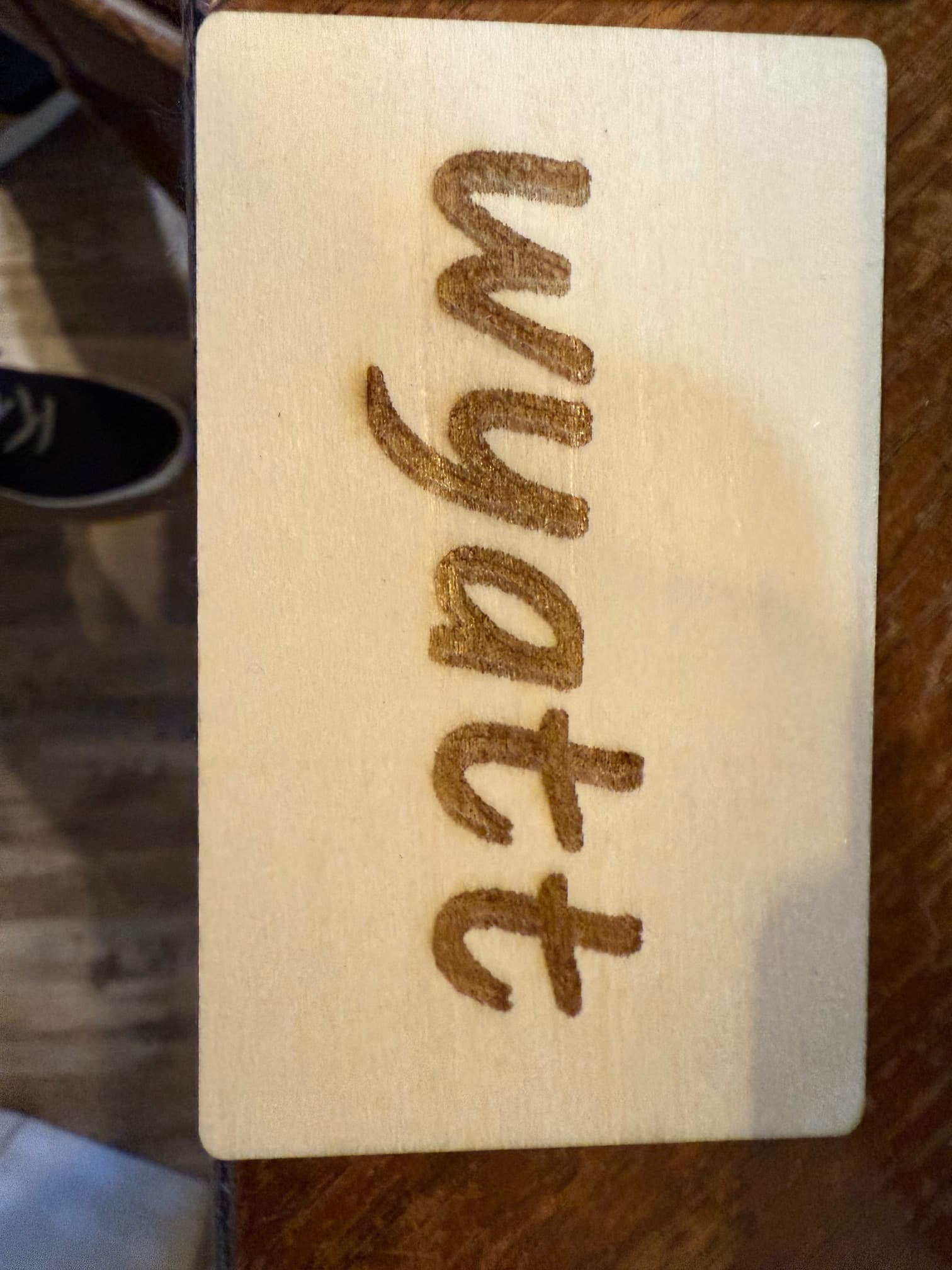

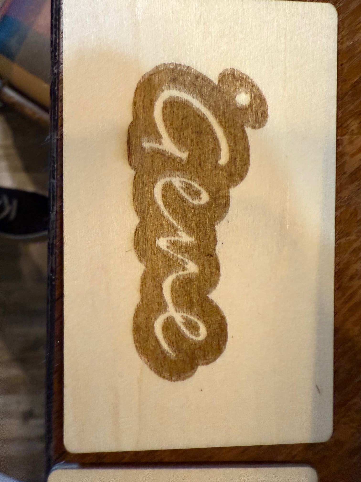

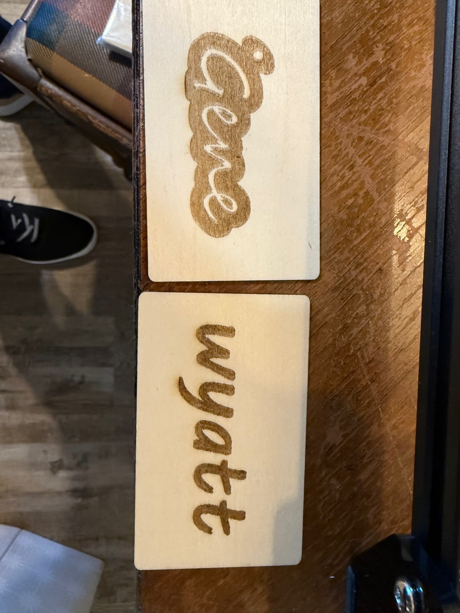

Idk if I’d call these successful but here are a few things we’ve been able to burn just testing things out and trying to figure it out. The two names, Wyatt and Gene, are what my daughter managed to do after many failed attempts. The one on leather with the B and The Baker Family on it is what I managed to do yesterday, but for whatever reason, the B and the name Baker jumped up out of the frame. It isn’t like that on the screen in LB. I have no idea why it did that.

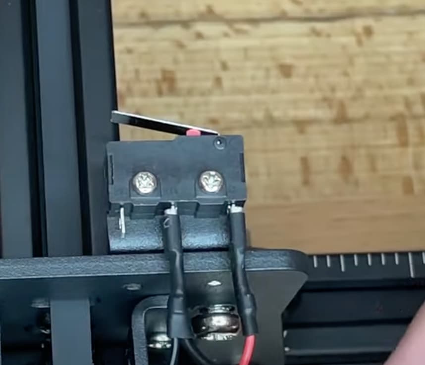

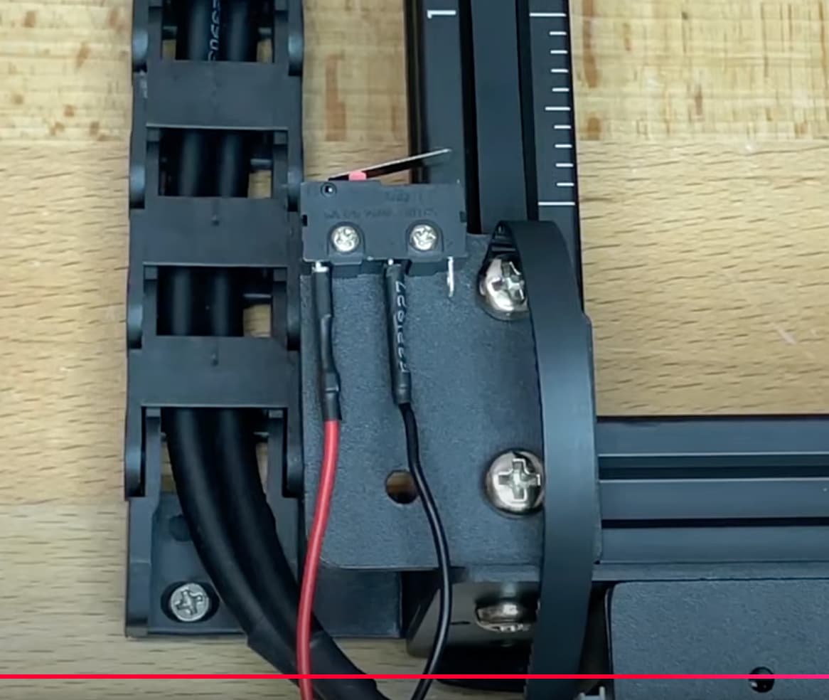

The pics I posted were screenshots from a YouTube video of someone assembling one. It’s a couple years old and they may have made changes to the switches used since then.
Looking at the way the wires come out here, it appears that they may not be on the correct terminals. Turn the laser over and verify that the wires are on the same terminal as the pic I uploaded.
Is this as far as the gantry goes? This switch doesn’t appear to be activating in this location. If the gantry is all the way to the front, loosen the mounting screw(s) for the bracket the switch is on and slide it until the switch clicks and lock it in place there.
I believe you are correct about the yellow button being the limit switch on that axis. The fact that the green light changes when it hits indicates that that one is working.
When it’s homing, it goes on into the silver thing and activates it but pulls off it after that and parks where it is now.

My guess is that the Y axis belt is too loose and it jumped when trying to go back to the bottom for the name. I also notice some scan line errors in the other engravings. You need to go through the entire machine and get it adjusted and chack for loose pulleys, belts, etc. I will link to a guide below.
This file will verify slop in your system. Scale it up to fit your work area and run it on cardboard at high speed with just enough power to get a good marking. Turn off Optomize Cut Path in the laser tab. Post a pic of the results.
