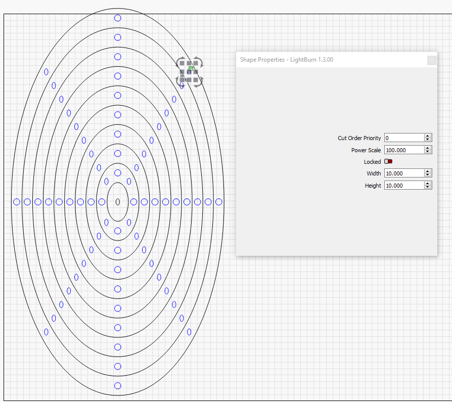

I’d like to know if it’s possible to have like 10 objects (individual shapes), that are combined in a group, and the change the overall size/scale, while retaining each shapes size and aspect ratio.
Like in this picture I need to have the circles overall dimensions changed, but I need each circle to still be a circle, and not an arc.
-Hope you get my point?

Thank you very much for the reply. I think you get me wrong though.
I do know all the normal features, keeping the aspect ratio when resizing etc.
What I need is to be able keep the specific dimensions of each item, while resizing it overall.
Please see the attached picture. I need each circle to keep its size and dimension, but I need to overall be able to scale the object.
In the picture I have manually added the round circles to the resized oval circles, but this is pretty time taking.

Maybe this image describes it better. For an example:
I’ve made these shapes that are basically some circles in different sizes. These are changed in aspect ratio, as seen in the picture. The red “dots” inside is for brad nails, so they should keep the size of 1 x 1 mm, even if the overall “circles” are changed in size and dimensions.
Do you get my point?
When changing the aspect ratio on the overall circles, the 1 x 1 mm circles are skewed as well, meaning I have to paste a new 1 x 1 mm circle onto each of the points, and this is quite time taking.

  1. Assuming that, start with the elliptical shape with the elliptical peg holes.
  2. Select all the peg holes
  3. Go to Shape Properties, then set width and height to match peg hole size expectation
That should get you back to full circles.

Actually your last suggestion almost did the trick… The peg holes that are placed perpendicular to the working working space/grid (90/180 degrees) can be resized perfectly.
The weird thing is that the peg holes that are placed 30/90/etc degrees are not resized at all, though when checking it does say that the size is equal to the others.
Any idea what can cause this, and maybe how to solve it?
Did you create the circles using the circular array tool? If so, make sure you’re not rotating the circles as you create them.
I created the circles this way:
  1. Created an ellipse in the size if 1 x 1 mm.
  2. Created an array with 20 pcs vertical.
  3. Duplicated this array and than rotated it 45, 90 and 135 degrees.
It seems that Lightburn is rotating the circles and gets “confused” when the array is not perpendicular?!
If you make the circles without rotating them then this should work. If you rotate then this approach breaks down.
I suggest using the circular array tool to create the circles and disable the rotation option. You can do this easily if you create a column of circles at each ring diameter. Select one of the circles, add the center piece as a reference, then make sure you use “Use last selected object position as center” and disable “rotate object copies”. Repeat this for each ring of the circle.
I just did some different tests…
It seems that I can rotate the arrays in any degrees and still I can use the “shape properties” to change the size of the circles…But as soon as change the aspect ratio of it, ONLY the circles placed in the perpendicular directions can be resized using the shape properties.

It’s just weird that peg holes (circles) placed perpendicular can be resized perfectly, but not when in “non perpendicular” direction!
This is because height/width always works in the same orientation of the primitive shape.
This is the order of what’s happening:
  1. You create circle
  2. You rotate circle
  3. You distort circle
  4. You attempt to resize the width of the shape in Shape Properties.
  5. However, because the circle has been rotated before distortion, you’re now stretching the circle based on the original orientation for width which further distorts the shape.
