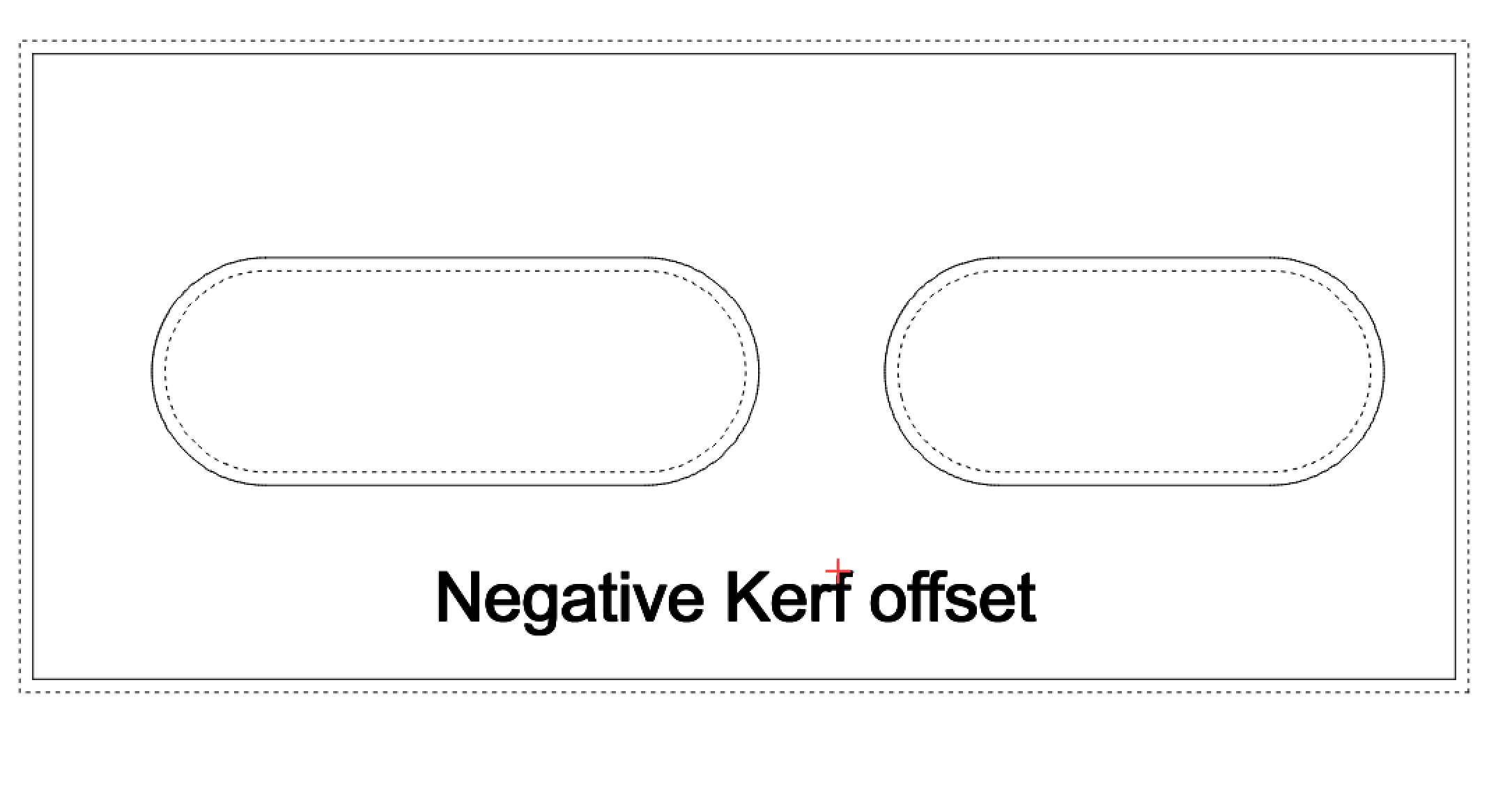

Let’s see if I can explain what it’s doing. It has something to do with hainge the entire shape cutting, Lightburn is moving everything toward the middle of the cut area. If you only select the oval, it makes it smaller. Better explained with pics.
I duplicated your shape and made a perforated layer of the duplicate with no kerf offset(dotted line is the original shape) and put a negative kerf offset. You can see how it will cut in the preview.
Here I only select the ovals with the same negative kerf offset. See how it handles them differently.

The issue is Lightburn treats a complex shape and a simple shape differently. Let me try and explain, at least to the best of my understanding. When you have a complex shape and request a negative kerf offset Lightburn takes that to mean you want everything smaller, so it moves the kerf inward away from the lines, which, in effect makes the inner holes larger when you thought they would be made smaller. A positive number does just the opposite, making the holes smaller. It’s expanding or shrinking the complex shape.

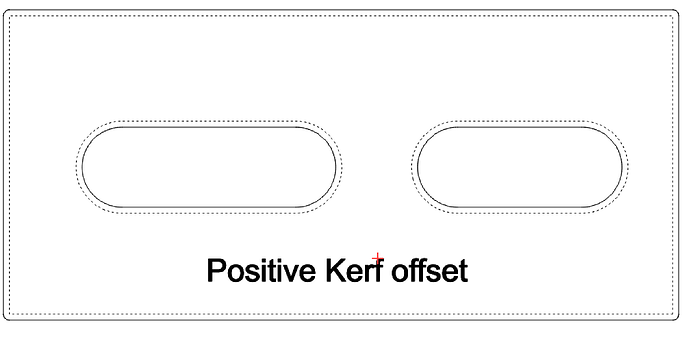

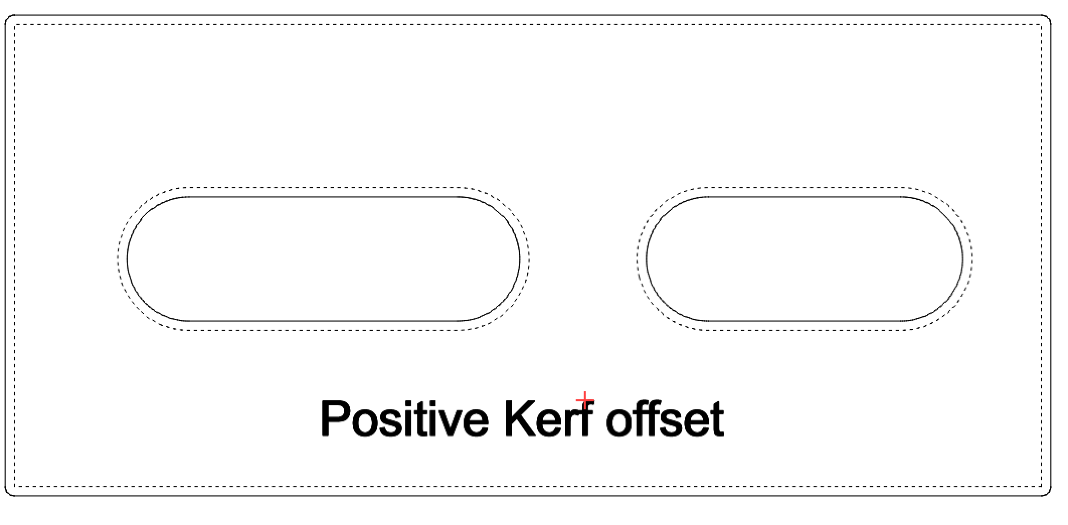

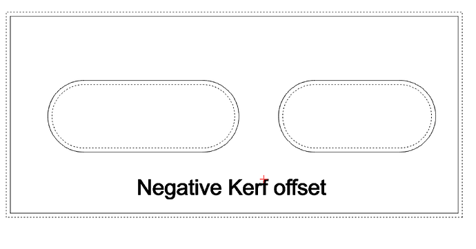

When dealing with a simple shape it works as you expect, negative makes the holes smaller and positive makes it bigger. Look at the screenshots below. The dashed line is the original shape without kerf adjustment for reference, the solid line is what will actually cut.
The first 2 images are your complex shape(all lines on the same layer) with kerf offset applied. Notice how it makes the entire cut area smaller or larger depending on pos. or neg. kerf.

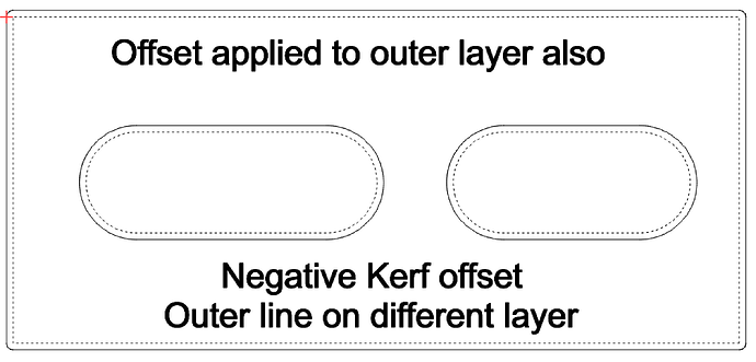

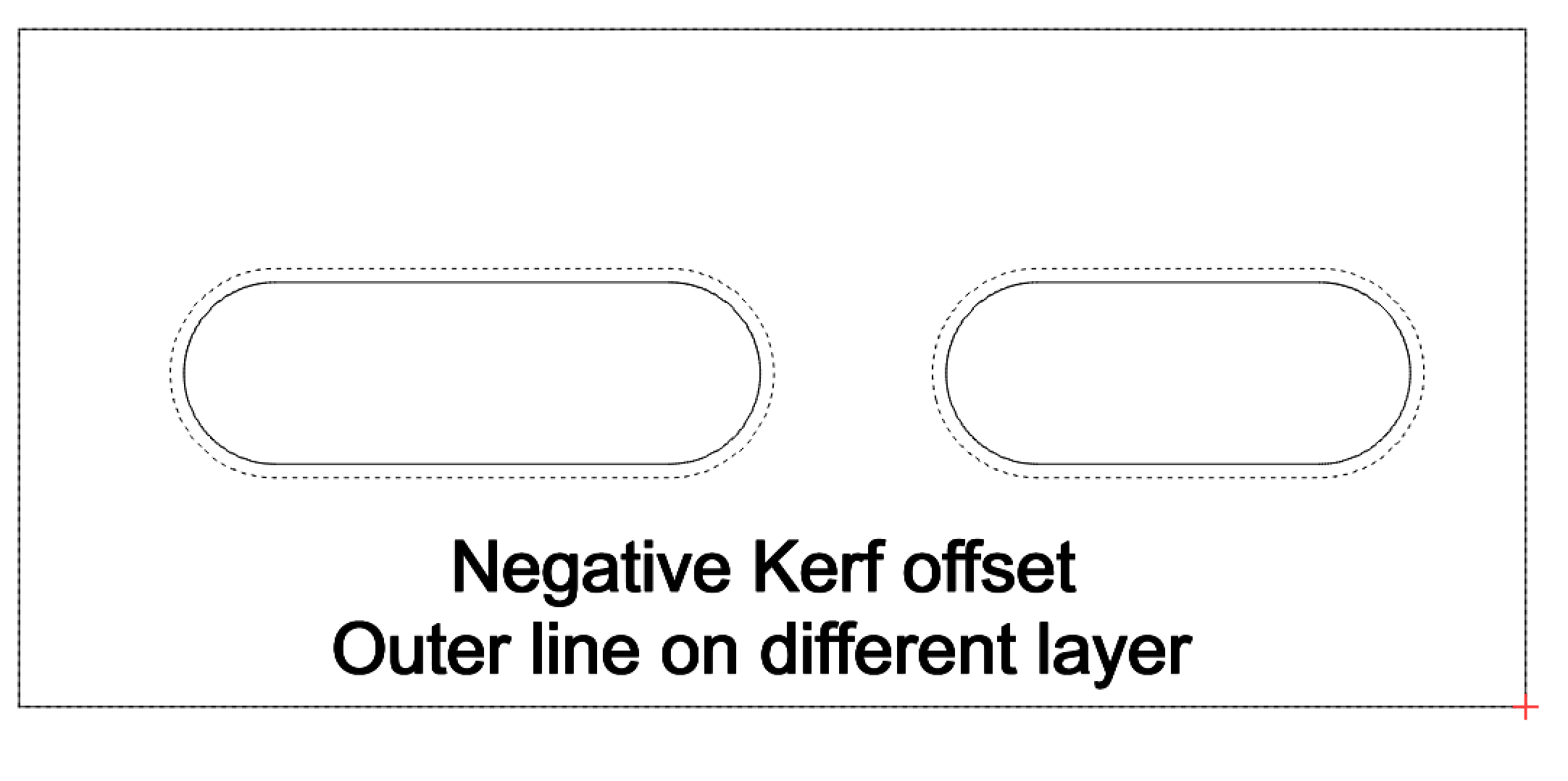

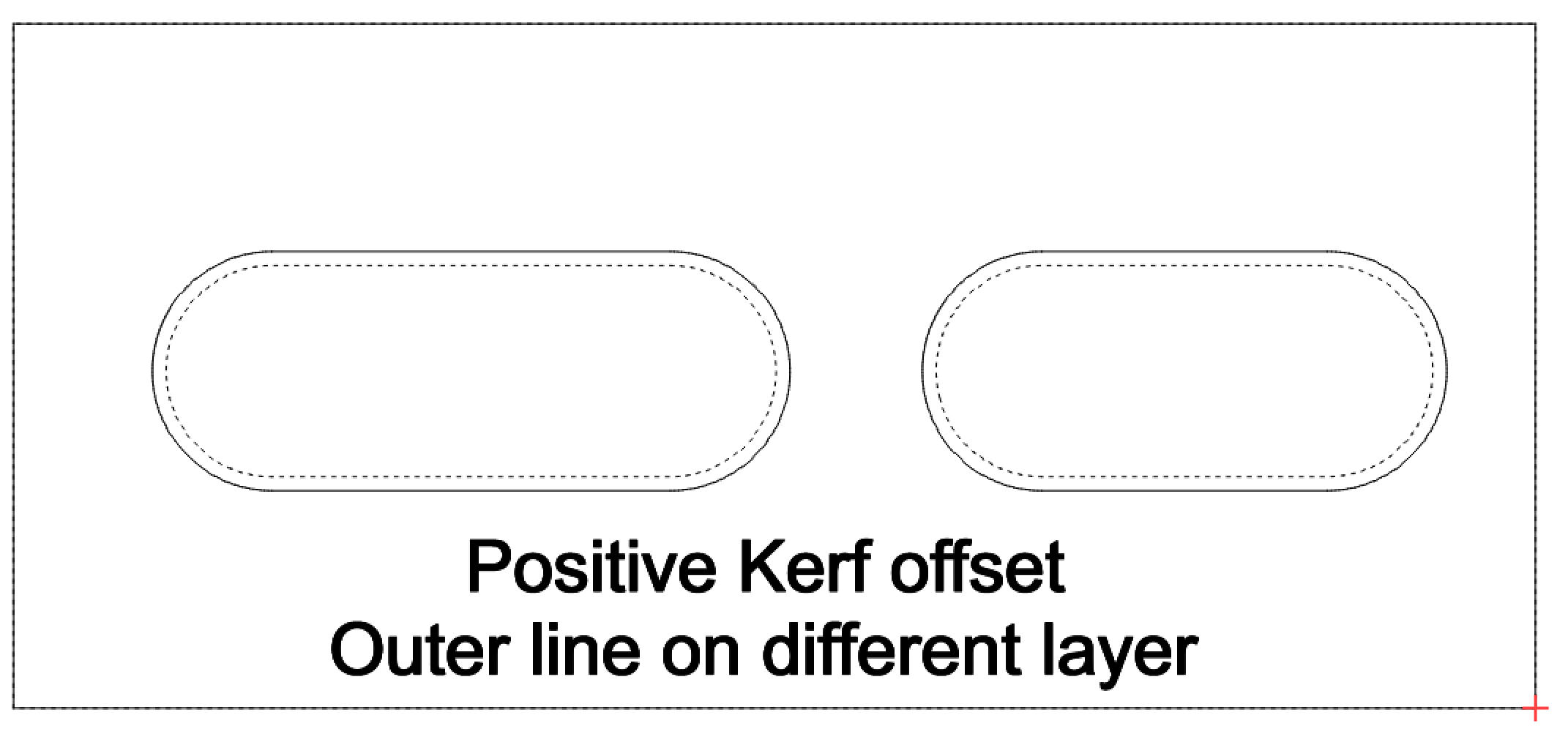

These next 2 are with the outer line on a separate layer and kerf offset applied to the holes, but not the outer line. Notice there is no change to the outer line. It is right on top of the dashed line. Also notice how the behavior of the holes is exactly opposite of how it was with the entire shape having the offset.

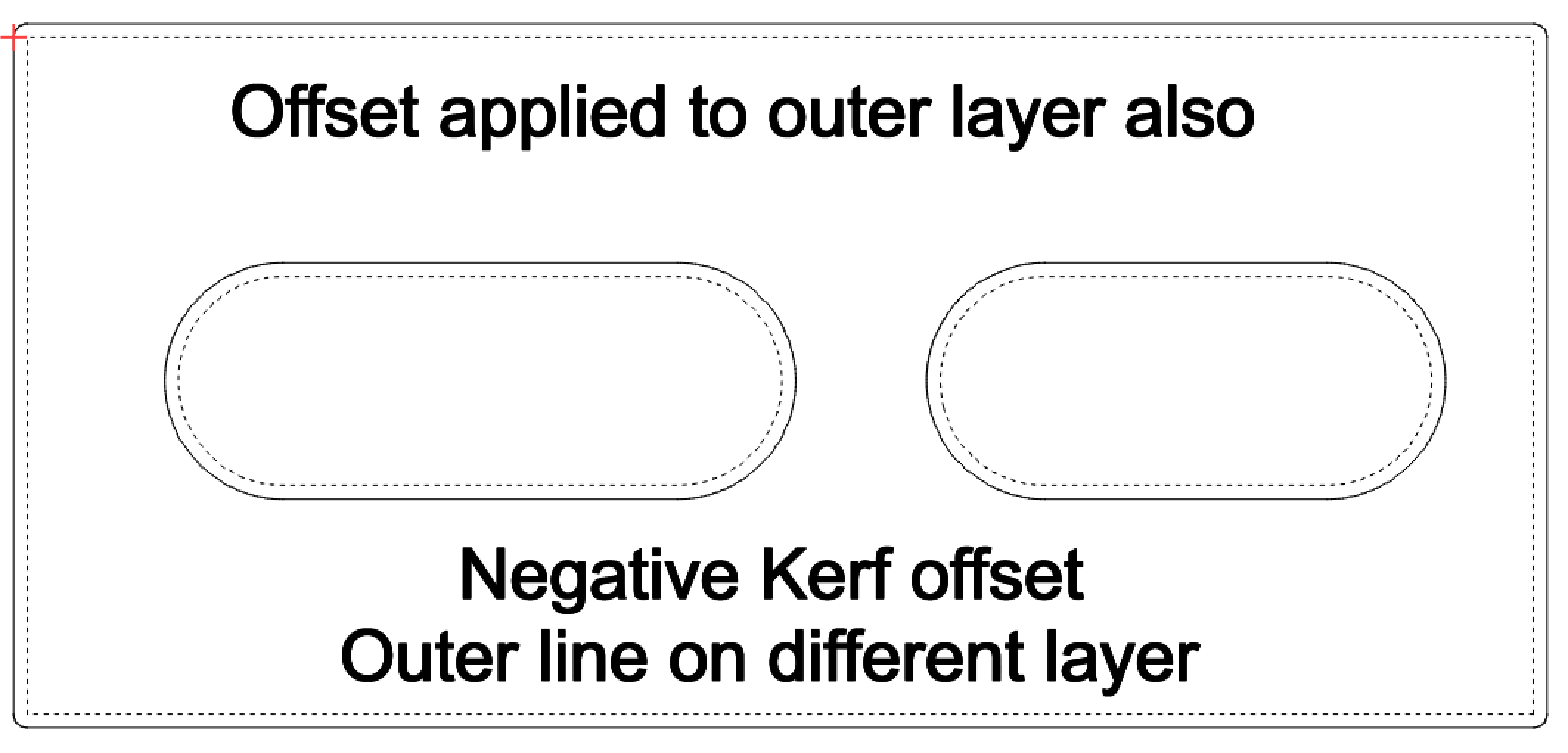

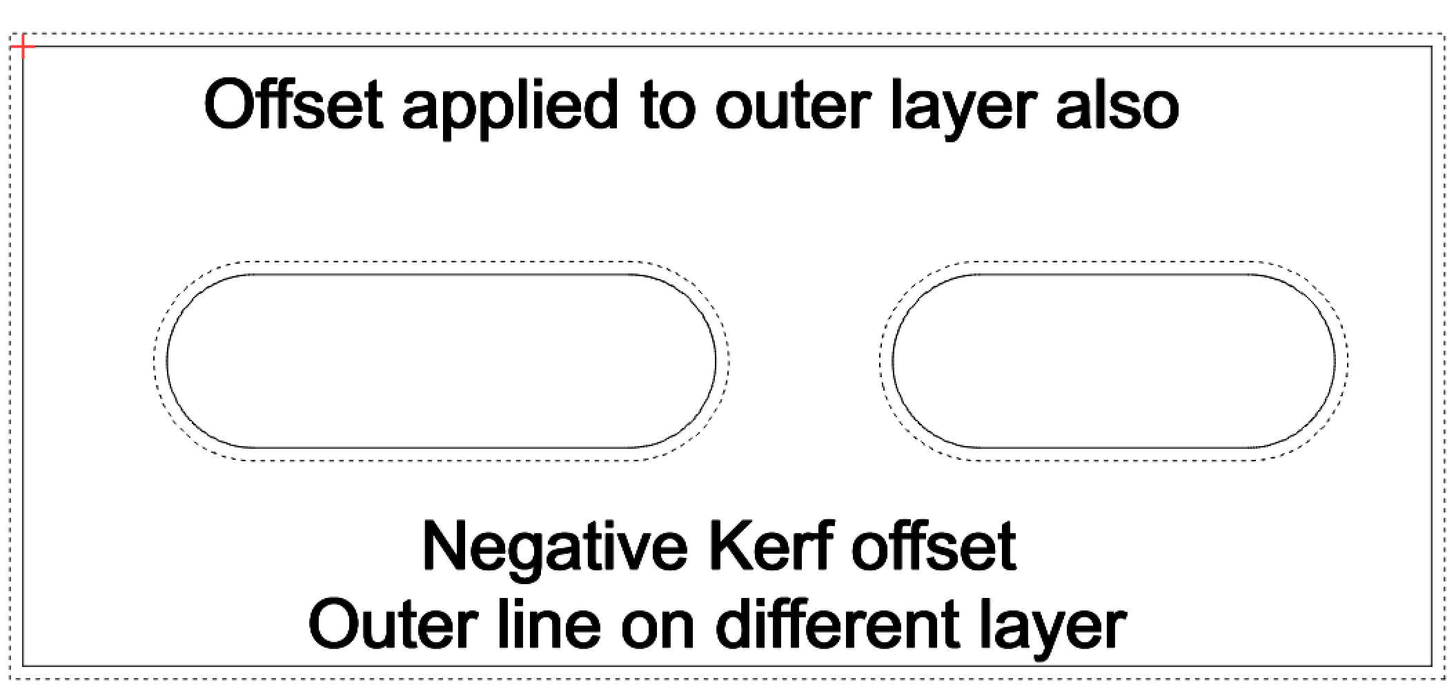

These last 2 are with the same offset applied to both inner and outer layers. The outer line is on a separate layer and the same kerf offset has been applied to both layers, but because they are not the same layer the behavior is different than when they were all on one layer.
