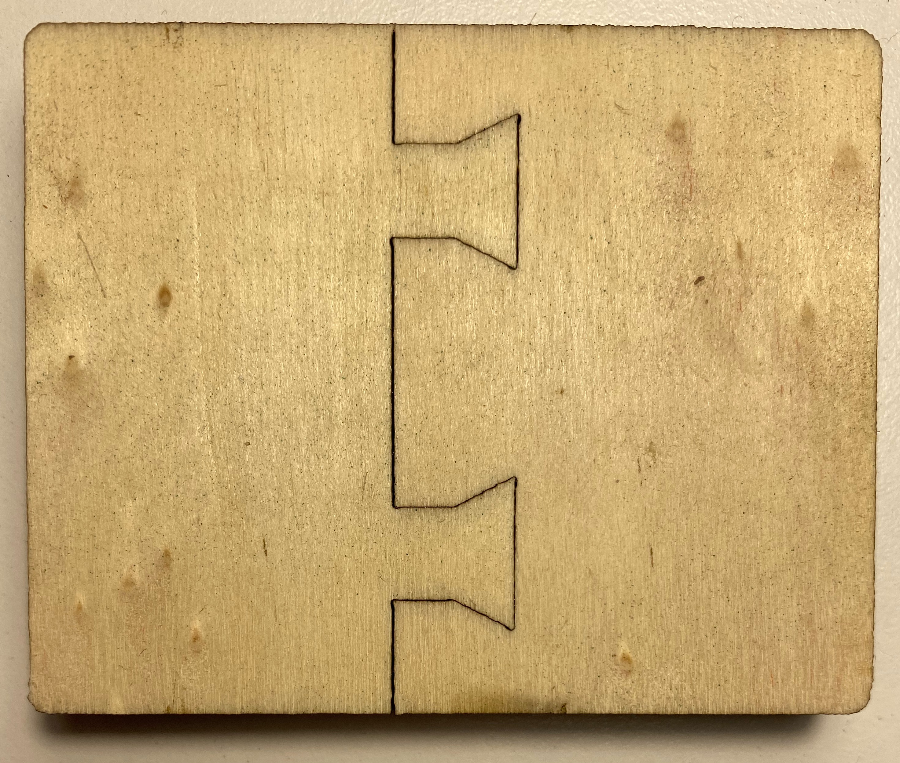

Simple little file I created to test the proper kerf offset on my machine. I each time I ran a new test I would engrave the offset onto the top. Now I have it handy for when I need to look back and reference it!

Nice. Once you get your different kerf settings dialed, you can add them to your ‘Materials Library’ for quick reference and application to the desired layer(s). You can also add Project Notes (‘File’>-‘Show Notes’) and choose to have this info show when you open the file.

Just tried the kerf 0.175 test on our CO2 130W laser and it worked well:
Fits very well. On the reverse it’s so tight it’s practically perfect:
I’m very happy with this.
