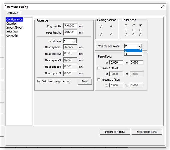

You need to use the Pen Up/Down option and set the target layer height in absolute coordinates.
With these settings, the bed moves down from my focal distance (21.5mm) to 24.5mm and the laser dot gets out of focus by 3mm. After the operation it moves up to 21.5mm.
Here is how I set it up
change the map for pen axis to Z in the parameter settings:
enable pen up and down in the advanced settings for the layer
Now I need the Lightburn team to do the same in their software :sweat_smile:

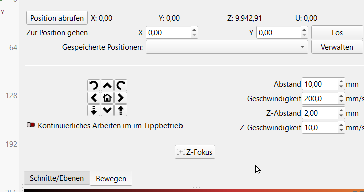

I think there is definately a bug in Lightburn. The software does not even read the right coordinates from the controller on the Z axis. X and Y is right, but Z is not.
RDWorks does read it right, but Lightburn reads Z completely weird… At the time of this screenshot, the Z axis was at my focal distance of 21.5mm
The 9.942,91 mm value for the Z axis indicates it wasn’t homed using the Focus button on the controller display. The default Z axis value before homing / focusing is 10.000,00 mm, so the platform is now 57,09 mm higher than it was when the controller turned on.

Thank you, but I did home Z by using the autofocus. My Monport has one of those laserheads with a spring loaded tube and a limit switch at the backside. So there is no need to take care about a protruding pen style switch.
And it does not matter if I home Z with the button on the controller or in the software. Lightburn does not read Z correctly.

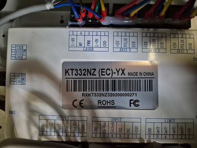

What does the sticker on the controller have on it? Is it like this?
I encountered very similar situation earlier this year with somebody else who had a Monport 60 watt which had a ‘KT332NZ’ labelled controller and the Z axis behaved differently, and was not mapped to U axis.
Unfortunately the KT332NZ identified itself to LightBurn with the same ID as the KT332N, so automatically is treated the same way.
I know @ednisley has the ordinary ‘KT332N’.
I’ve responded to your support email, once we have some debug info of the connection with the device I can pass that on to the dev team.
Thanks Nicolas,
you are right. My Monport 90W also has this type of controller

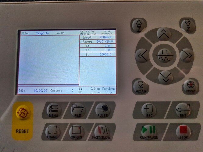

After turning on the machine and auto homing X and Y the display shows this

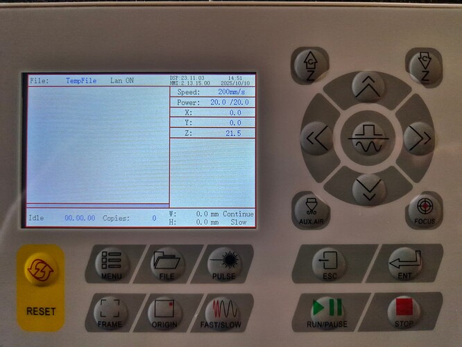

After homing Z with autofocus it show this
But Lightburn still shows Z at 10000 and U at 0
