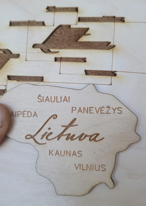

It draws the lines lines while laser head is moving between different parts of the job (both cutting and engraving) also during engraving it engraves everything. Both issues you can see at the picture. An half moth ago I have replaced laser PSU and everything look fine until I begun to engrave (instead of cutting). It was something like short circuit sound and everything repeated again…

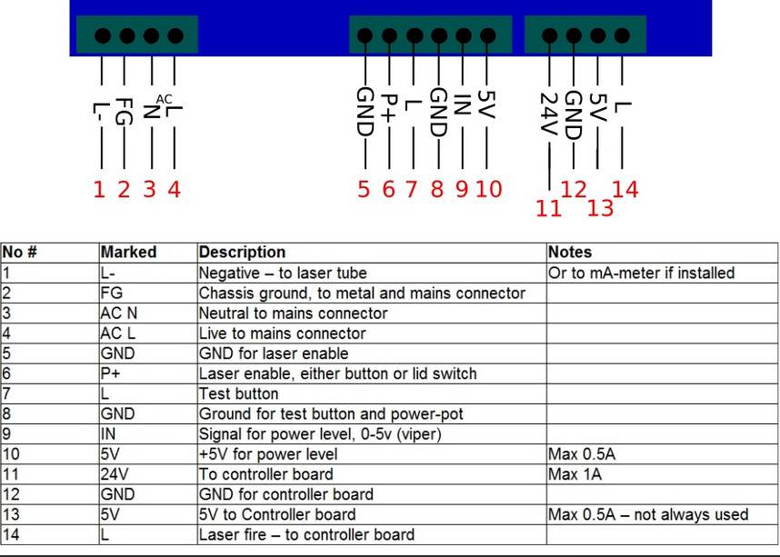

Unfortunately I am failing to find H terminal of the laser power supply, I am not sure if it even exists in my laser PSU…
My PSU has this pin layout:
BTW, I have tried to swich L-ON output from terminal #7 to terminal #14. Results were completely the same…
Does “Terminal H” even exists in my PSU?

I assumed from this:

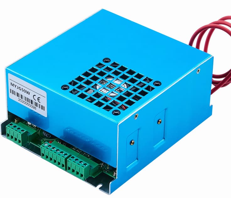

That the power supply was similar to this:
The power supply you show seems more like one found in a K40-style laser.
Is it identical to the original supply?
In particular, does it have the same connectors?
@ednisley They both looks like this:
Identical PSU from OMtech website:
Both original and repacement PSUs have the same looking and the same pin layout. I bought it on prupose to make cable replacement as easy as possible to avoid any wiring errors.
Always a good plan!
However, pretty much all the advice you’ve received from everybody was based on an incorrect assumption about what sort of power supply was in the laser.
With that in mind, if you unplugged the old supply, plugged in the new (identical!) supply without making any wiring changes, and the machine did not work correctly, then IMO you got a dud power supply.

You problem is you have a crap lps, it’s for a k40 type, not something with a real controller. Pitch that lps and replace it with one like @ednisley posted.
You’ve picked the lowest cost replacement lps and now you’re looking at a >$500 fix… get a grip.
Put the right lps in the machine.

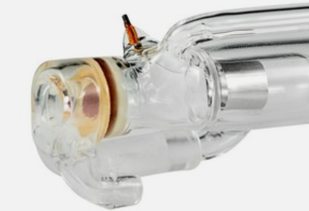

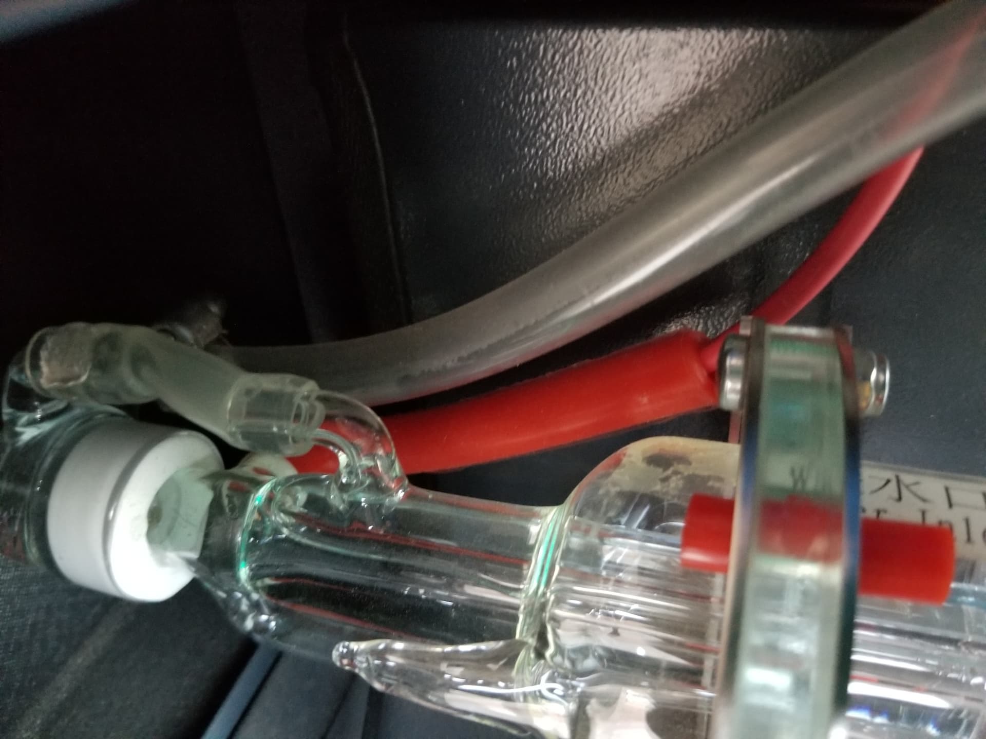

Also my lamp has dumb laser connector:
While your offered lasers have normal connectors:

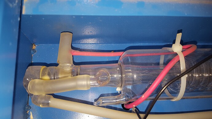

Where did you get a tube like this? Although I’ve seen them, I’m on my third and have never had to actually solder to a metal post on the anode. This also needs to be insulated as there is exposed HB on the anode.
The orange wire that has a cover is the anode on mine.
You have to do it quick as the heat could cause a problem with nearby glass. The other option is a mechanical connection.
I just by HV connectors from Amazon and attache them with the internal screw. Be aware there is a couple sizes of HV wire. The wire needs to be snug in the connector so there isn’t a way for the HV to reach out and touch you.
Actually I don’t even solder them. The original tube had wires spinned around those terminals and some isolating material around it, something like here:
However I can’t identify the original material. So I am spining wires around terminals and isolating it with a car gasket sealant.
