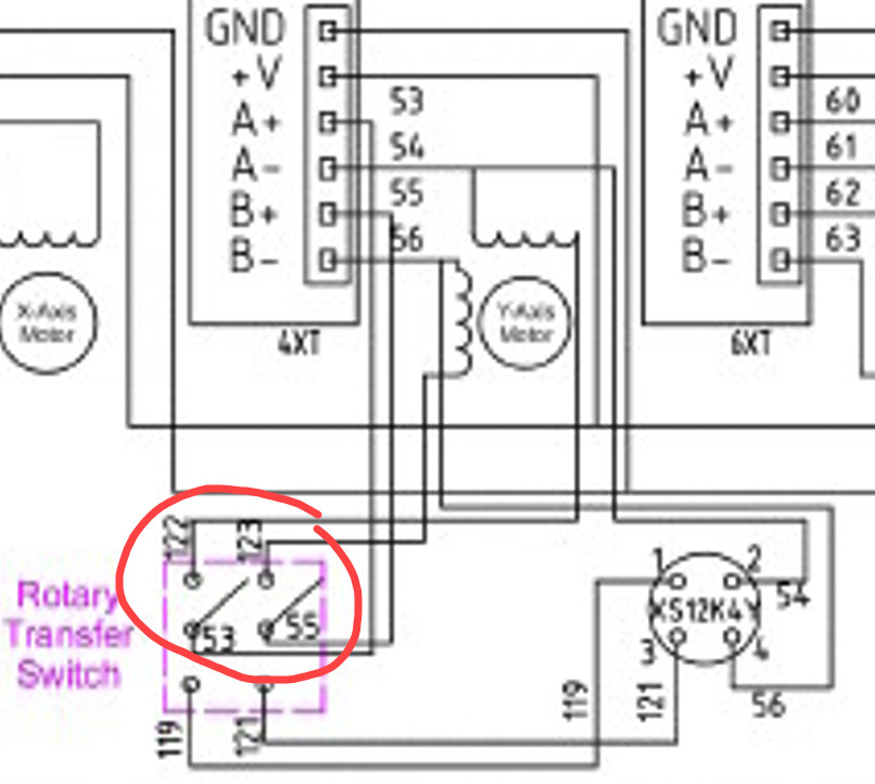

One small thing I noticed and don’t particularly like about the Y-axis wiring is that of the two phases that drive that stepper motor, one leg of each phase has to pass through the contacts of that little rotary switch:
At best, that drops a little voltage as heat into the contacts. At worst, especially if the switch is rarely physically used - the contacts could slowly become more oxidised and eventually (with machine vibration helping) momentarily open, which would show as an intermittent position error.
So if you’ve tried everything else and keep getting Y-axis issues in the future, working this switch back and forth a few times, or temporarily bypassing it, might be worth a try.

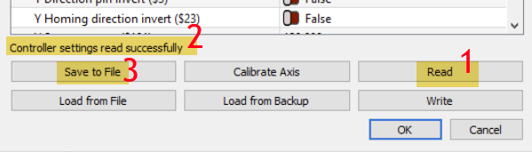

For anyone else reading this, I strongly recommend you download a copy of the firmware settings from your controller before making any changes.
With the machine connected and in an idle/ready state, go to Laser Tools>Machine Settings
Look for the Controller settings read successfully message (if you encounter any problems check the connection and try using ‘Read’ again).
Click Save to File and name the file something like RuidaSettings_Original.lbset and keep it somewhere safe.
It’s good practice after writing changes to hit ‘Read’ to confirm they were written correctly, and then ‘Save to File’ again a dated copy e.g. RuidaSettings_21July26.lbset
Ah, but LightBurn saved an automatic backup, so after you follow @NicholasL’s advice to save a named copy of the current settings, you can restore a backup from before all this started and see exactly what settings arrived from the seller.
