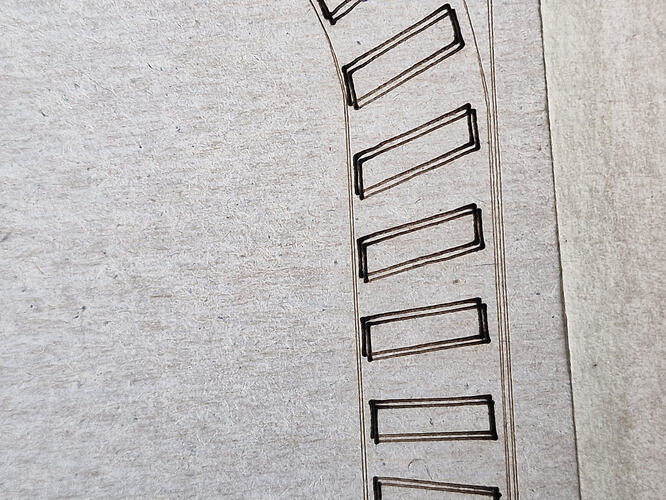

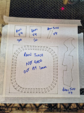

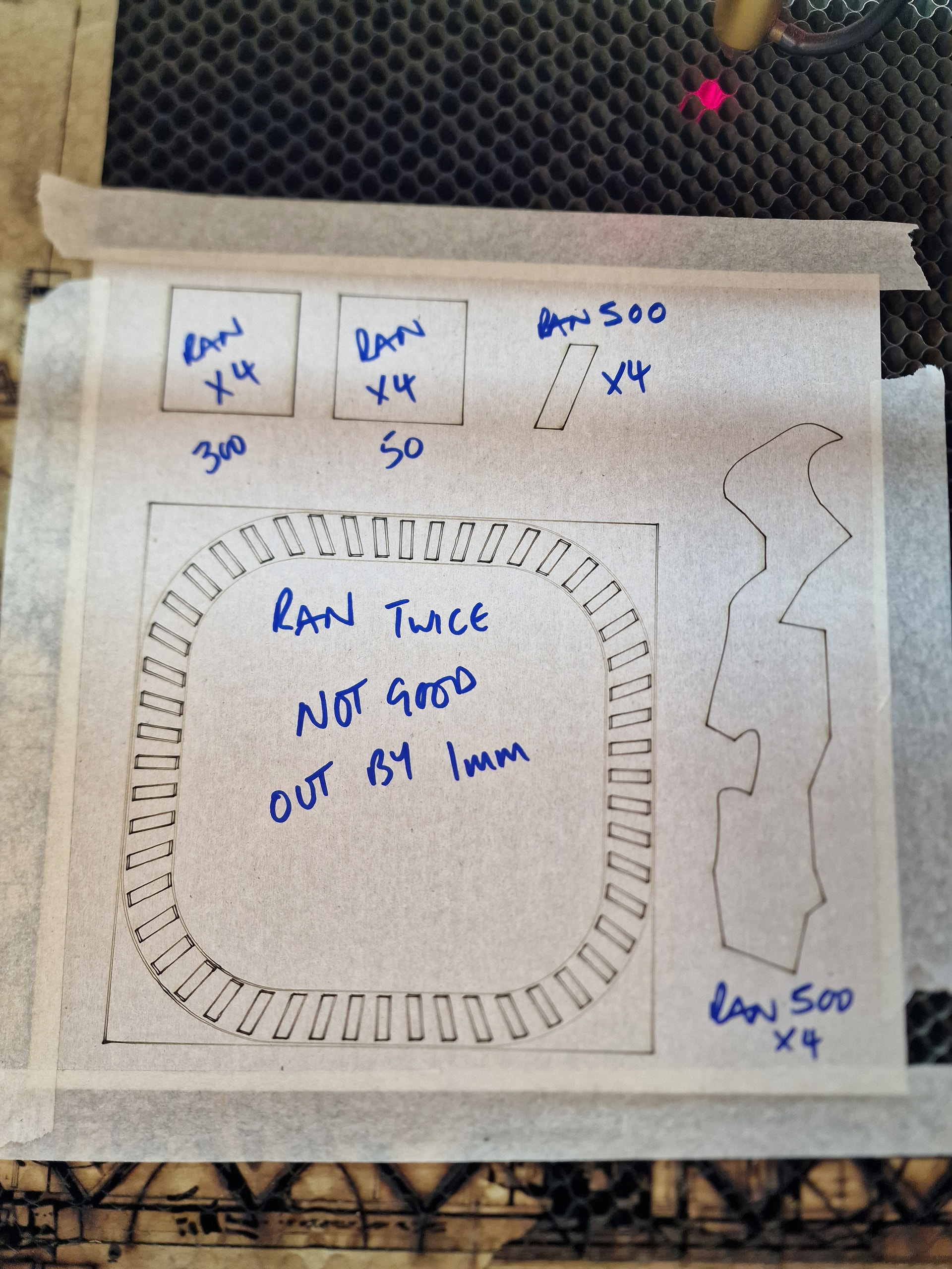

Done as requested. Rapid test fails but other shapes pass. I repeated the rapid 1 more time but the others I ran 4 times.

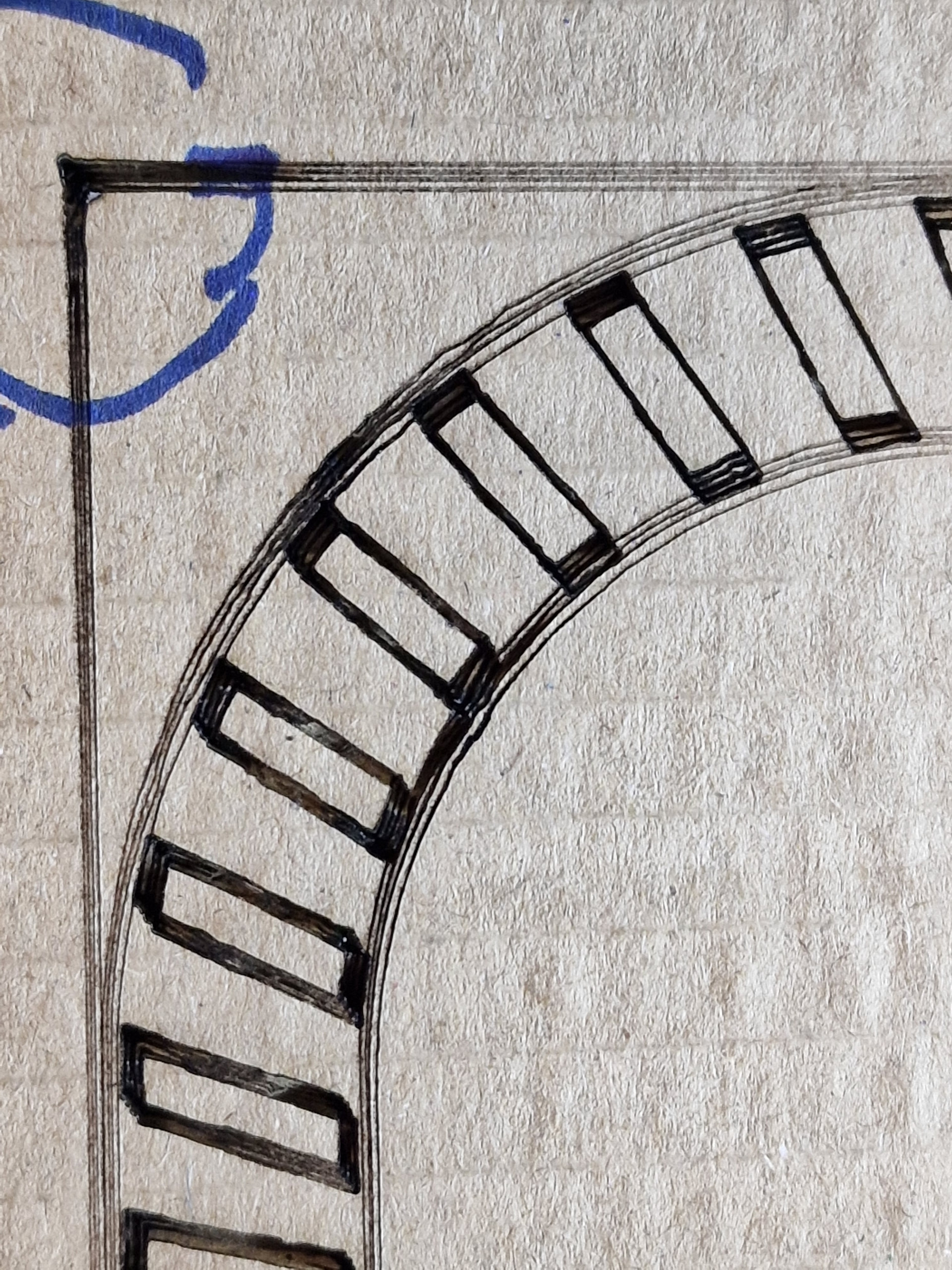

All out by 1mm
On the upside, you now have a less complex test case.
With a new sheet of cardboard taped down, run that test pattern four times to see if the displacement increases with each pass, levels off, or retreats.
If you can mark the corner of a rectangle with each pass to identify what happened, without moving the cardboard, that will help track the errors.

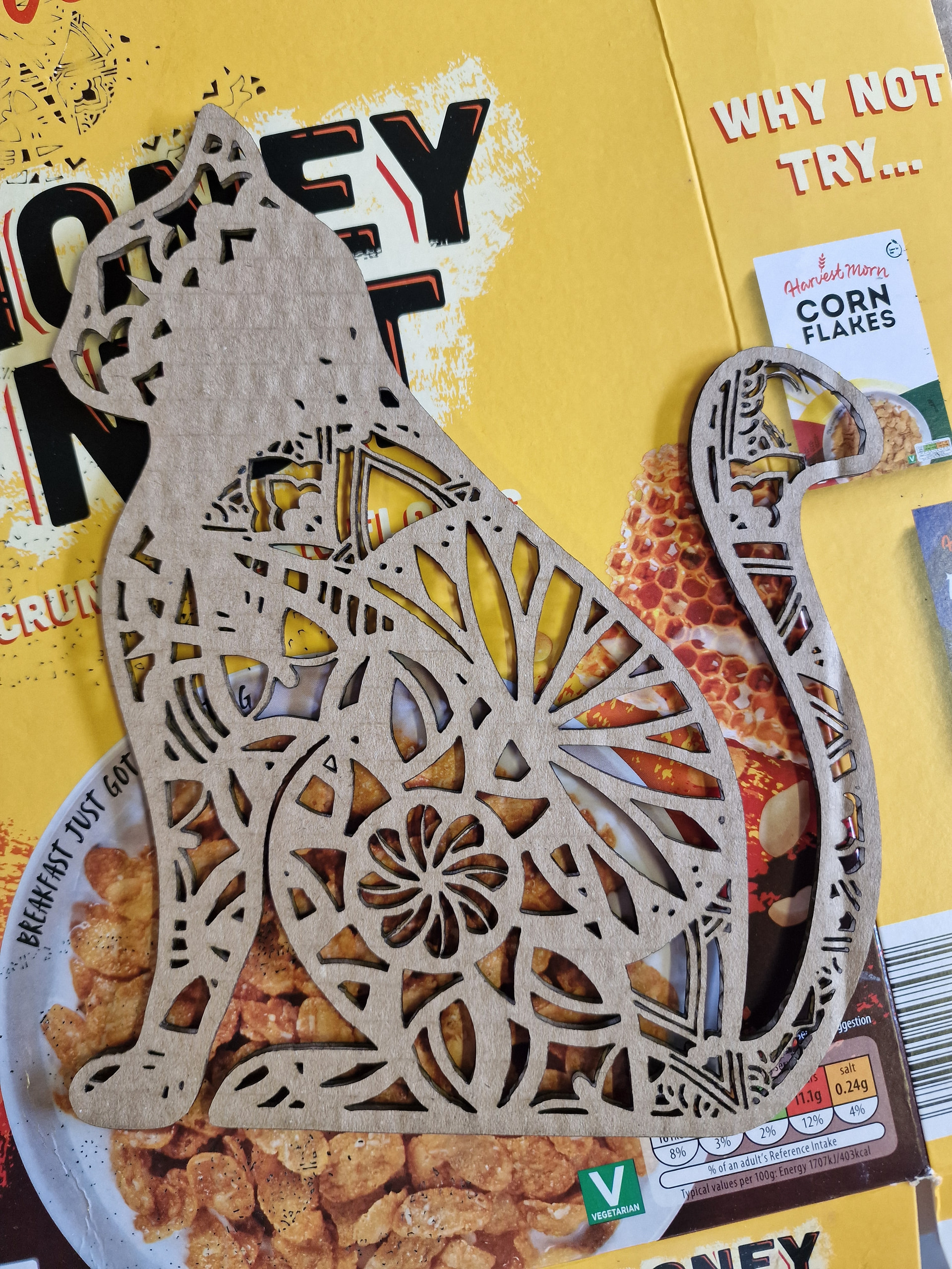

As a thought are the issues with repeat cuts being slightly off related to the inner parts of the cat issue? I.e the same issue in disguise :disguised_face:
It’s curious as the repeated cuts show a consistent error with little added variance, e.g 1mm out, then 1.2mm out then 1.4mm out etc.

One thing that appears to be obvious so far is that all issues discussed are repeatable which indicates no randomness. Also as shown in the cat cuts earlier the start and end origin were about 4mm out in both axis which may point to a shared component failure.

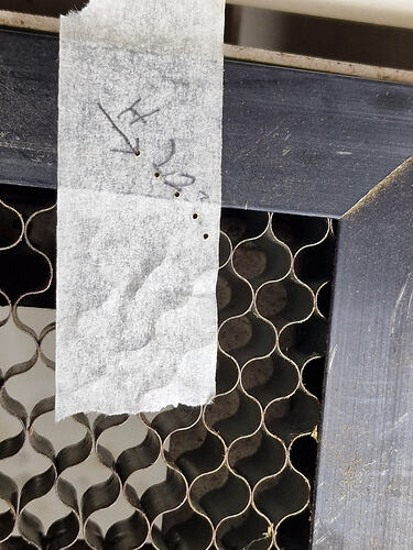

  • Tape a piece of paper under the machine’s Home position.
The test:
  • Turn the machine on or reset the controller so it goes through the usual homing sequence
  • At the controller, use Pulse to put a pinhole in the paper at the Home position. Mark that spot so you can find it later.
  • Run the cat pattern to get a significant error
Caution: if the error puts the laser head toward the Home corner, the head may smash into the side as it moves toward the origin point, so be ready to slap the Emergency Off button.
If it returns successfully:
  • Do not reset the controller or home the head
  • Pulse to mark where the head stopped. The controller now thinks the head is at the Home position, so the error is in the machinery.

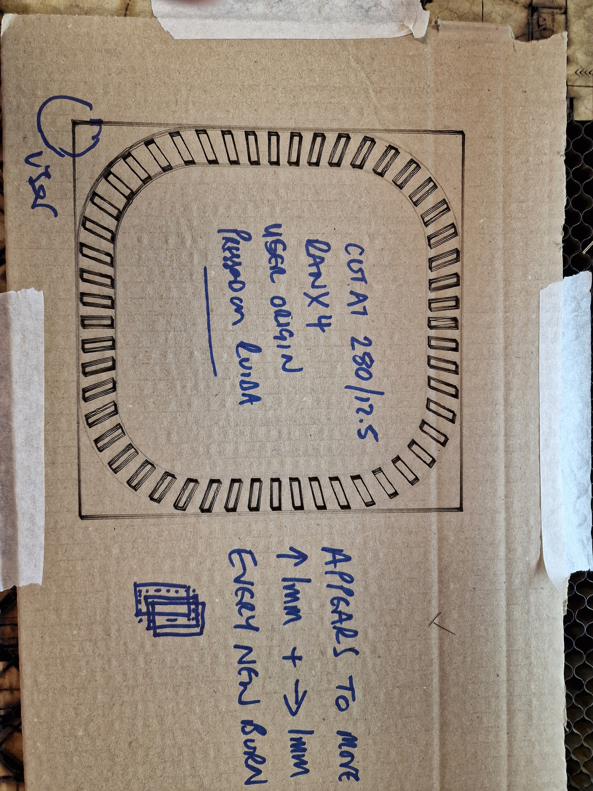

Test 1: user origin set on lightburn and laser.
Ran 4 times. On each pass the graphic appears to move up 1mm and to the right 1mm.

This is exactly what I expected as the movement in origin position matches other photos I’ve posted.
Homed machine. Pulsed. Ran cat then rotated.
Machine hit limiter trying to return home post burn. Escape. Head returned to Home. Did this 4 times but on the 4th there was physically no room for the head to finish where it thought Home was.
Result: from the homed origin the head returned to a position 3mm up and 3mm right. If we say Home is 0,0 then it would be -3,3 then -6,6 etc
These numbers are approximates or how I imagine it on a graph.
Thus confirming: the physical position does not match the controller’s coordinates.

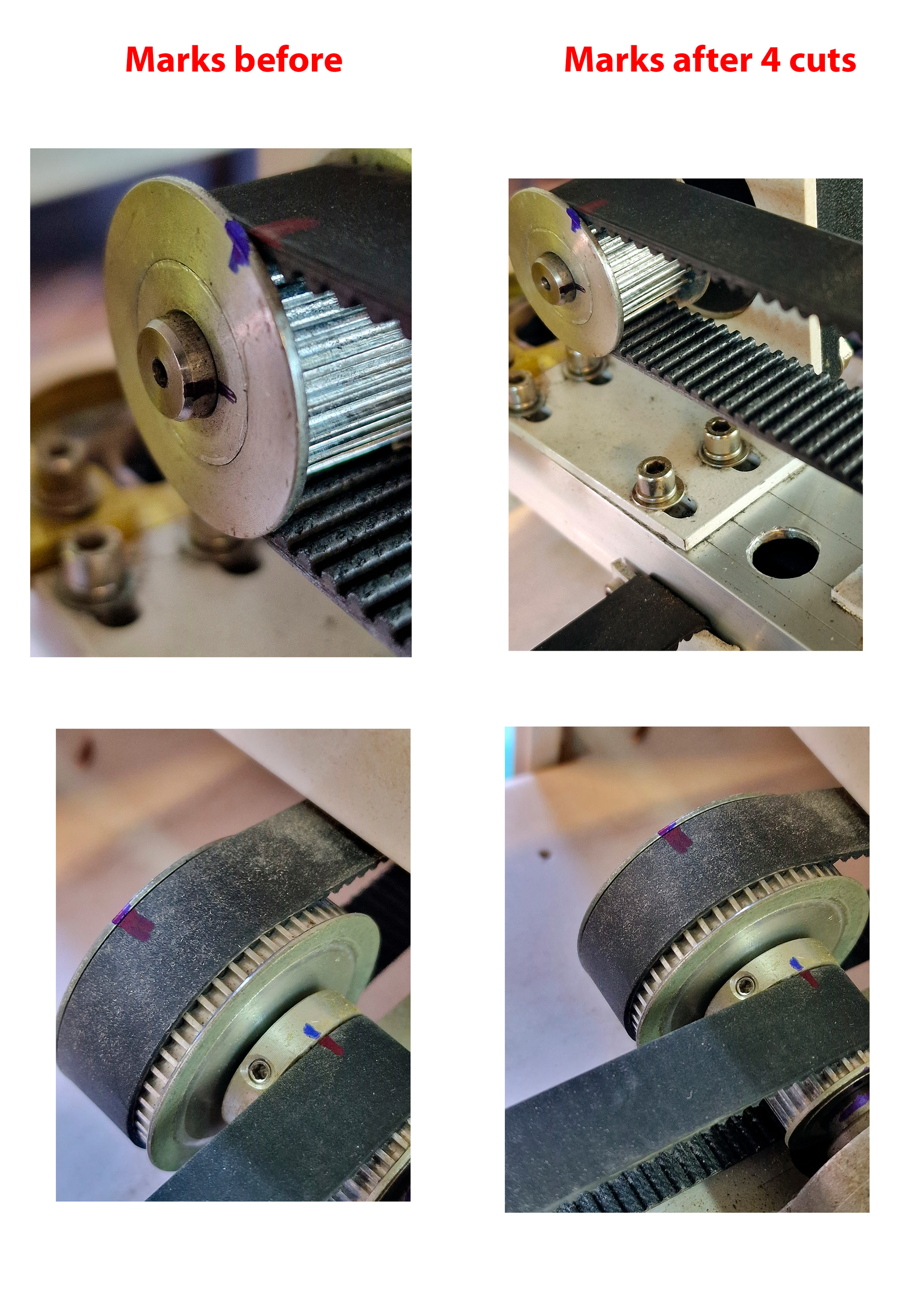

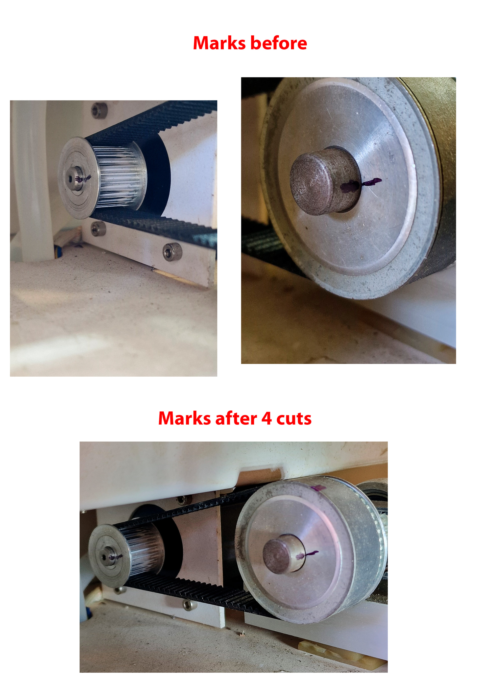

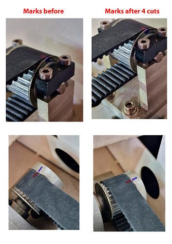

Mark both the X and Y motor shafts and pulleys to show if the pulleys shift relative to the shafts, as in the blue line:
Also mark the pulley and the belt to show if the belt shifts relative to the pulley, as in the red line. I understand the Y axis motor is hard to reach, but get a marker in there! :grin:

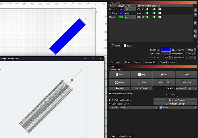

Very interesting and looks unusually consistent, if you use “Get position” at start and end of any user origin or current position job - do the coordinates change?

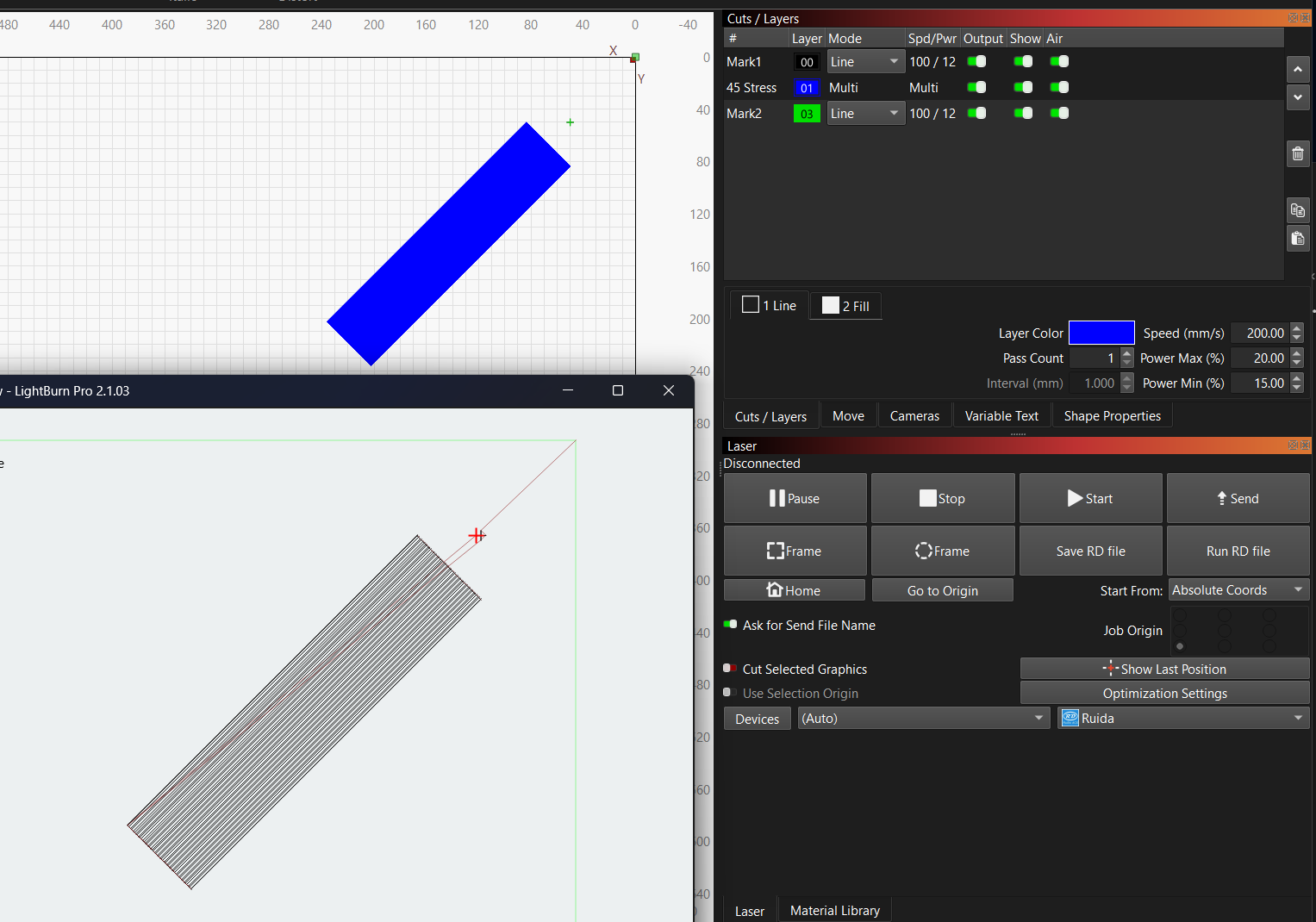

45 drift test.lbrn2 (6.7 KB)

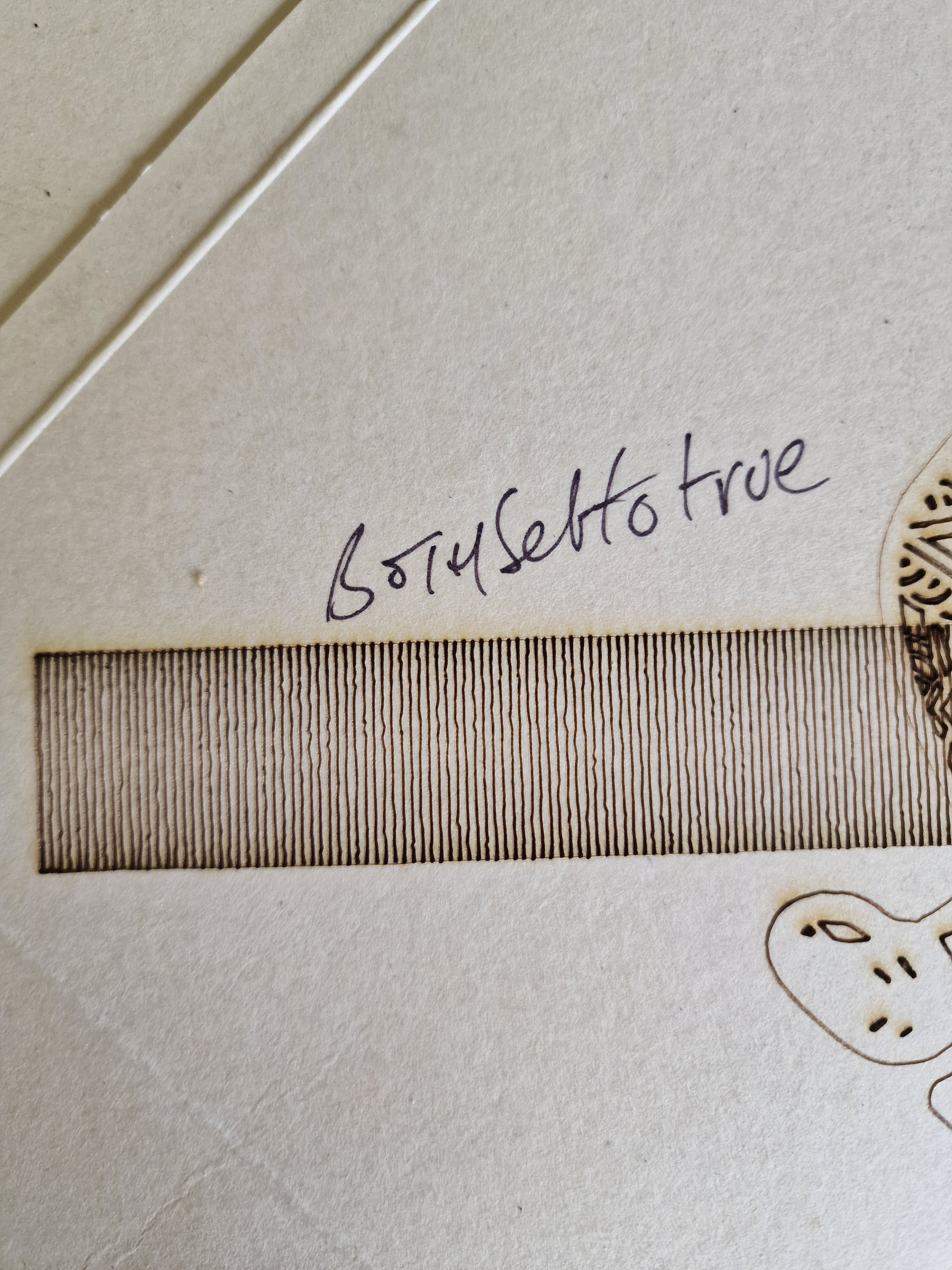

Here attached is a simpler (improved) drift test that should be interesting, it gives an even amount of work to each axis and it should be much easier to observe any drift (and accumulating drift) in the output.
45 drift test.lbrn2 (can be used in any position mode, change power % as needed but best to keep the diagonal fill lines at 400mm/s)
-burns start positon “mark1”
-burns rectangle outline
-fills rectangle lengthways at 45deg angle, and 1mm step (do the fill lines start creeping over the rectangle outline at the ends?)
-burns end position “mark2” (is it exactly over mark1?)

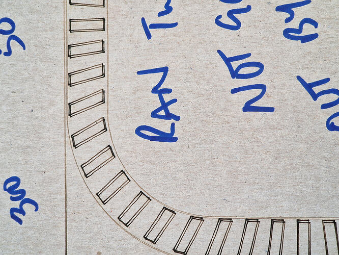

ok I have completed this test.
I homed machine. Marked belts and cogs as instructed. saved this location in Lightburn for later.

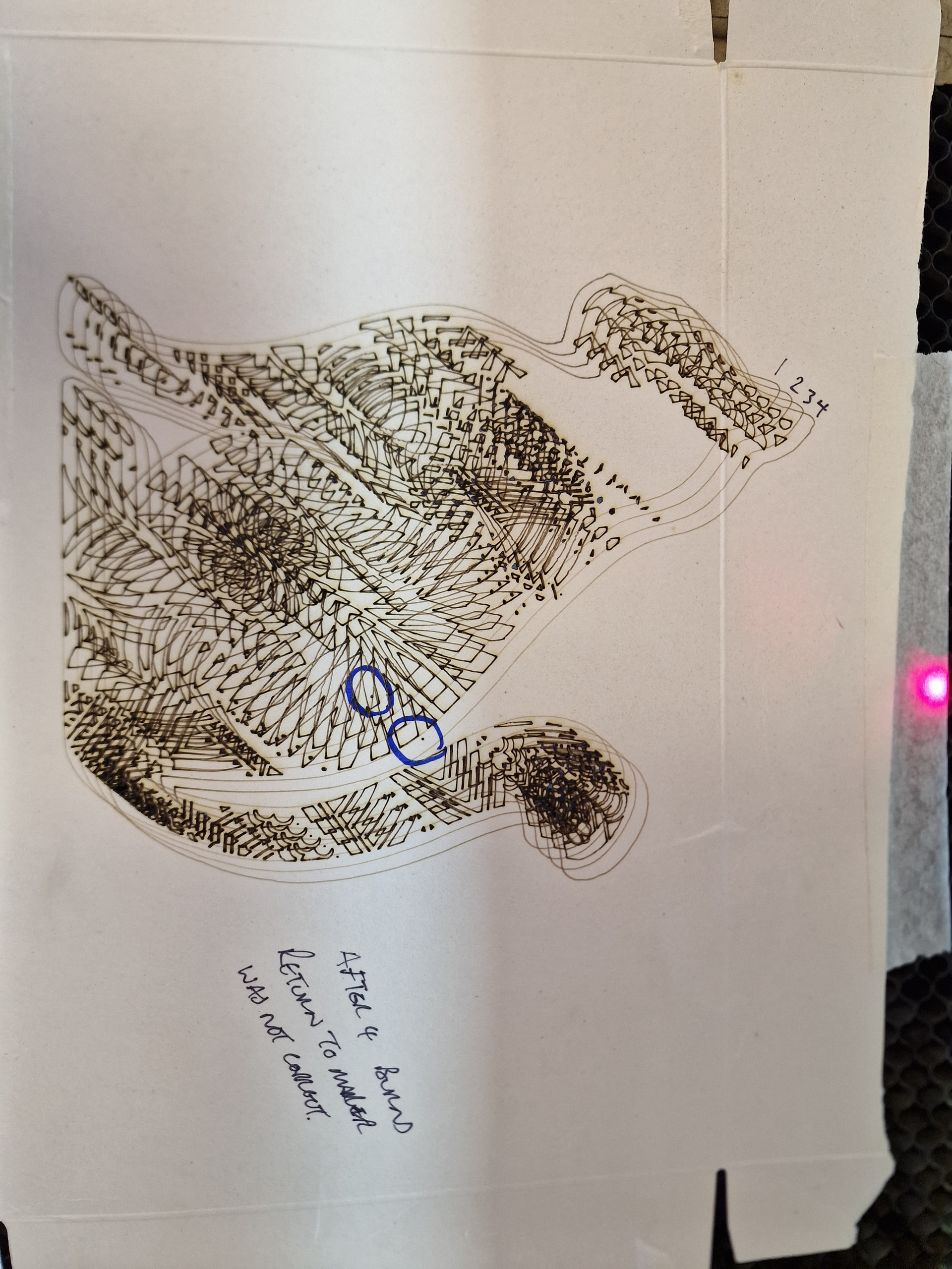

Used user origin as there is no difference in the errors between the 3 variants and put the origin as the return post burn selection. Ran the cat 4 times and it burned like before:
inner and outline shift per burn
3mm up and 3mm right shift per burn
I sent the head to the saved location to see how far out it was from pre-burn.
The 2 circles indicate the location of the head when I marked the belts before and post 4 burns.
At this stage the markers did not line up anywhere as a result.
I homed machine and sent the head to the saved position. I expected at least one of the markers to have moved but I don’t think any did move from their original position pre-burn.

  • The belts do not skip on the pulleys
  • The pulleys do not rotate on the motor shafts

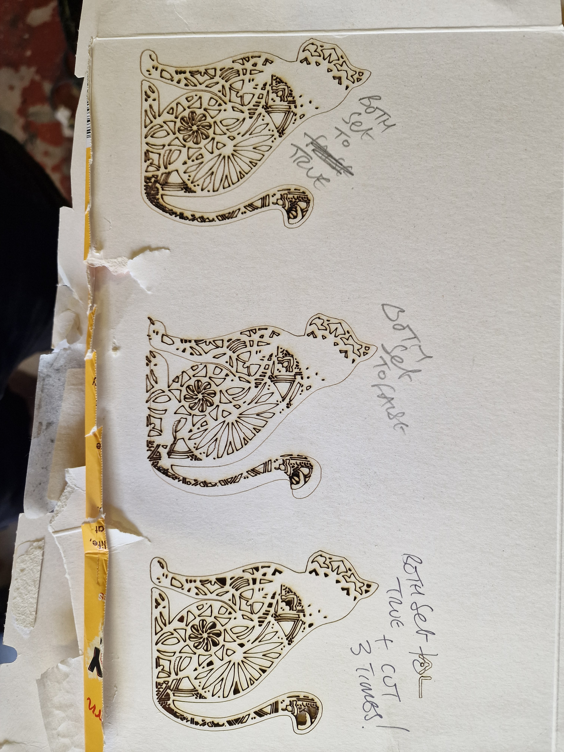

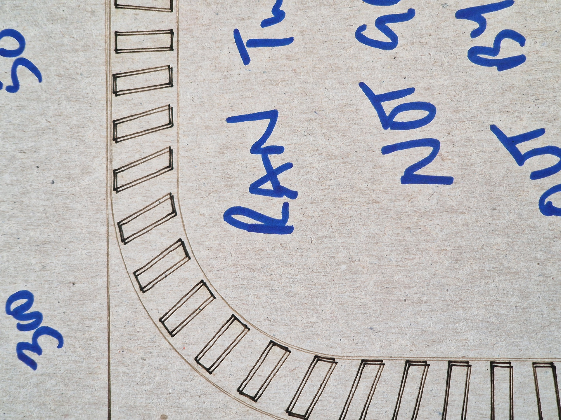

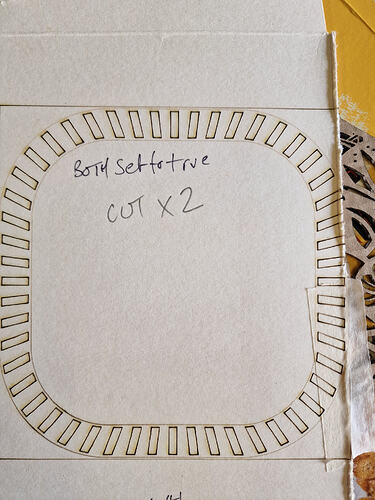

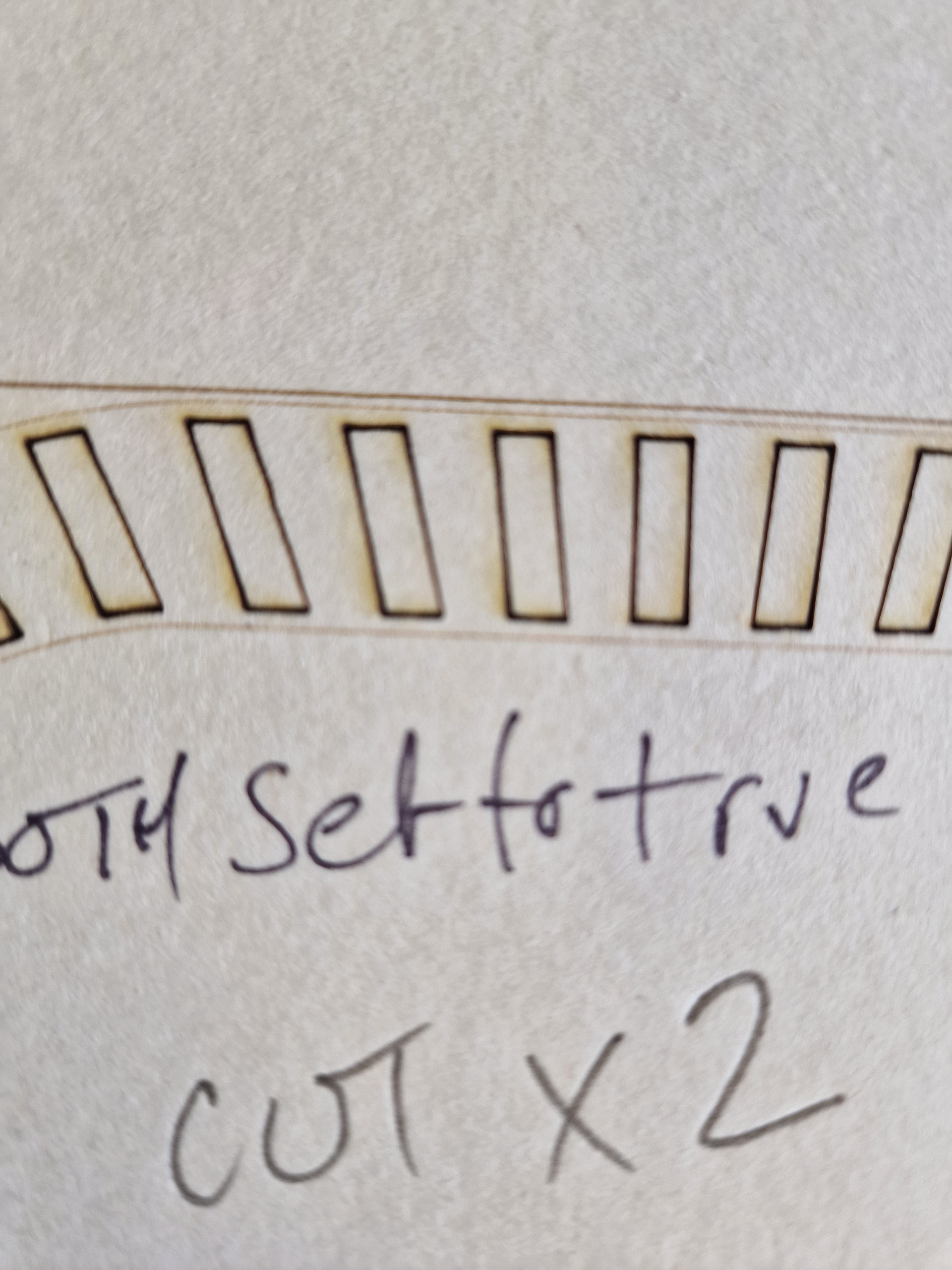

I have a feeling this change of the ‘PWM rising edge valid’ setting will be causing this very consistent offset, which is a different symptom than the first one you presented. I think they both should be set back to true for your machine otherwise you would have noticed a problem with this previously. Please try the ''45 drift test.lbrn2" before and after making changes to that setting.
ok i’ll go try it

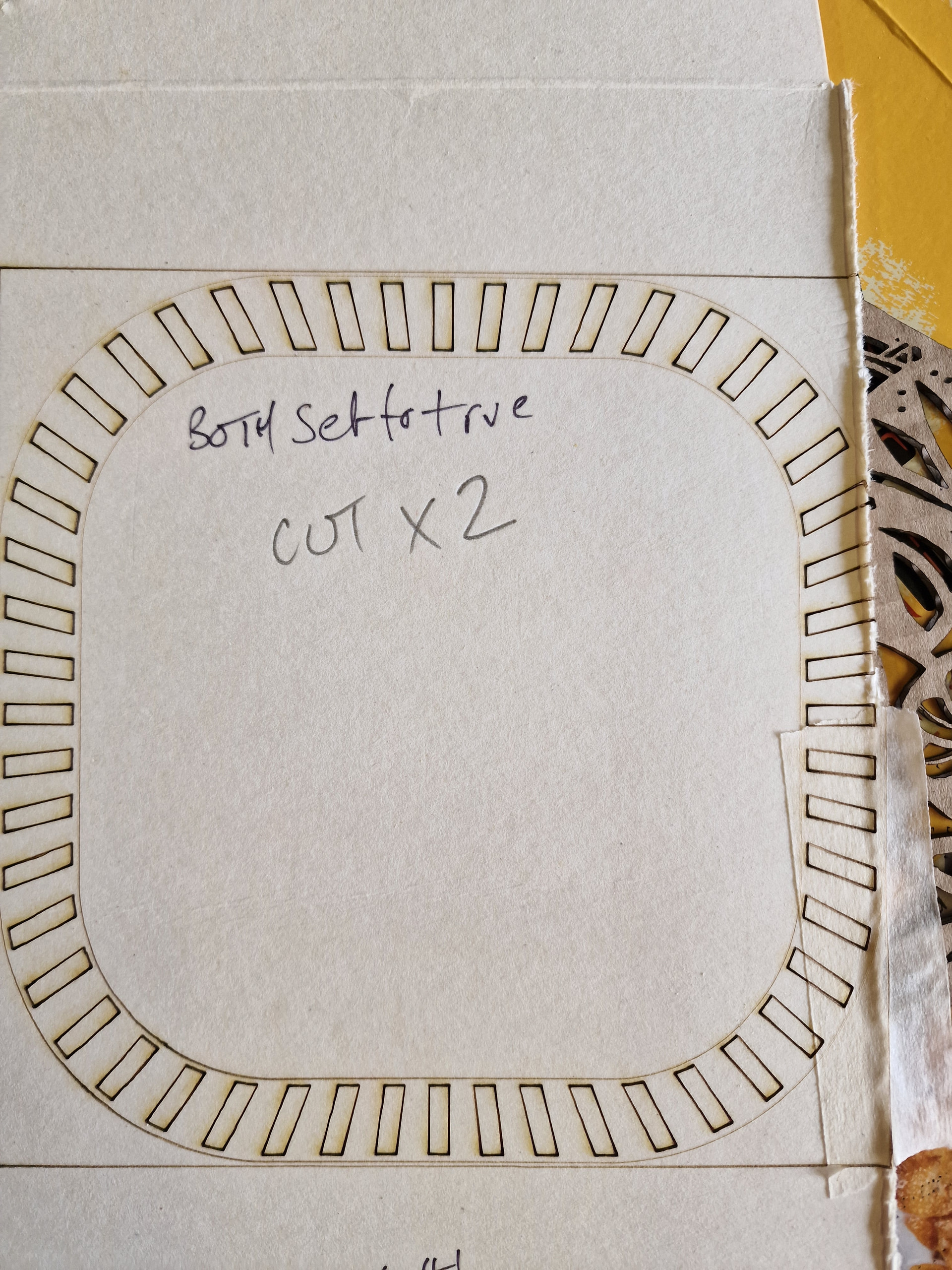

OK We are now winning! I think between us we have sorted this 3mm drift. I was also able to keep burning directly over the first burn. I’m going to complete the testing tomorrow but I think these photos speak for themselves.
Thank you BOTH so much!
That’s great it’s up and running. :tada:

P.S. I just updated the drift test file in my last post as I must have attached the wrong one originally (because the fill should be going lengthways parallel with the long edges of the rectangle).
