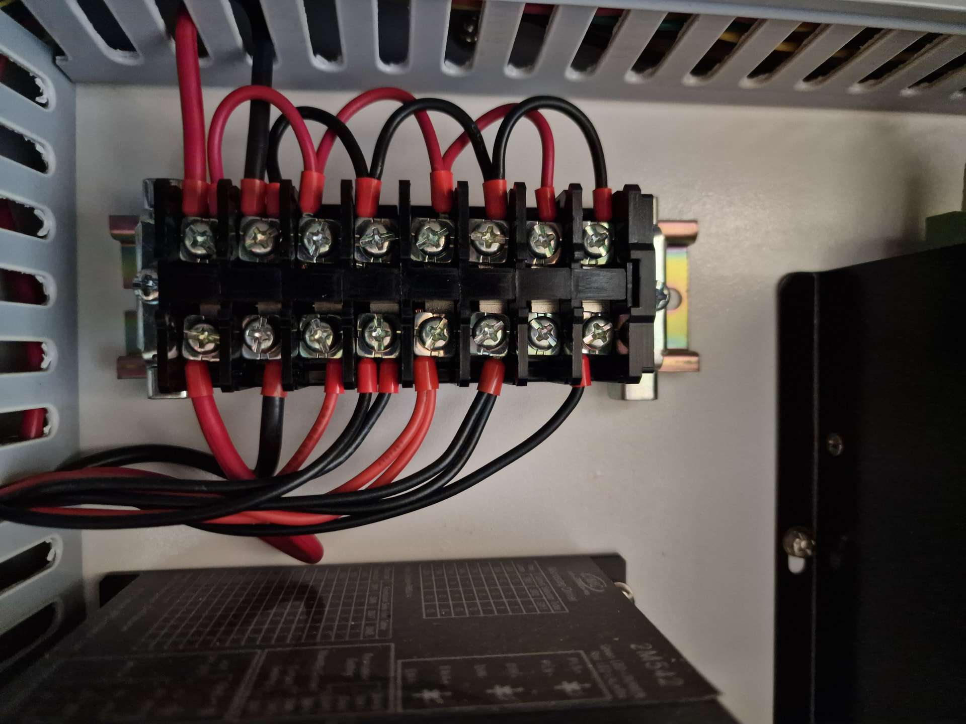

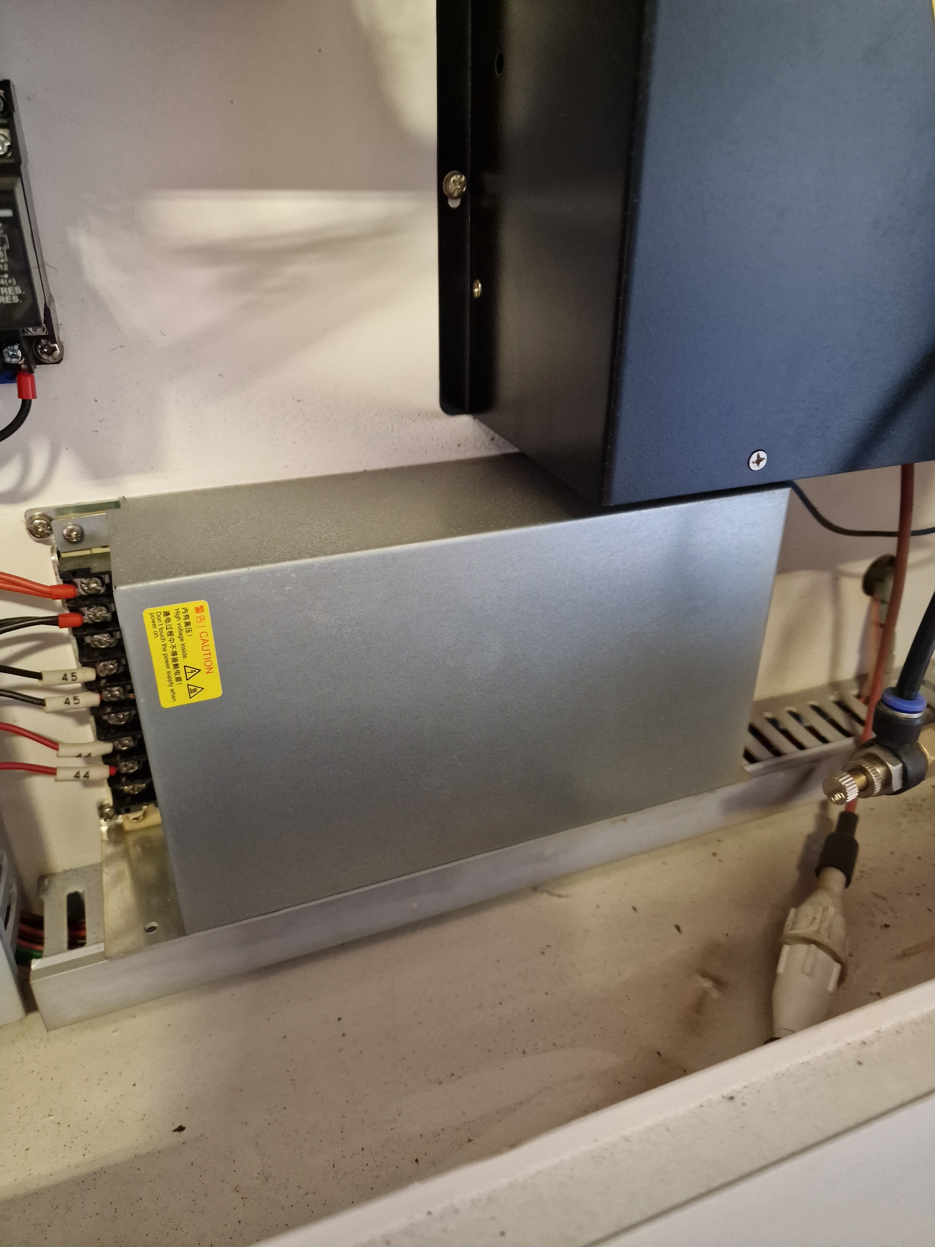

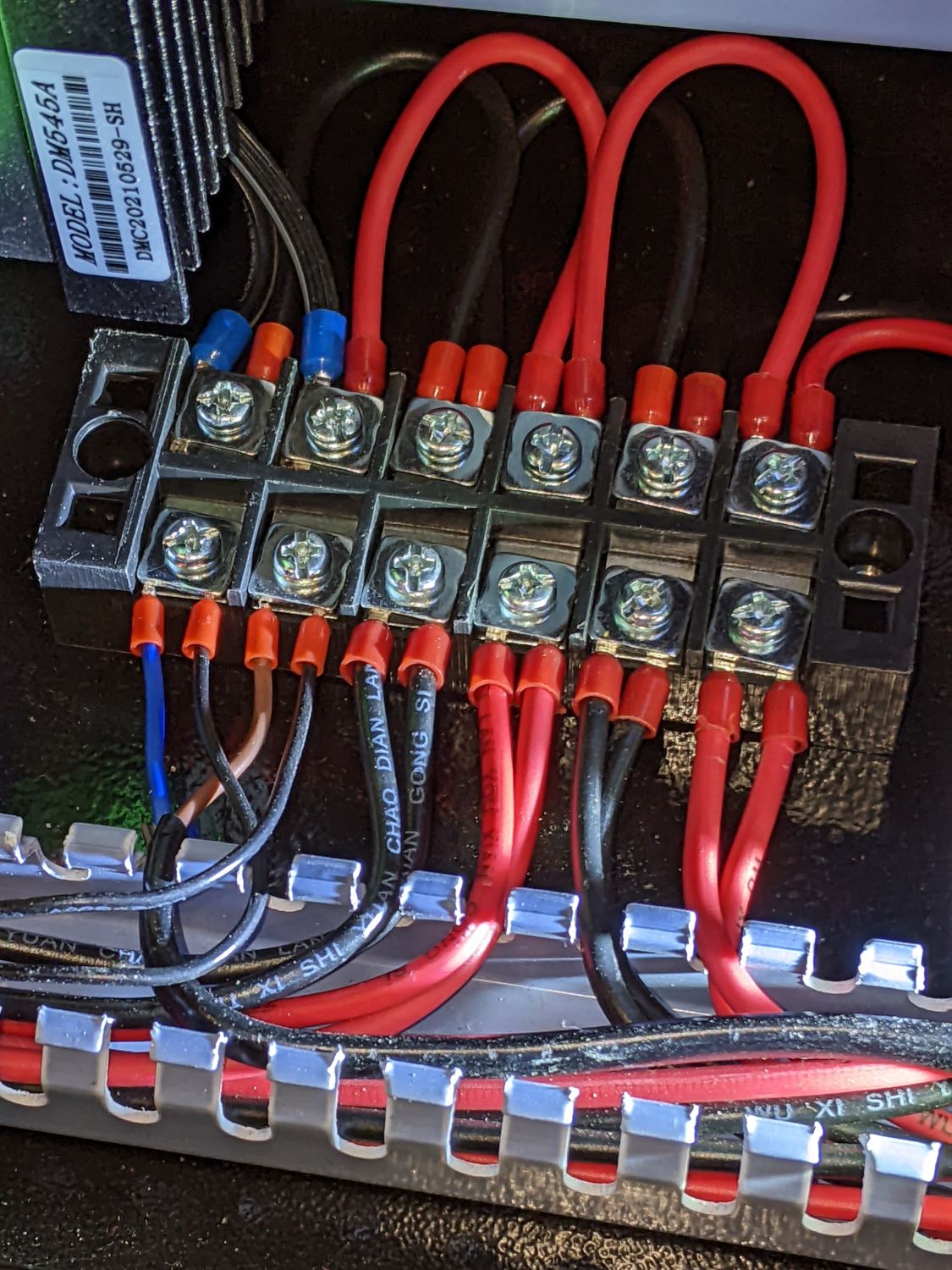

It’s not clear what the LEDs are connected to, but it’s possible a screw in the barrier strip distributing the wall-socket voltage (“220 V” is definitely not USA-ian) has come loose and the input power to the supply is glitching.
The one in my machine looks like this:
Plenty of opportunity for a loose screw / ferrule / crimp, although it would not be a common problem. :frowning:

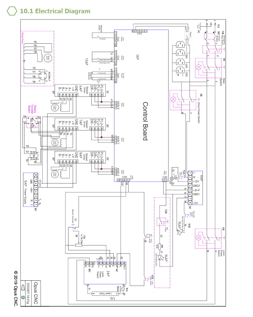

There appears to be 3 power supplies. Here is the electrical diagram from the manual.
A couple more to ponder.

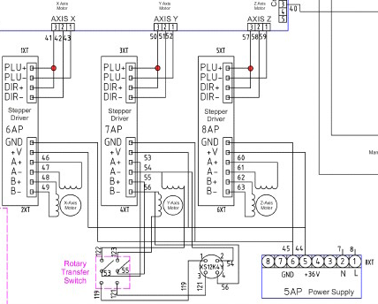

More new news: I lose the power supply bets. :grin:

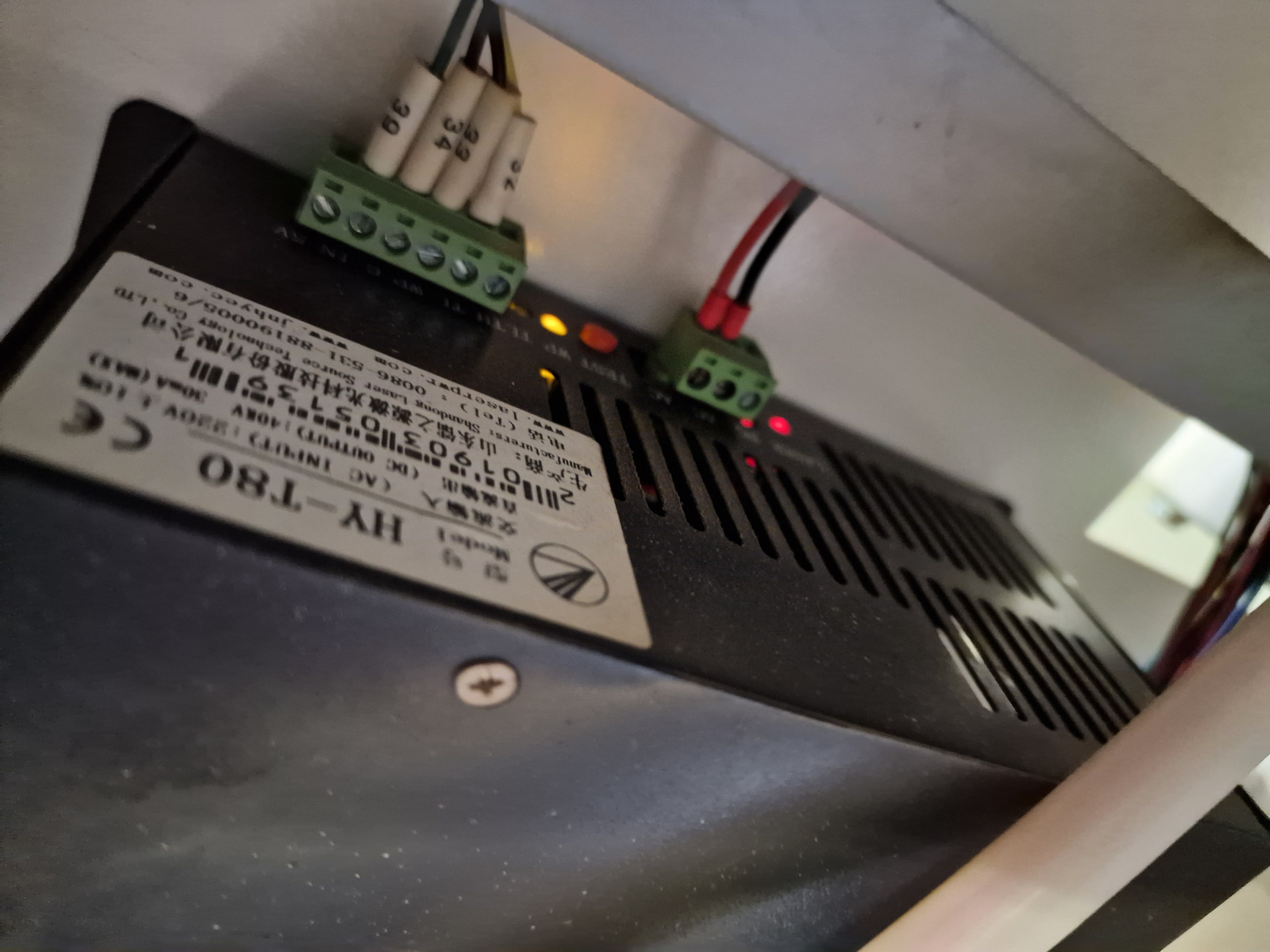

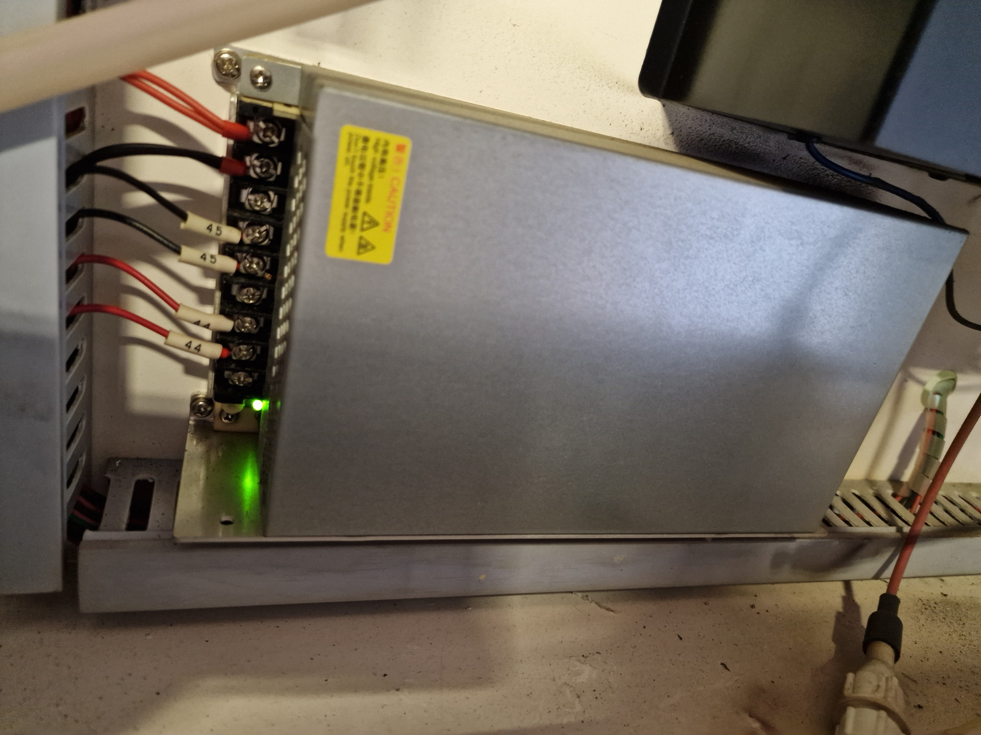

Apparently the “5AP” notation on the 36 V power supply apparently isn’t the “5 A peak” I expected. It seems to be a part identifier:

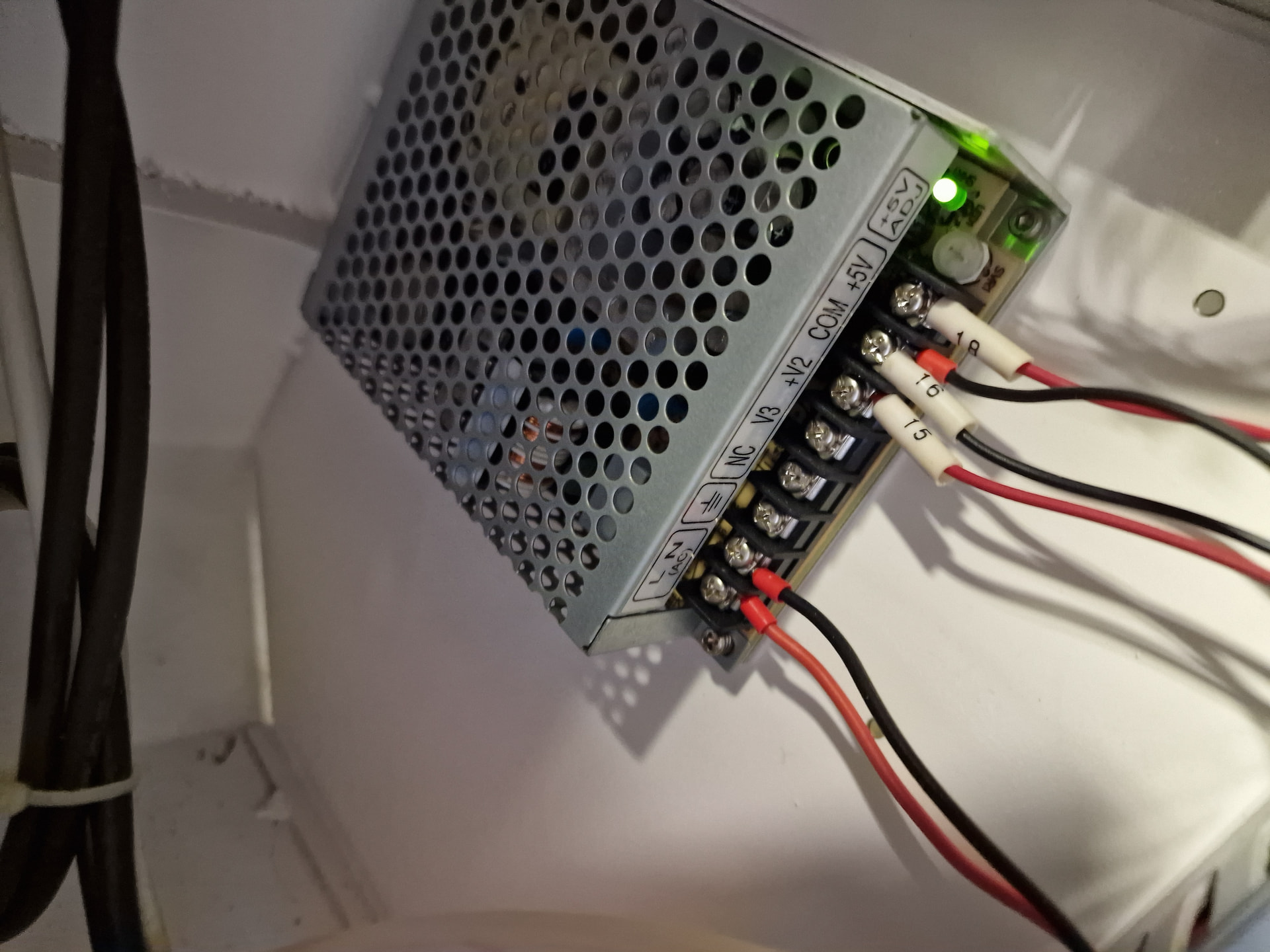

Find the sticker on that power supply with its ratings so we know what’s going on. If the sticker isn’t on the end with the terminal strip, then it’s on the bottom where you can’t see it. :screwdriver:
Assuming the input power distribution block (and all the wiring) passes inspection, that’s the supply to replace.

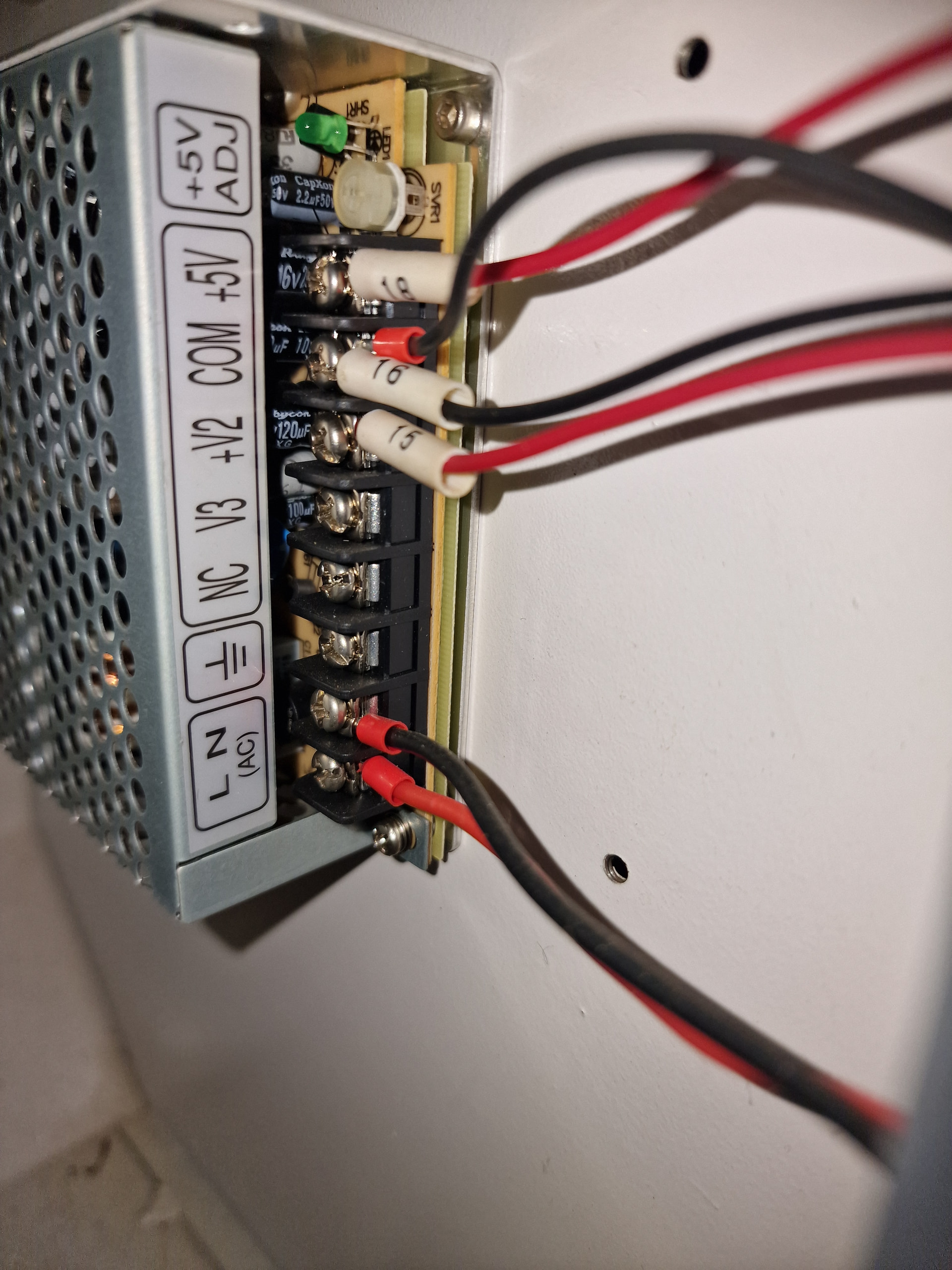

FWIW, having two low-voltage supplies (one with three outputs!) is exceedingly unusual. That’s far
more attention to detail than you’ll see in the current crop of imports.
Is that the:
Small, medium or black one?

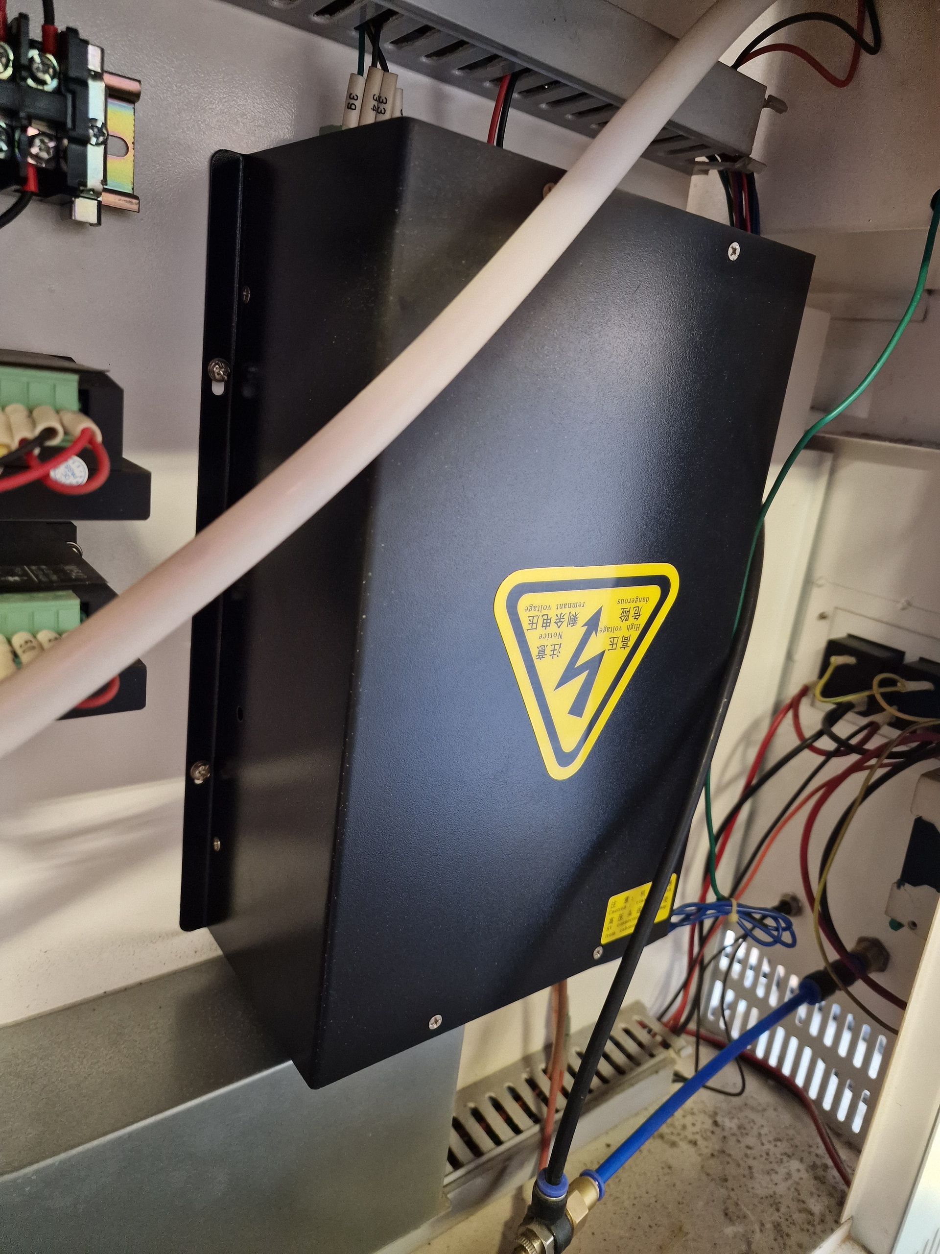

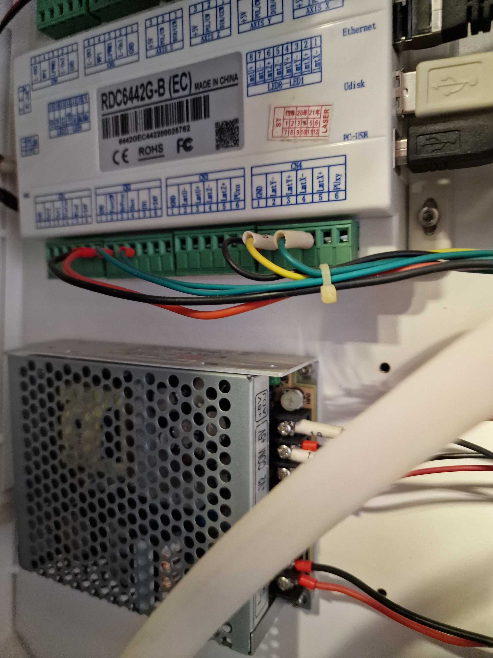

As I see them:
  • +5, +12, and maybe +24 = perforated silver case directly under the Ruida controller
  • +36 = solid silver (?) directly under the black HV supply
  • Extra-spicy HV laser supply = large black case with the fat red HV wire out the bottom

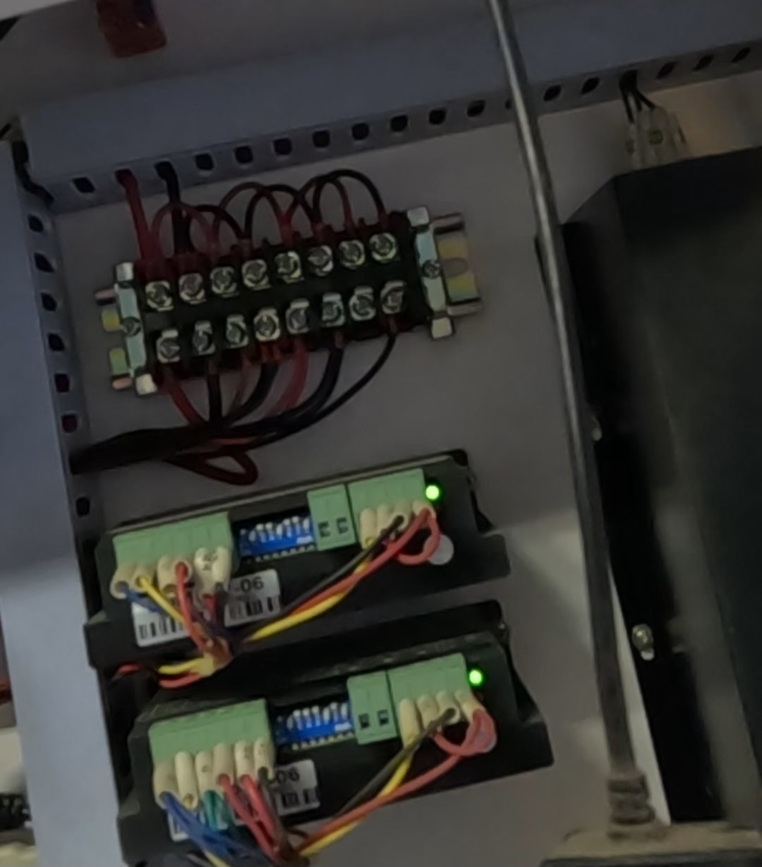

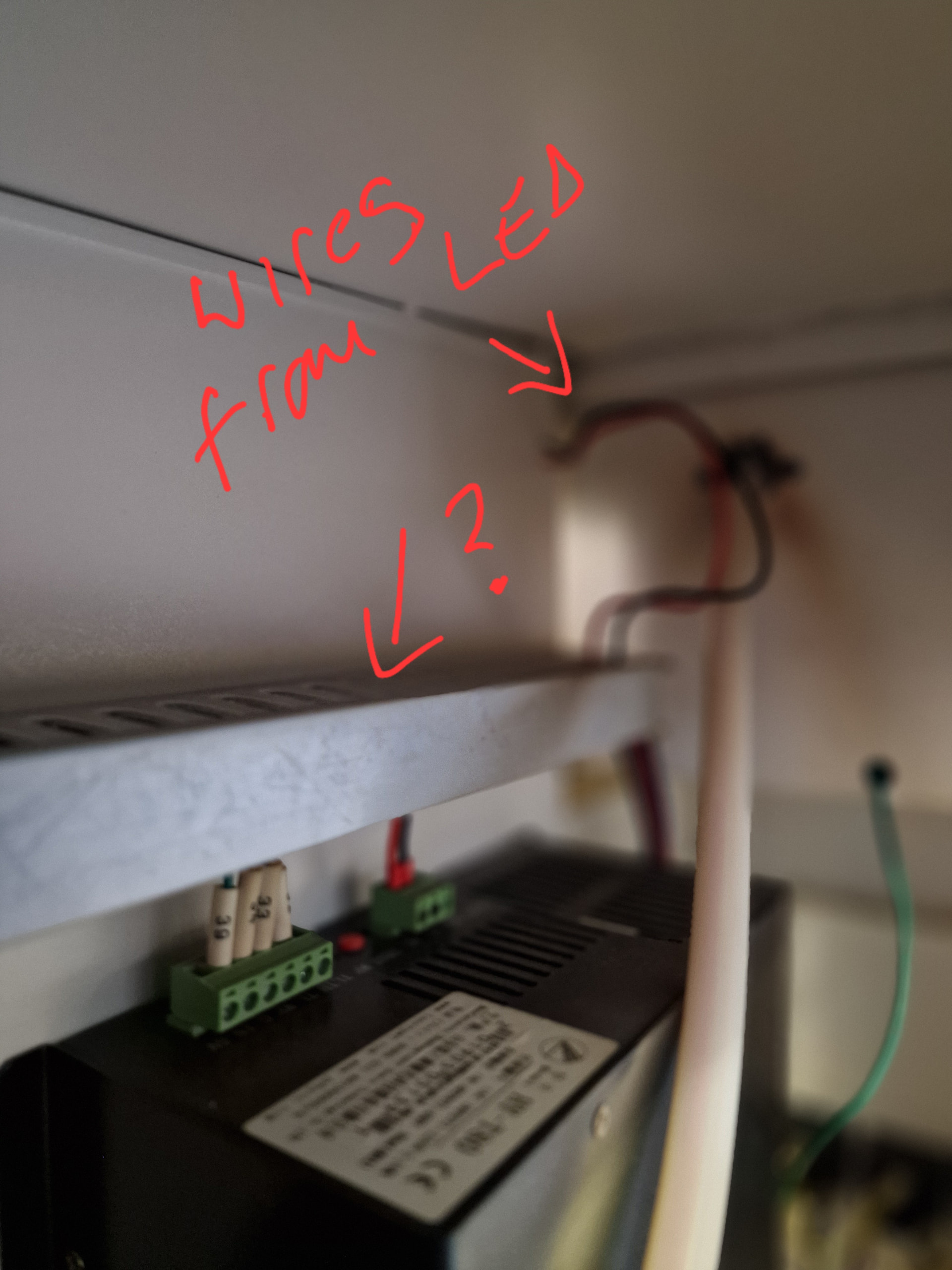

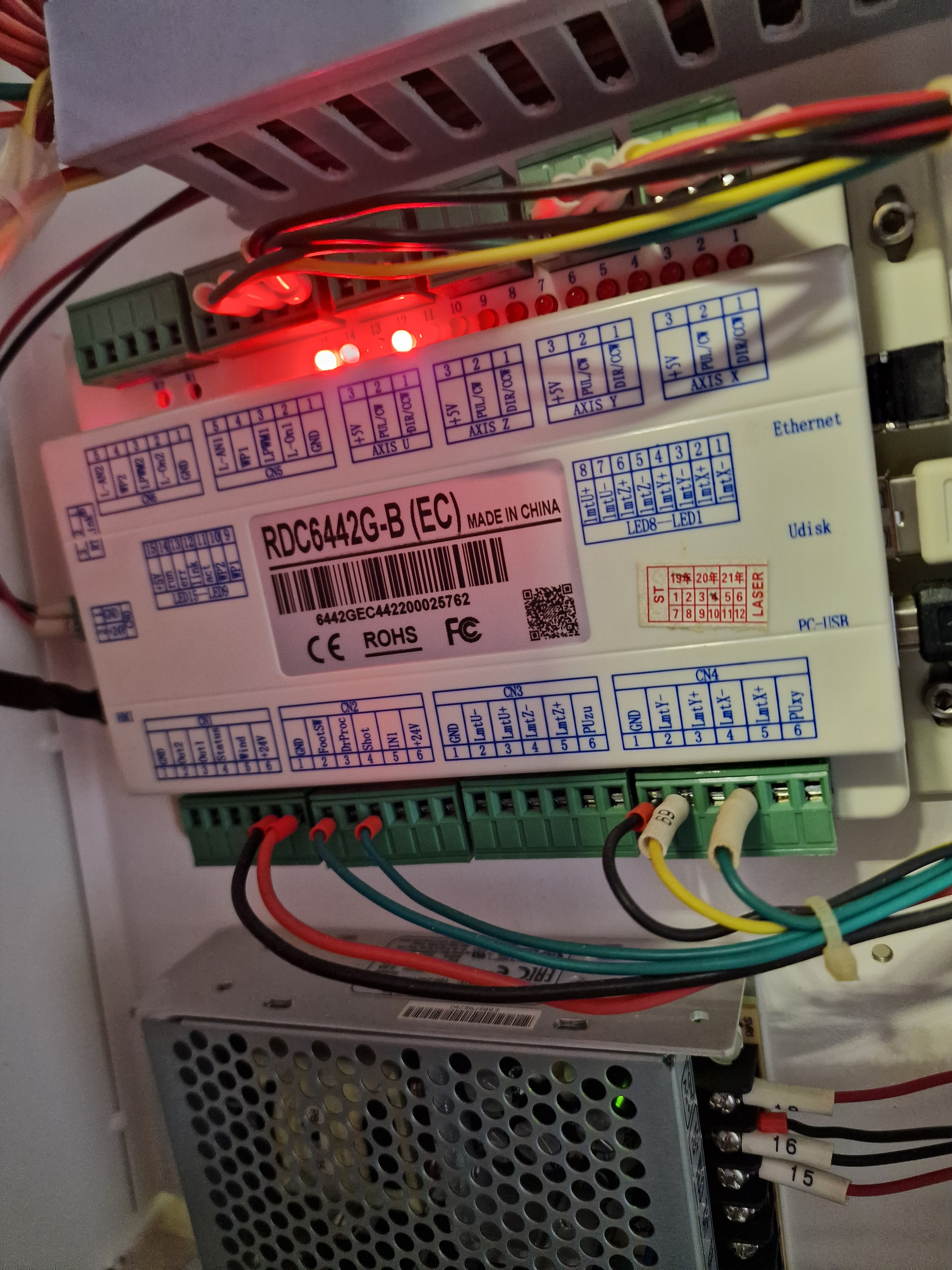

The wires on the 36 V supply have tags 44 and 55, which match the wiring diagram, and those tags reappear at the stepper drivers.
I do not see any wires to the Ruida controller from what might be the 24 V terminals of the perforated silver supply. This could mean:
  • They’re hidden behind other things in the pictures
  • The controller is powered from the 36 V supply
  • Something else is going on

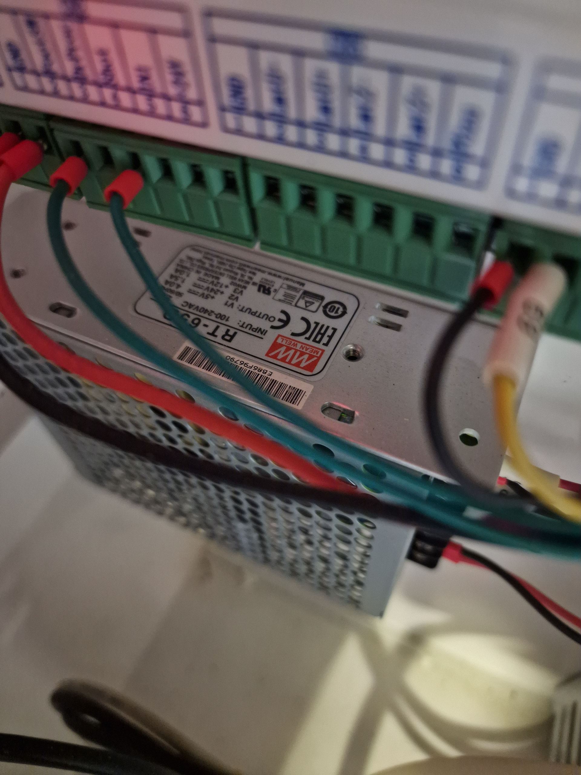

Can you get good pictures of the 5/12/24 V supply terminals and the power terminal block on the left side of the controller? Maybe trace the power wires from the controller while you have your head in there.

I think you’re correct. No label visible without removing them. One on left with grill.
One on right with solid case
I read something somewhere that these are 36v and a failing one would have symptoms like lost steps and a red led flash as you stated. Could be a quick fix if its the issue. I’m going to try looking at it tomorrow whilst cutting and see if the red led illuminates.
So nothing connected to what the diagram shows as 24 V for the controller. That means the controller is (almost certainly) connected to the 36 V supply, contrary to the doc, unless something truly undocumented is going on.
Try to follow the controller power input wires to wherever they originate …

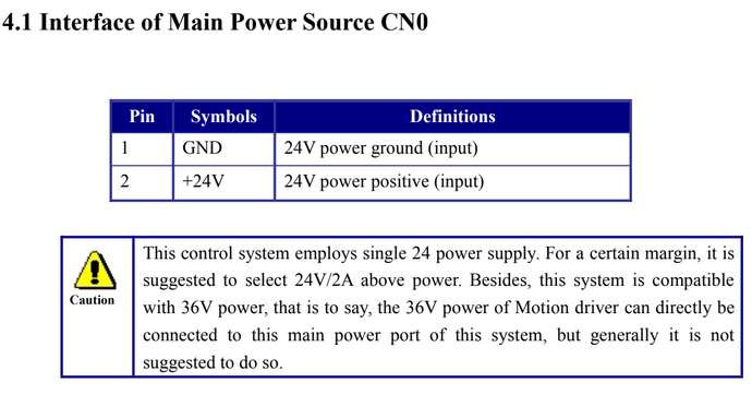

Supposedly the Ruida can operate at this voltage, but it’s not recommended by the people who put out the specs.
This is from my 6442g Ruida controller manual.
Check out the last line..

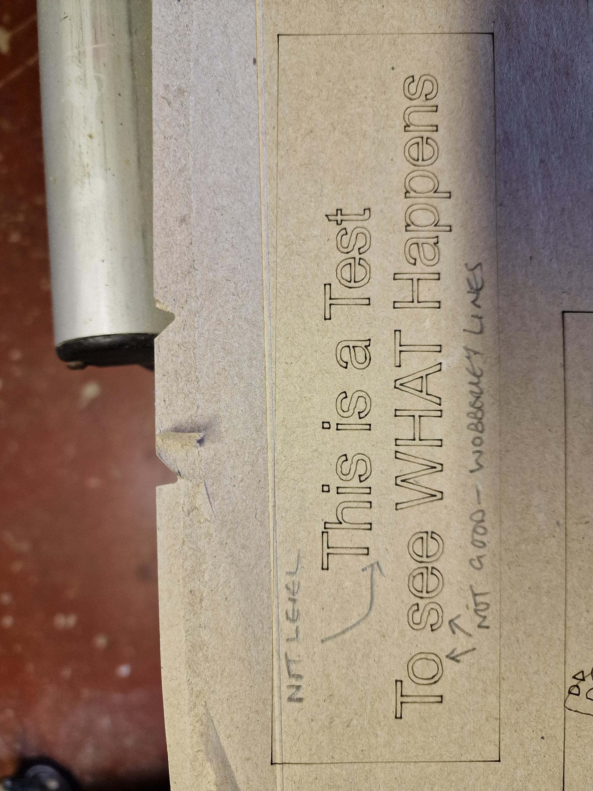

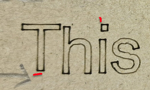

I see what you mean about the text being not level, and it looks like the dots have drifted a little also:

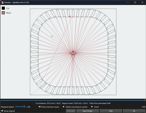

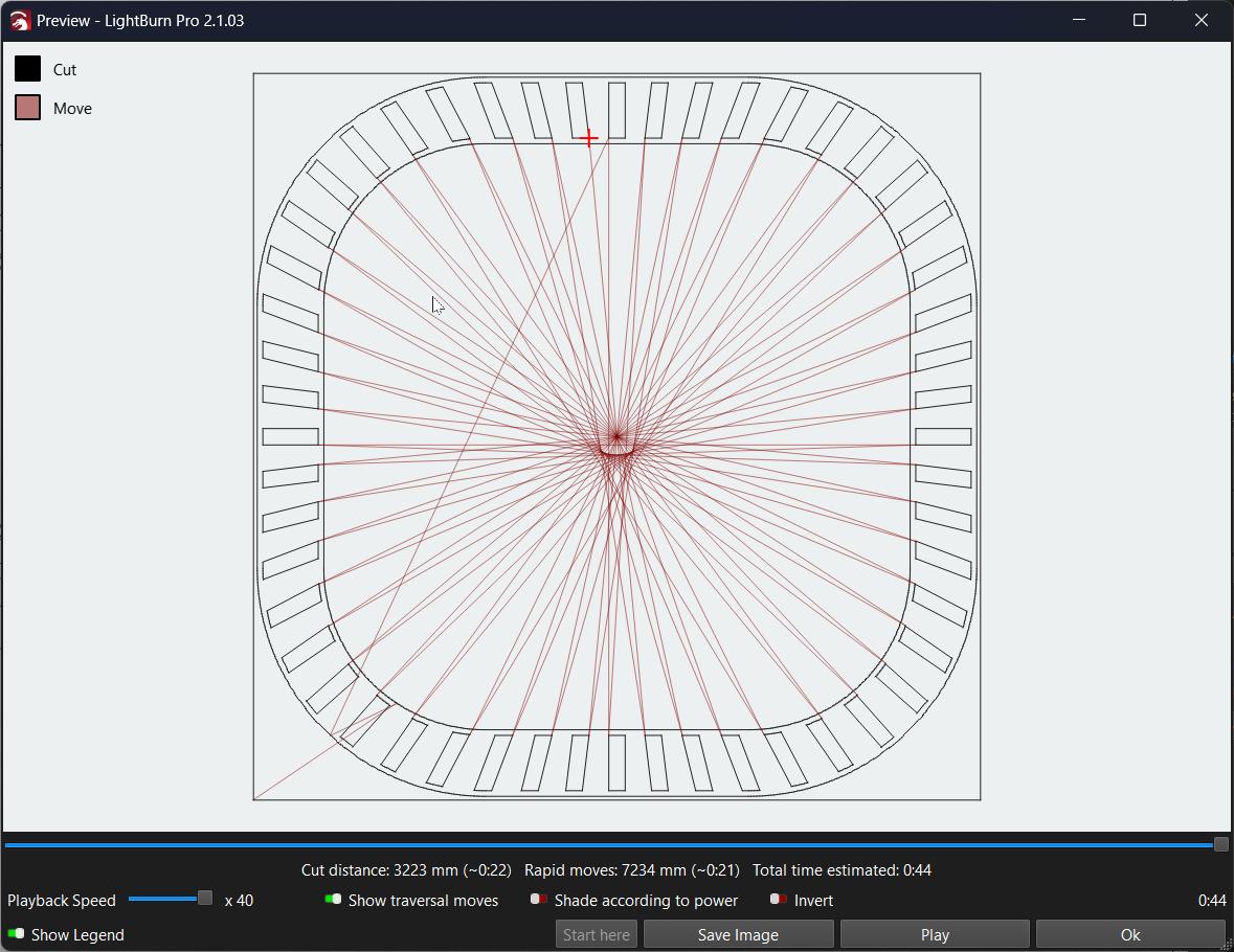

Here is a file that has a lot of rapid traversal movements:
test rapid.lbrn2 (126.5 KB)

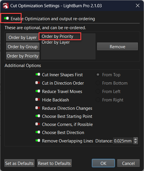

To use this file, make sure Optimization is enabled with Order by Priority at the top of the order:
If this job triggers drift, what effect does increasing or decreasing accleration in Machine Settings have?

The small wobbles in the letters come free with a large CO₂ laser: you’re watching the laser head mount & gantry flex as the direction changes. Basically, you gotta get used to it, because there’s no real fix.

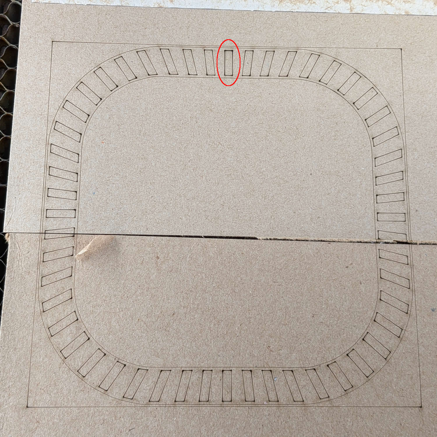

I selected and re-burned the first rectangle to verify it overlaid the initial burn. You could duplicate that rectangle in the design and set the duplicate priority to burn it last in the same job.
I don’t seem to remember them ever being so pronounced before. I don’t even think I saw them as a problem. I might be mistaken.
Unless you’re looking for trouble, you’ll never see them, particularly in larger figures. After you know they exist, of course, they cannot be unseen. :grin:

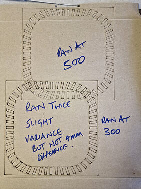

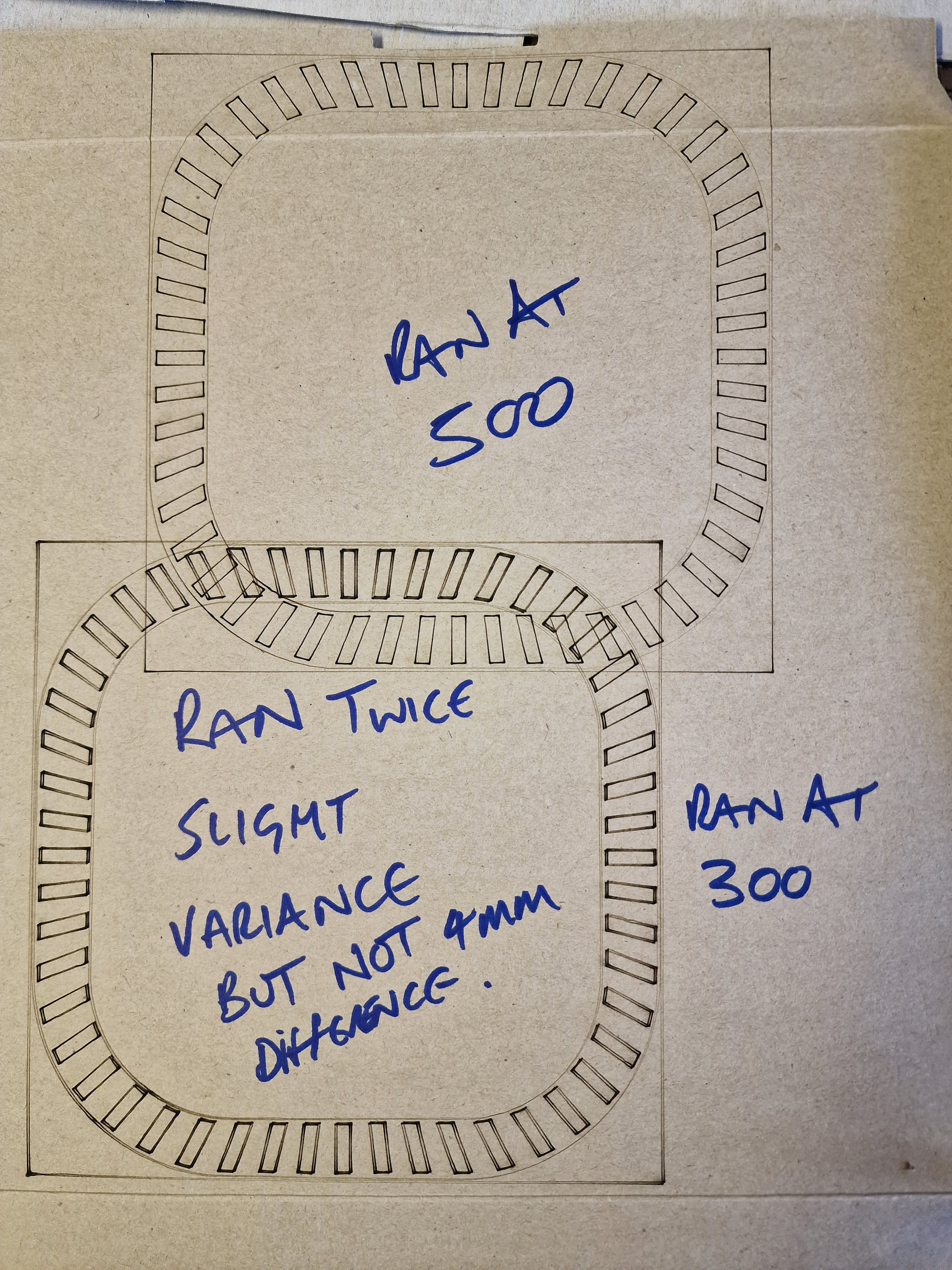

Ok, here’s my attempt. Bottom one ran at 300. I then immediately ran it again.
Top one ran once at 500.
Is this considered acceptable?
Not as I see it, because the two runs are mis-registered by a millimeter or two, which means Something Is Not Right.
Because the rectangles are engraved clockwise, alternating between 12 and 6 o’clock, I expected a single error would make the last few rectangles in the first pass (those left of 12) match up with the same ones in the second pass.
That is not the case: all of them appear equally offset.
If the cardboard shifted between the first and second passes, however, all the patterns would be offset as shown.
Run two passes again with fresh cardboard taped to the platform and see what happens.
