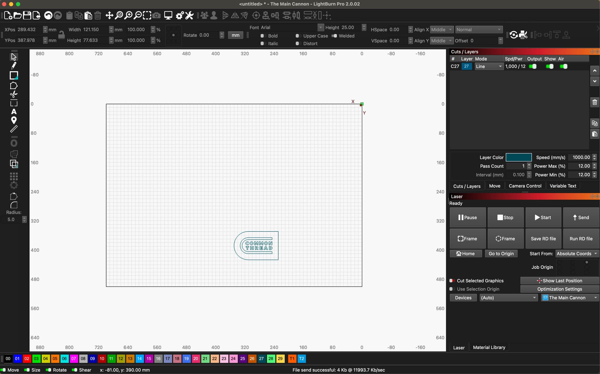

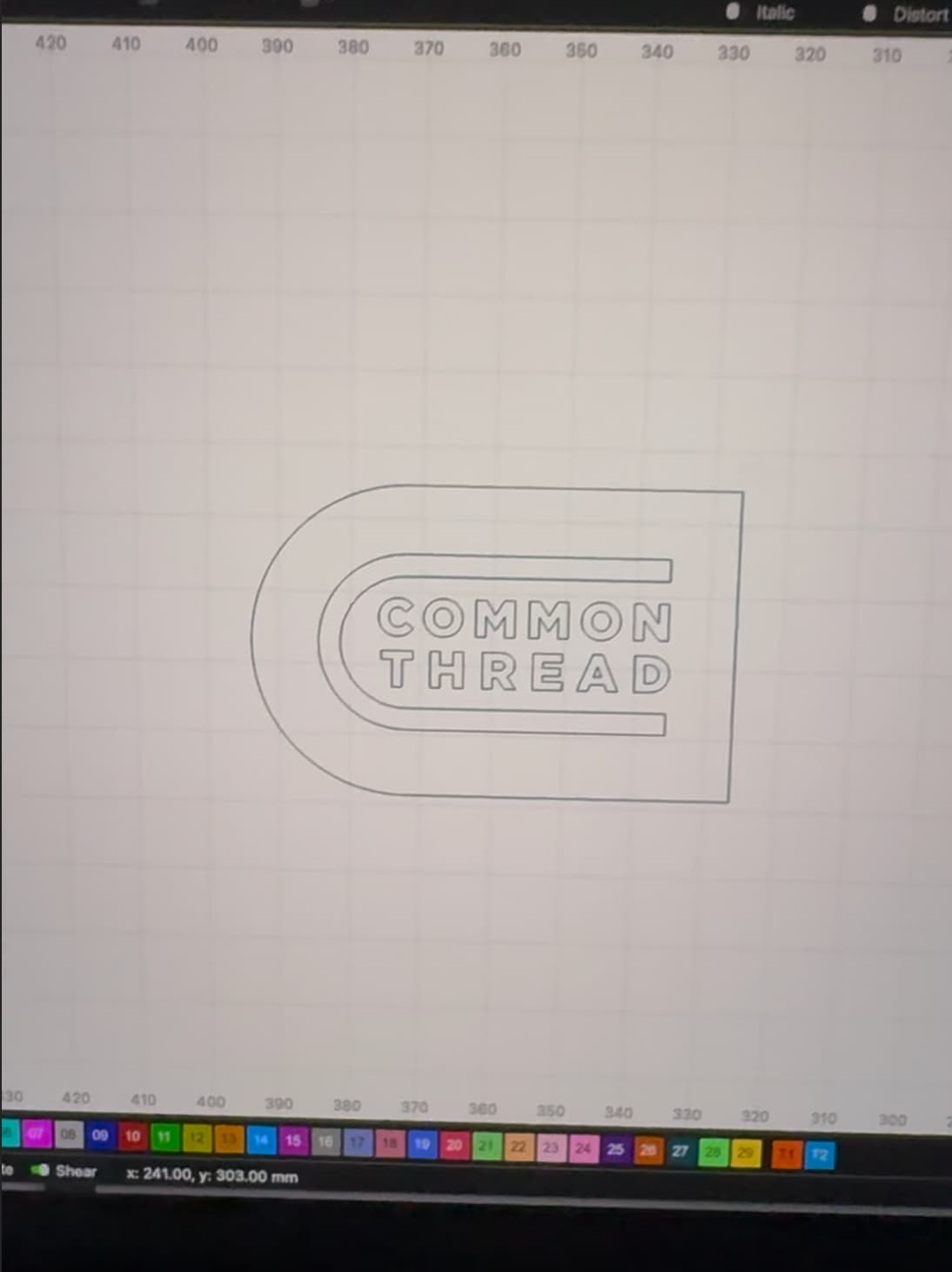

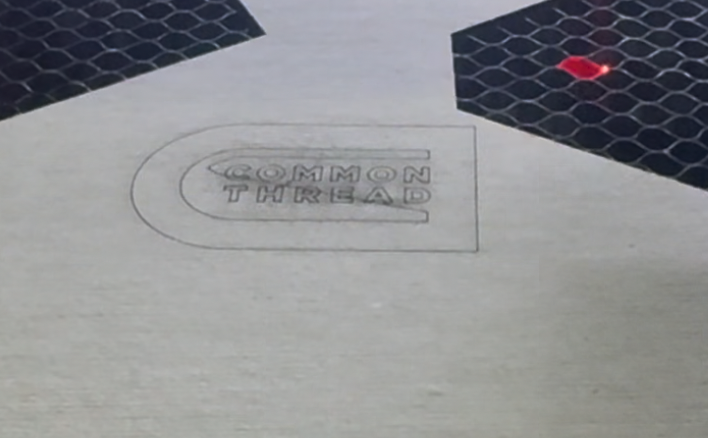

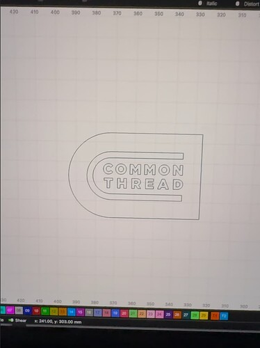

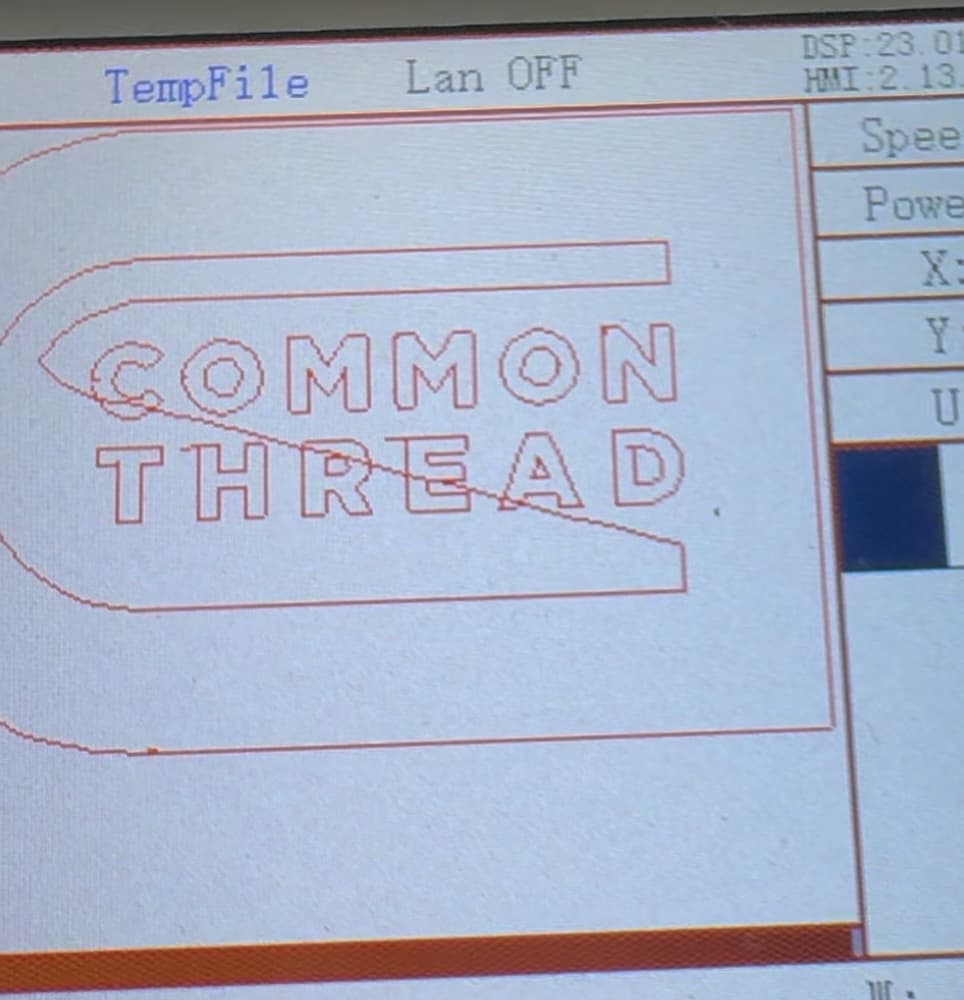

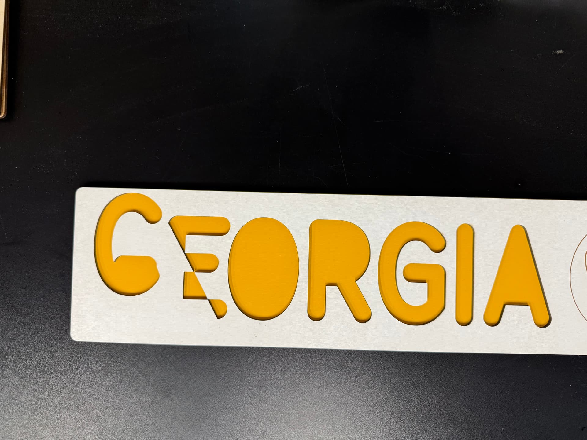

Hi, Newbee to the community, I’ve been using LB now for almost a year and was on an older Macbook Pro (2015) using LB 1.7.08 with almost no issue, I installed 2.0.02 and lets just say a few of my cuts were wayyyy off. I reinstalled the older version and was working. I just updated my computer set up to a M4 MBP and thought it should be ok to install LB 2.0.02 and just ran a couple of test runs and well looks like the same thing is happening again. Please take a look at the pics, 1st is the file, 2nd is the actual cut, and 3rd is whats on the controller (similar to what was cut). Is it the controller? Any help would be amazing

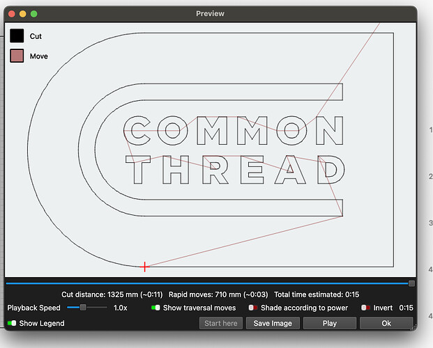

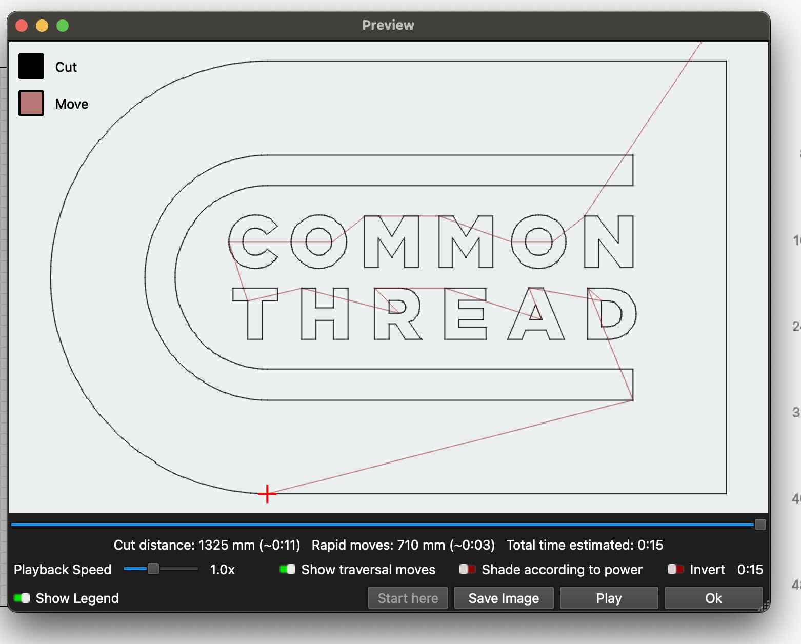

A screenshot (not a cellphone picture, please) of the LightBurn Preview will help determine what LightBurn sent to the machine, which may differ from all of the above.
Just did another test and this is what I got, preview looks fine, print came out similar to first post (actually worst). I did run this print from my old set up to see if anything was going on and those prints came out fine.
That tells you there’s a communication problem between the PC and the laser controller, which typically happens due to USB dropouts.
Some previous discussions cover the problem & solution, in particular with Apple products:
What on the machines console displays is what was received, not necessarily what was sent.
I’d say it’s a communication issue. Can you implement a connection with the Ruida to your lan?
@ednisley @jkwilborn Thank you both! I connected via ethernet/lan and seems to be working fine now, I’ve only ran a couple cuts but seems to be doing what I want it to do

Since it arrives at the Ruida, showing incorrect on the console and another send shows the correct version, I think it has to be a communication error of some type.
I think with these, USB is so crappy, that the best advice is to use Ethernet, even though it’s UDP and static.

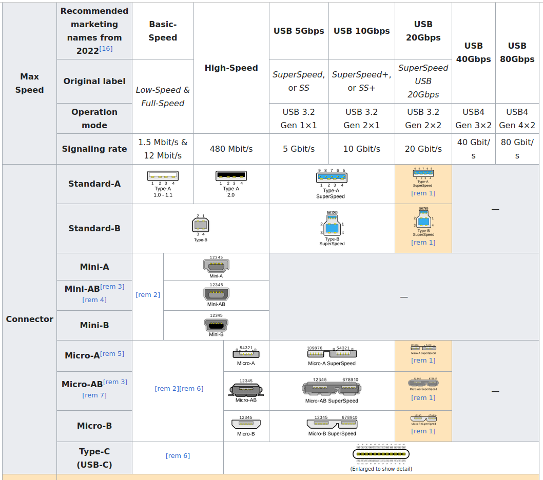

USB is supposed to eliminate a need for the user to configure anything… however we see them pretty frequently having issues over things, such as baud rate.
USB is supposed to have same type connectors… if you buy all the things you want from the same computer manufacturer, maybe…
I have a wall of different types of connectors that are USB.
These are all benefits of the USB system.
