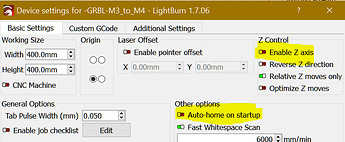

What is your power set to under Edit > Device settings?
On LightBurn Cknsole window type $i then press enter key, type $$ then press enter key.
Copy / paste here all the output.

As a good practice always insert and remove your machine plugs with power and USB disconnected.
  • Post a screenshot of Edit > Device setting.
  • Can you post a better picture of the selected zones were we can read the letters?
  • Post a picture of the connections at the other end ( laser module).
  • Check if your 3018 controller has a switch for laser.
  • If your 3018 has a hand controller unplug it and try again with Lightburn.
  • At last try with LaserGRBL program and report back.

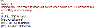

Thank you - it seems to be two steps forward and one back at the moment. I’ve sorted the above issue, but I keep getting a “check limits” message
I really don’t know where this is - I do know the machine has been built correctly because I didn’t do it :wink:

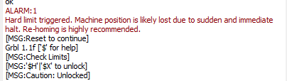

The machine seems to be stuck a third of the width in on the workspace (300x180 is what I’ve set $130 & $131 to) Also the position of my text on the computer isn’t the position on the wood in the machine. The must be some settings that I haven’t got right!
Check your $27 setting. That’s the amount of pulloff in homing. It is typically 1-3mm.
Set $27=3

Thanks for the reply - $27 is set to 3. I changed £130 & 131 and the work space to the figures sent. Pressed the home button and it crunched the gears with these messages
I dont know how to check the limits? It just stops a third of the way across the board

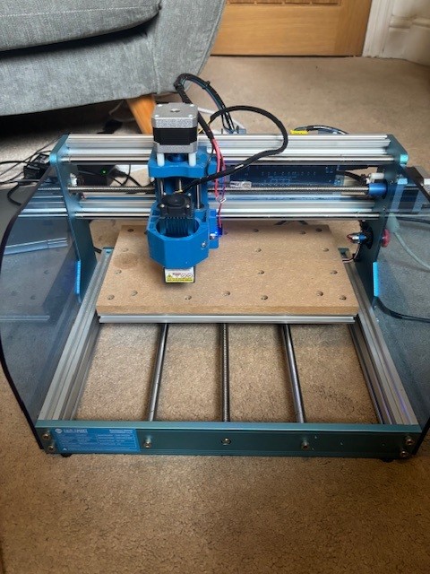

Its v frustrating as everything else seems to work :slight_smile: - see photo

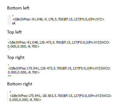

I think it is soemthing to do with the settings of the laser at each corner of the work area. below is what Ive recorded. Are these wrong and how do I alter them - via the off set but dont know how to work out the correct numbers

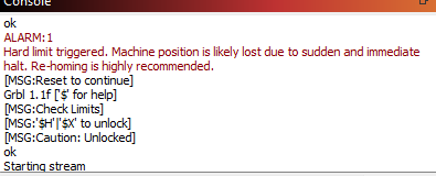

  • Unplug your 3018 (power and USB)
  • Disable Auto-home and Z axis.
  • Reconnect the 3018.
  • In Console type $HX press Enter $HY press Enter to home axes individually.
  • Check if the machine runs a small project.
If you still have troubles type $RST=# press Enter and check again.
