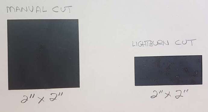

Yesterday my laser was running fine. Today something changed.
When I set my laser up to cut a 2"x 2" square it now cuts it as 1" in the Y axis and 2" in the X axis.
But the odd thing is that when I manually move either axis 2" the distance is correct.
I’ve tried using two different computers and two different versions of the software but nothing changes.
Any help I could get would be very appreciated.
Thanks.
Is rotary disabled?
Geeze. Another “I feel so stupid” moment. :nauseated_face:
You are correct. The rotary was enabled.
Disabled it and it’s running fine now.
