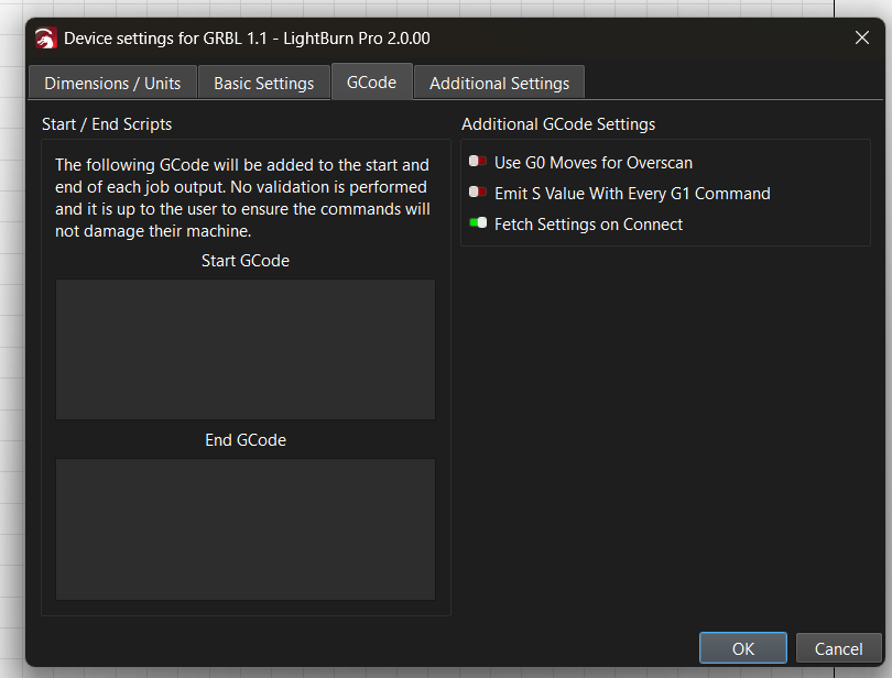

I just installed the latest update. I did not change any setting from the previous version. Now after every cut, every engraving the laser moves diagonal towards bottom left for about 15 mm… 2 secs, (sometimes up to 6 seconds travel before it goes back to burning). When engraving 200 + lines I loose 400 seconds of work time. Just annoyed at this useless move which was not there before. Any idea what the cause can be? Made a clip but can’t upload it here.

I can second this, I had the same effect. Though for me, the laser moved fully to the front-left, touching the limit switches and crashing the job due to the hard limits. I even exported the gcode files and the commands to move front-left are included there.
I did a clean install and the issue was solved (I think, I have to check again). I remove the LB preferences folder before installing again.

Ah, if you don’t feel comfortable doing extra steps, I’m happy if the fix was to just re-create the preferences folder.
If there’s nothing specifically private in it, we would appreciate a copy of it (you can email it to support@lightburnsoftware.com if you don’t want the whole world to have access to it), and if you can include your current preferences bundle (File->Bundles->export bundle) that would also be appreciated.
No worries, I can do the extra steps and don’t mind showing the world lol… let me see if I can find
Ah, ok. So you’re using a GRBL device, and you sent the $$ before the connection was active.
Please try enabling this, in device settings → gcode tab → Fetch Settings on Connect
It will output your device settings and also let LightBurn parse a number of helpful values.

ooooh, that’s interesting. I didn’t notice before that your G54 workpiece offset is set to somewhere odd on your machine…
That could affect things with LightBurn 2.0. If you home your machine, can you send a ? in the command line and parse the output back here?
