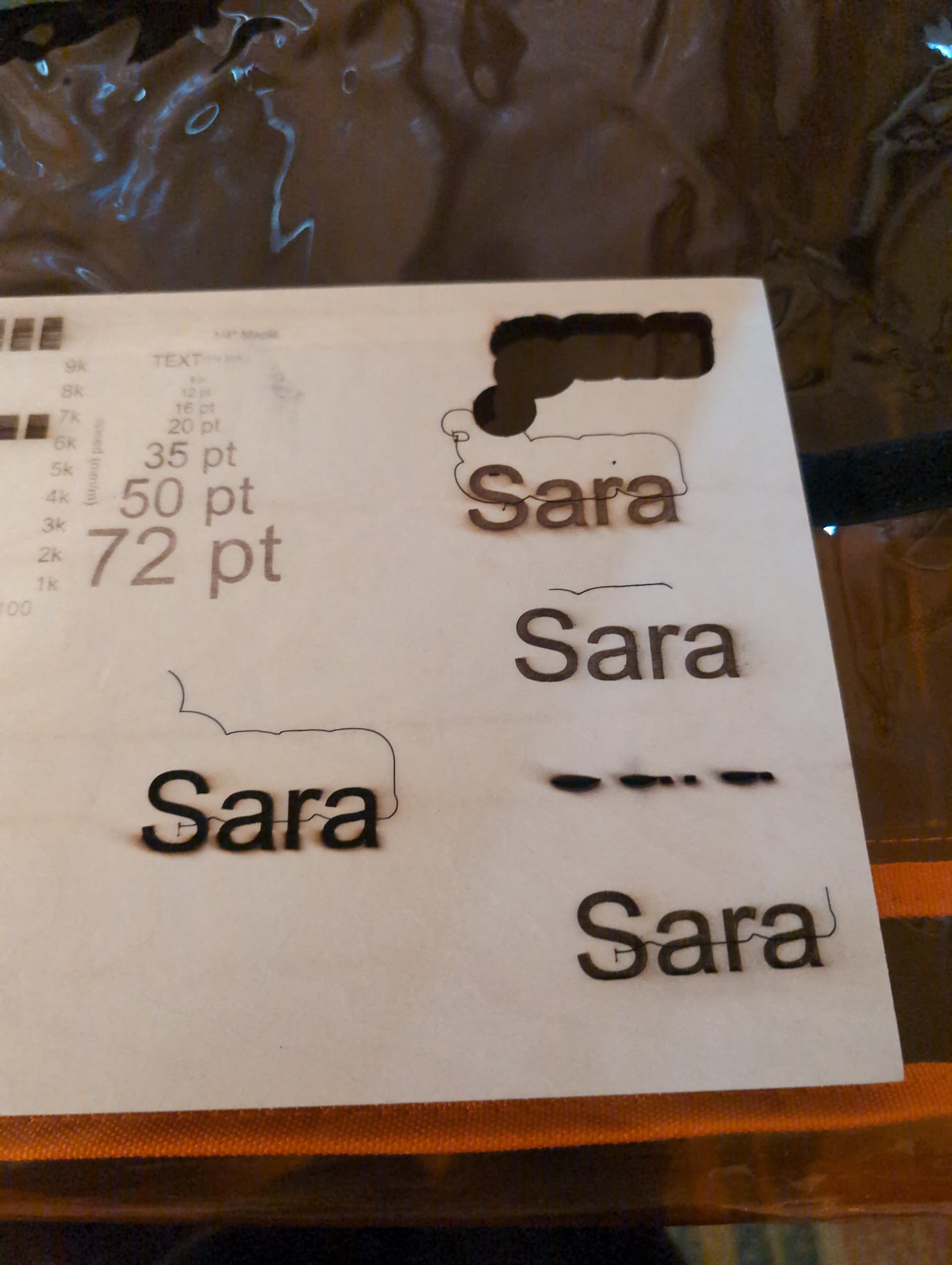

I have been reading through here for the last couple of weeks but cant seem to get passed an issue I am having.
using absolute coordinates my first layer frames and engraves fine but then the second layer cuts in completely the wrong place. I turn off the laser rehome it manually ask it to frame again and its a location no where near by design.

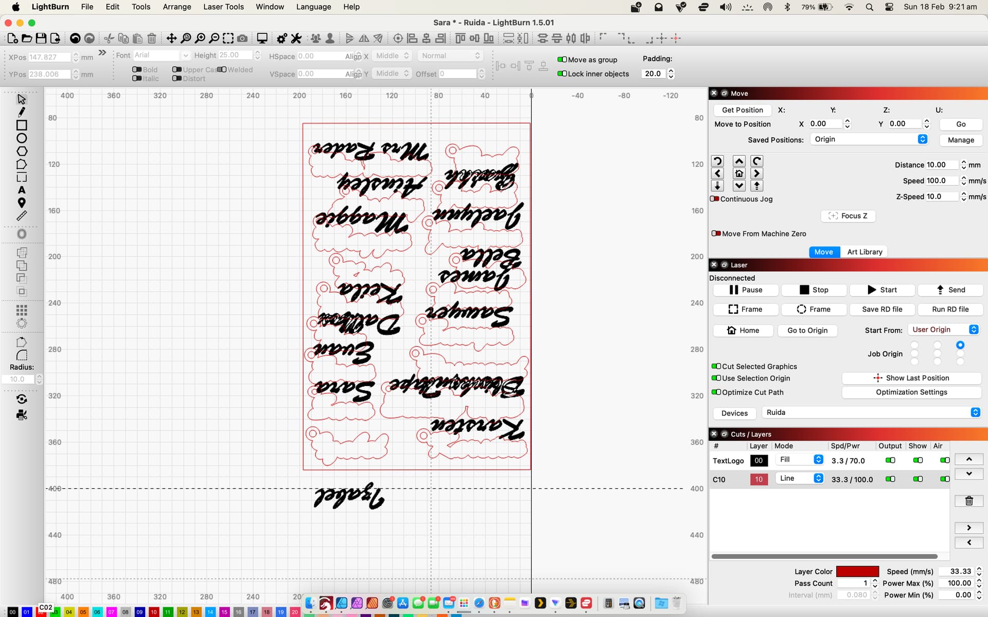

This is why it doesn’t cut correctly.
What version of Lightburn are you using?
ok now we are getting somewhere why does it look right when i open it :thinking:
version 1.5.01
So is mine.
this is some kind of bug.
ok so weird thing is we also installed it on my husbands laptop and pulled up this file and it looks fine.
This is a small update to address a single issue: Cached images could flip orientation when reloading, depending on machine origin and the image orientation.
This is the only change in this release, so if you’ve installed 1.5.00 you should update to this version.
If you have files that flipped images, just select them, press H or V to flip horizontally or vertically to correct the orientation, and resave.

Still having the issue despite weeks of trouble shooting. This morning it was working fine tried cutting this file worked fine the first 3 times … playing with different speeds and then started having the same problem.

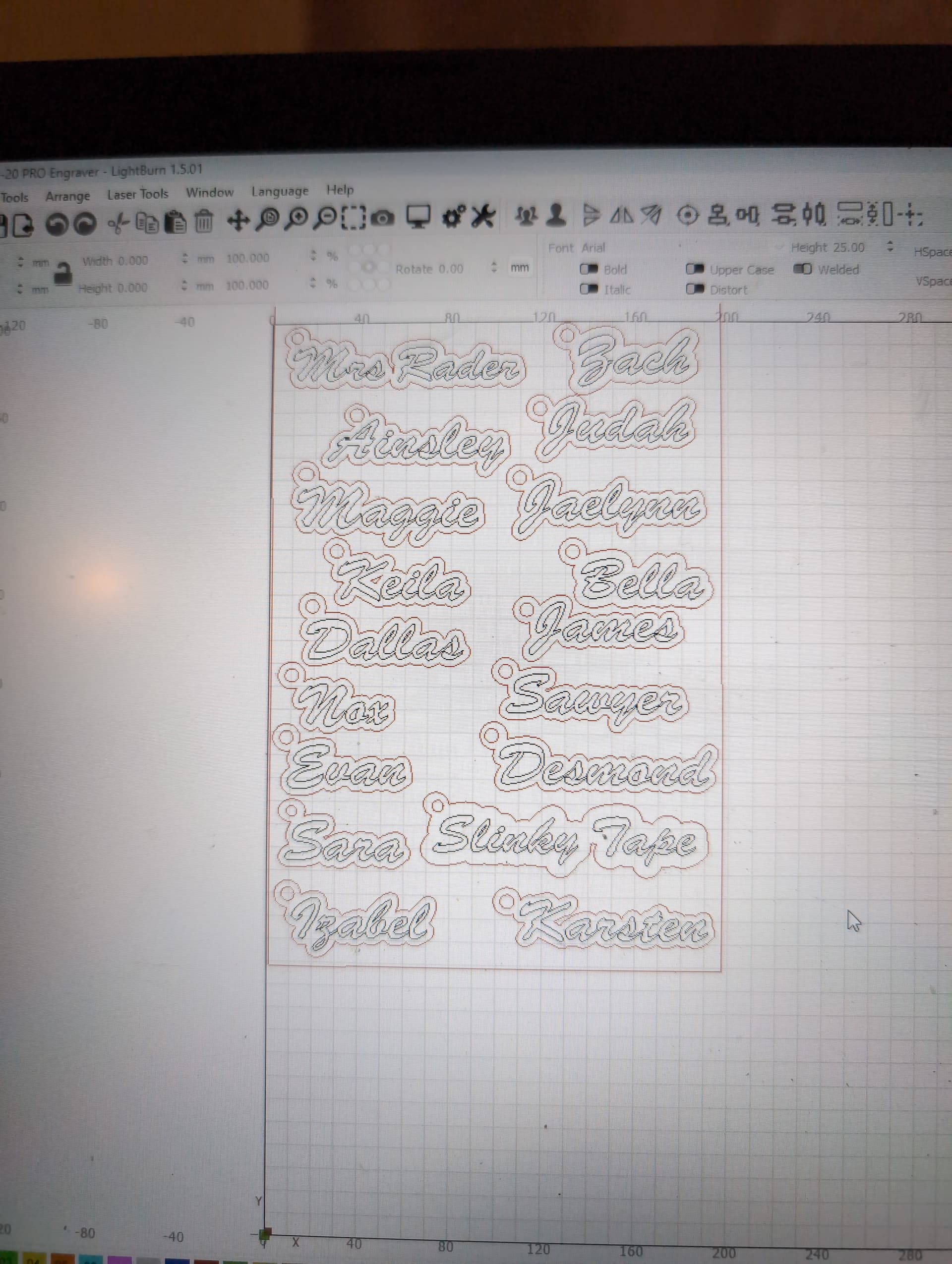

What is the problem you have with this file?
It engraves fine and then intermittently has a problem where it just cuts completely off. Worked once out of 4 tries this morning.
Little confused with the arcs and crescent pieces.
How does it look in preview?
Other than you have it set to cut first, it previews for me fine.

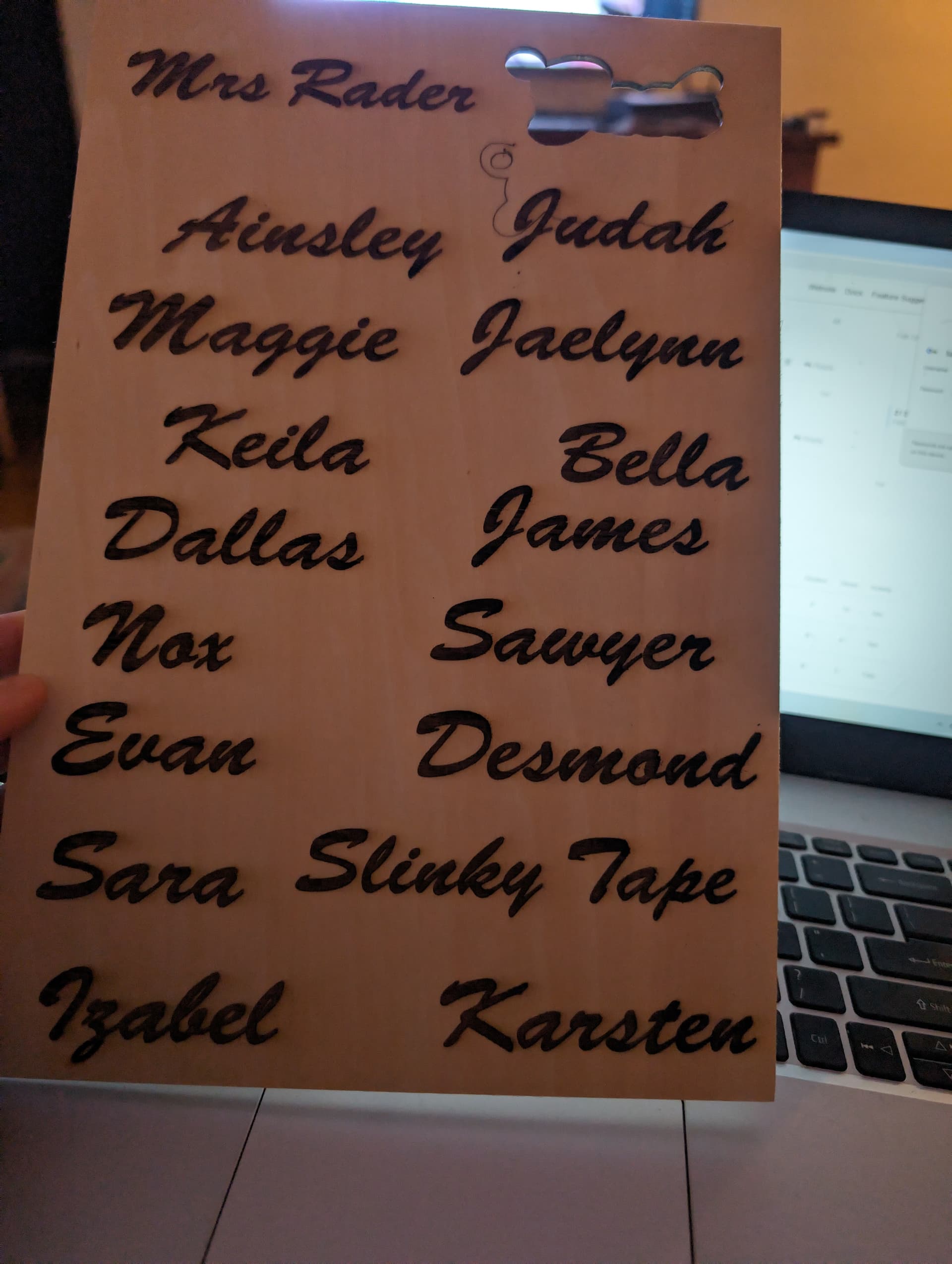

It previews fine for me too ! It’s so frustrating! Its supposed to be text centered in a cut out circle. I just stopped it when it started cutting through my text.
My husband just downgraded to 1.4.03 on his laptop and it seems to be working ok… Going to try a few more and see if it keeps working since the issue has been intermittent.
