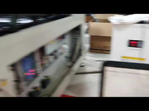

Hello,
I have a 300W CO2 machine with Ruida controller
I’ve installed the LB DSP version yesterday
The LB software recognizes two controllers when connected to the machine
Upon sending file to the machine and hitting start , the machine head moves with no laser emitted , but machine works well with an open source software (named metal cut)
Tried the LB software on my g-code machine and all went well

I’ve already enabled both laser 1 and 2
This is my rd controller
Below is the link for the video showing the machine behaivor

I am not familiar with this kind of configuration… But, I believe this is an LFS-PM-T43 which is the autofocus end of things.
This is the PDF manual… remove the .txt extension after downloading.
LFS-PM-Series-Live-Focus-System-Operating-Manual-V2.0.pdf.txt (2.7 MB)
IMHO, I think we should start at the lps end and work backwards… It would be nice to see what this device is controlling…
I suspect there is another Ruida in the mix…

How does this work with two Ruida controllers in the system? The photo seems to have them wired together…
Does Lightburn actually control anything with the focus module?

The machine is giving out air and moving along the path precisely with no laser emitted
Tried another software (named metal cut - it came with the machine) and all went well
Also tried to send file to machine , but still having the same problem(only air is emitted with no laser)
Is there any configuration that should be done in the software?
@Rick @JessN
Gathering the information shared, investigating further. :slight_smile:
Please share screenshots and a LBRN project file of the job setting where you do not get laser output.
Update: I missed the inclusion of the Live Focus feature of this setup. LightBurn does not support Live Focus at this time. Asking dev team for any additional information we can share.
