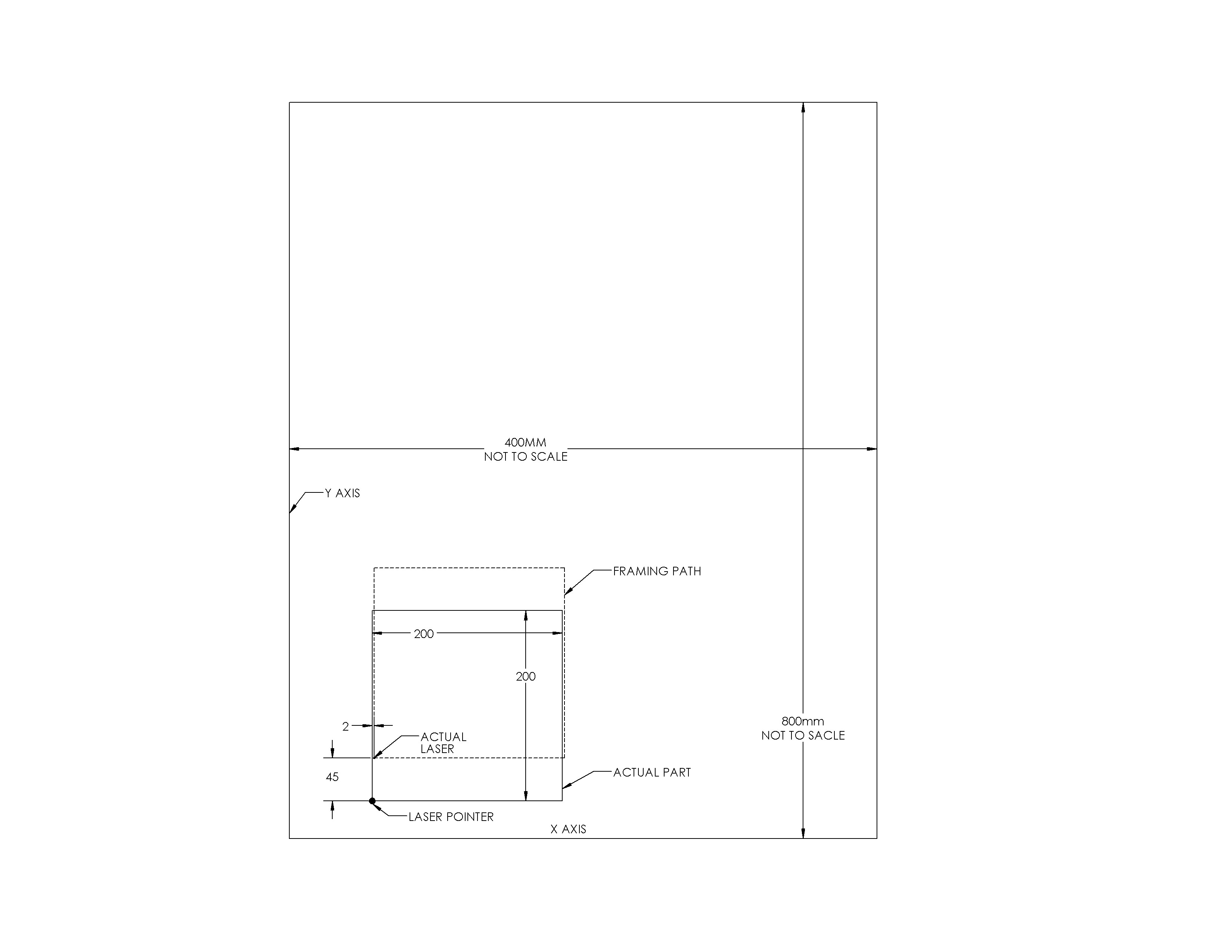

This is the best I can do. If I ignore the incorrect framing path and just engrave the part, it engraves in the proper location.

The red dot is just an indicator to me as to where the blue dot will be when it starts cutting/engraving. If frame was running correctly the center of the laser (the blue dot) should move up to where my reference (red dot) was at the corner of the part (then trace the perimeter of the part). It doesn’t do that, when I hit frame it traces the frame from where the blue dot is (which is -45, -2 from the red dot). It does this weather the offset switch is off or on. The offset switch is currently ONLY affecting the actual cutting path, not the frame.
The expected behavior is for framing to be unaffected but for the actual output/laser to be shifted to match the area the red dot framed - is that what you’re seeing?
Yes that is what is happening, however, that behavior doesn’t make any sense when you are trying to use an offset laser to point to the origin of your program, but you want to see the ACTUAL path of the frame. Maybe add a switch (Trace Frame to Offset)
Perhaps I’m misunderstanding what you’re trying to do, but if you’re using the red dot pointer for alignment, it makes more sense that you would jog the red dot pointer to, say, a corner of a piece of material, and then frame from there. You are seeing the actual path in the most important sense. Where the red dot frames, the actual output will be.
If the behavior were reversed and the framing were offset, you’d need to align the laser beam location to the corner, then check to see if the red dot location was correct when the offset frame was run. But that would be a bit trickier than just using the red dot in the first place - for a diode laser you could use the Fire button to align the beam location (but then you probably don’t need the red dot to begin with), but CO2 lasers don’t have that option, so it would create some unnecessary guess-and-check.
The vacuum attachment surrounds the laser module so seeing the actual laser isn’t feasible. That’s why I pick up the origin with the red laser. I would simply like a way for the frame command to mimic the behavior of the program if laser offset is enabled. Mainly as a sanity check to make sure nothing crashes. Just so I know for sure when I hit go, the head is really going to offset.
Gotcha - as long as you have the offset dialed in properly and never turn it off, when you run then job the head/output is always going to offset to the location you framed with the red dot. But I can understand the desire for an additional sanity check - to do that, you can turn down the power setting on your layers all the way to 0%. Then frame them, then run the job at 0% power, and you’ll be able to see that the offset is working, without risking any material.
