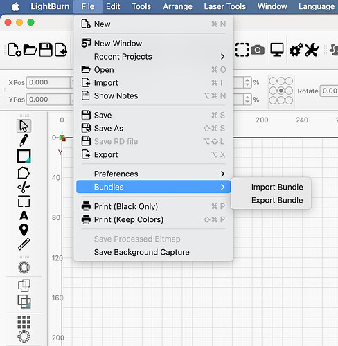

Even better would be if you could share your configuration bundle (with the LB configuration included, not just device profile) to help us replicate and debug this last bit of oddity.

If this is not what you are looking for, please tell me how to get this Bundle. I mostly use my setup in MM so I have LB set up for that.
I guess what i sent was correct. App settings and Device settings The only items i left out of the bundle are my projects. I really don’t want those public. I attached my machine settings file if that helps.
