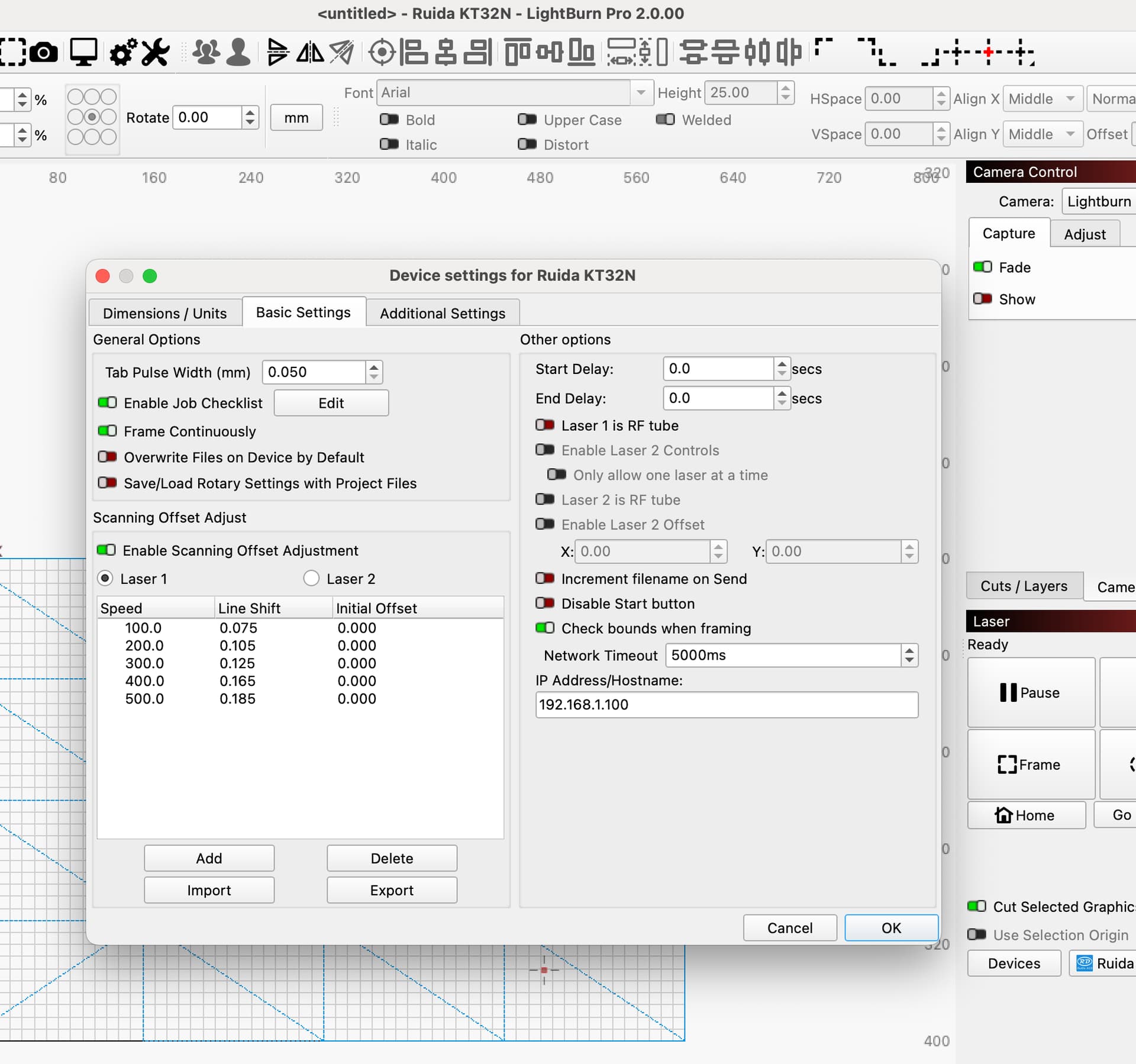

@bernd.dk can I ask you to check on the device settings page if this toggle is enabled?
This ought to automatically query and fetch position updates. I think by default it is set to false.
…it’s not a GRBL machine
Ooooh woops, my bad for that assumption. I’ve been laser-focused on Gcode machines since that was the highest level of MillMage/LightBurn crossover there was to deal with for me.
I will double check why this isn’t updating as it should on Ruida.

Settings are as shown. if i turn off Query i must click Get Position in order to show current posistion.
Thank you @Brandrew - I’ll get right on this now that I can replicate it.
That is now expected and as designed. The shown position is always updated from what the device sends us. We won’t assume the laser moved somewhere simply because we told it to anymore. Especially on Grbl devices with incorrectly set firmware this can be dangerous…
