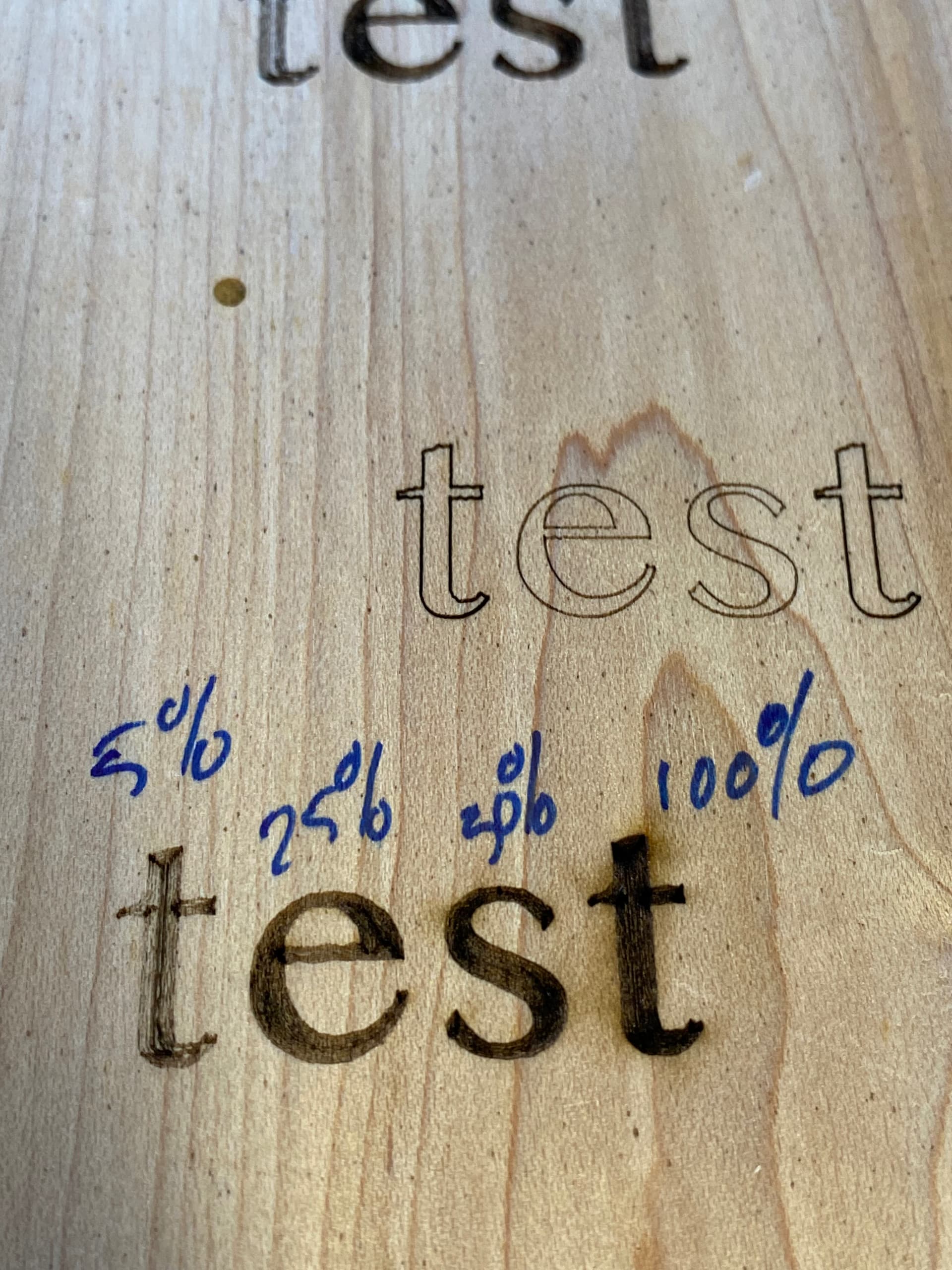

After more testing I have found that I can get the regular GRBL profile to fire the laser at the correct Sxx power level using M11Px Sxx and M10Px.
This requires a manual entry of M10Px before every G0 move and M11Px Sxx after every G0 move. If I do this it works great. no delay of the laser firing and the correct power levels on the output voltage display.
The only remaining issue is that if I rewind the program to run it again with either an M30 command or with a manual rewind in Mach3 the program will again only fire at 100% power…explain that one…
If I reload it fresh it fires with the correct power level.
This I can live with as I don’t do a ton of jobs that need a rewind. If I do I just need to reload it between programs. Maybe someone has an idea of why this happens?
Now I just need to write a script to add the right code before and after the G0 moves and I think I may have this figured out.
This may also unlock pic engraving with multiple power levels but I haven’t tested that yet. I’ll have to wait to see if that works until after I have a script that changes the code properly and works.
Just speculating but could it be that you’re thinking about this backwards?
As-in instead of surrounding the G0 commands you should be placing M11Px Sxx before every G1 command and M10Px after every G1 command. I assume this leaves the M10 off state as default when it hits any G0.
Here is the example of the code that was successful. Please take a look and let me know if you see any changes that should be made, but this code worked on my system. I edited the code for brevity.
The M10P2 command before the G0 command turns the laser off. M11P2 S5 after the G0 command turns it back on at the correct power level. Not sure if I can post a video of this or not.

I got ChatGPT to write an AppleScript to look for every G0 command, add M10P2 above and M11P2 Sxx below. I’ll test this tomorrow. Fingers crossed.
If this works I’ll try to have several power changes in the same program.
I was able to test multiple power in the same program this morning and it works!
This requires you to have M10/M11 and PWM set up properly in Mach3. In LB use the regular GRBL profile for your machine.
At every G0 move add your M10Px command one line above G0 and your M11Px Sxx command one line below G0. Be sure all M3 and M5 commands are also changed for your M11/M10 code for your system.
The script I had ChatGPT write changes all of this for me. I will have to have it write another one that pays attention to the power level set in each layer so I don’t have to do that manually.
