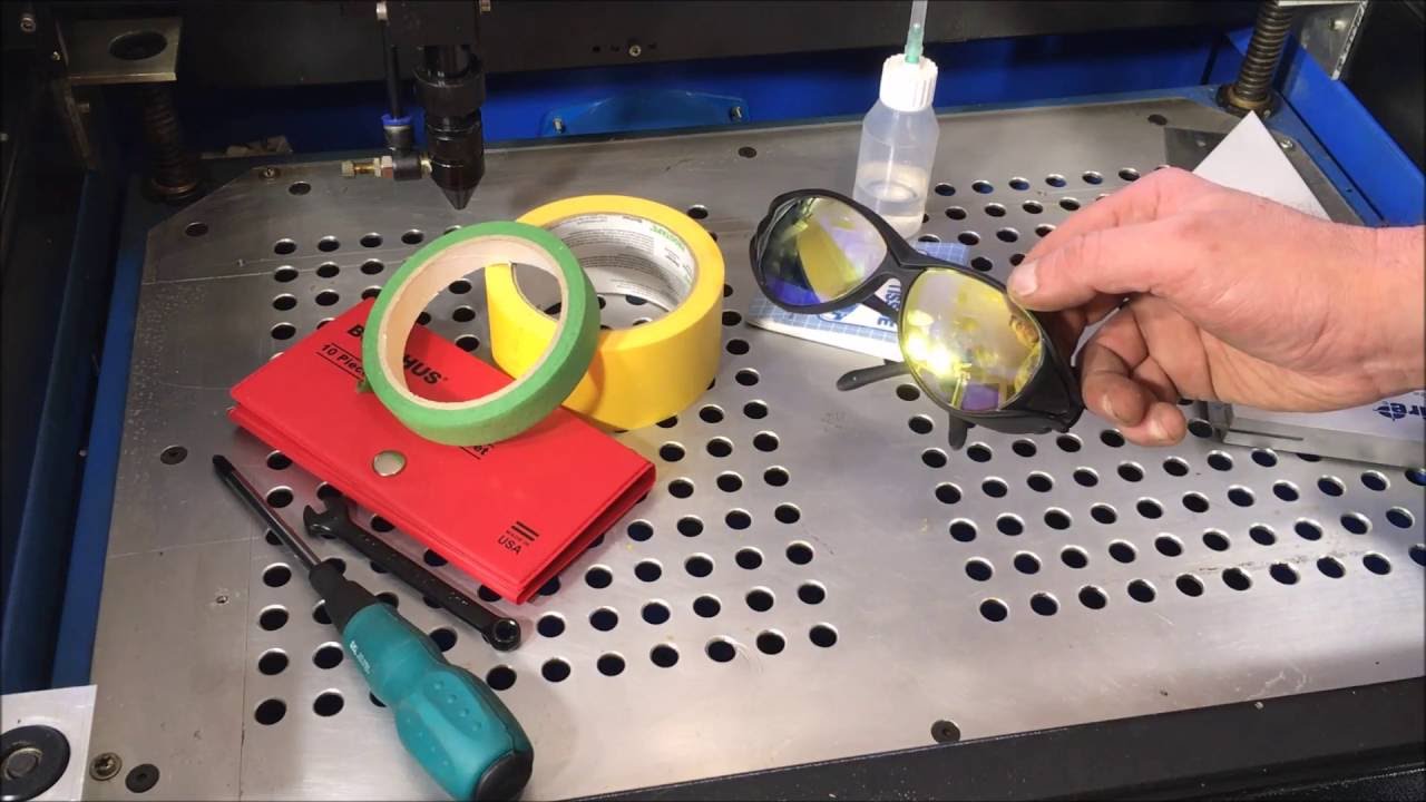

There’s no shortage of videos on how to align your laser. Jeff is correct. Start with the machine itself. Make sure it’s level, then the tube, then the mirrors. It can be very frustrating to align so don’t give up!
This video talks about the theory of it. Laser goggles are a MUST. There will be times you might have one or more of the doors open to see where it hits. Make sure no animals , kids or people are around. And only pulse the laser as quick as you can or you’ll vaporize the tape and catch it on fire. If the beam is WAY off, I use sticky notes to see where it hits.
