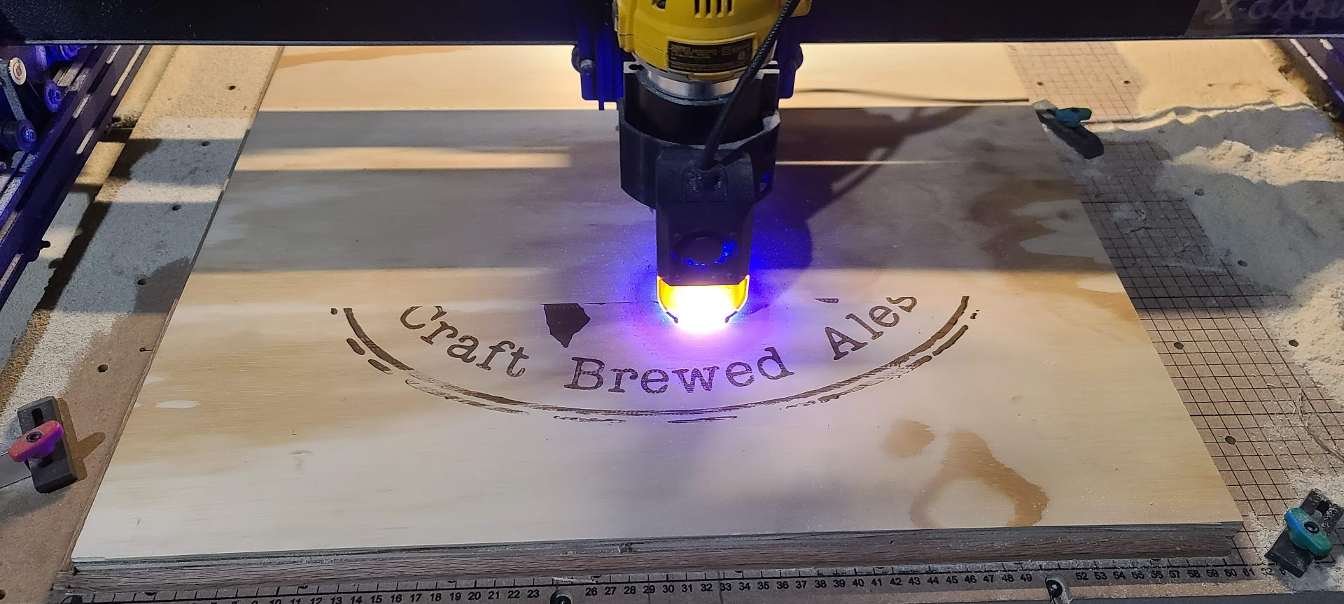

The basics: X-Carve with controller bought in 2020 with the JTech 7w laser.
Let’s try and assume I have a run of the mill laptop with Windows 10 (I do), every driver is updated and your software with a JTech laser.
Every single thing I try to use the laser for, it stops halfway through.

If I upload something and image trace it…or write a few lines of text…or literally anything…it just stops after a 2-3-5-8 minutes but never actually finishes the burn.
I’ve disabled the USB power management setting (one of many of the previous posts).

You don’t get any error messages, it just stops?
Have you tried a different USB cable? Preferably one with ferrite chokes on the ends?
How long is your cable?
6’ cable that came with the X-Carve. My laptop is approximately 16.37" from the controller.

If it looks like it’s still running, but it isn’t, that will be a communication dropout of some kind.
  • Is the frame of your laser grounded?
  • Have you verified that USB selective suspend is disabled for the USB ports?
  • Do you have anything that could surge connected to the same outlet or circuit as the laser? (mini-fridge, compressor, chiller, table saw, etc)
  • Have you tried a different USB cable?
  • Does the USB cable run close to motor / stepper wires? (those are relatively high current and can induce noise in unshielded cables)

Attach a wire from a metal part of the frame to a grounded object, like the case of your computer. The plastic wheels will isolate the different frame parts from each other, so it might be necessary to ground both the laser head, X axis rail, and main rails independently by tying them all to a single wire, then connecting that wire to ground.

The X-Carve (and a number of others) use rubber belts moving over plastic wheels, and that will generate static electricity, and if that discharges through the USB connection, it can cause dropouts. The fact that the laser head is isolated from everything else is precisely what would allow static to build up. I can’t say that is the issue, but it’s one that’s come up before.
Running GCode for images is really pushing the limits of what an 8 bit controller can do, so if you’re doing photo engraving, if anything is going to go wrong, that’s when it’s going to happen - the amount of gcode sent to the controller is a fire hose compared to the trickle of a normal cutting or engraving job.
If Easel can run external GCode, try this: in LightBurn, click ‘Save GCode’ and save it to a file, then try running it from Easel. If that works without any issues, then there’s a decent chance that there’s a difference in the way that Easel and LightBurn communicate with the machine that could be an issue. If it fails in Easel as well, then it’s probably not LightBurn at fault.

So here’s what happened tonight: I restarted my laptop 3 times, opened up LightBurn about 3 or 4 times…I finally connect and get it to burn. (had it run twice line/fill) and it worked. IT WORKED!

Tripled the size of the logo just for sh*ts and giggles…and to test…
so far so good. (messed with A LOT of settings where I don’t know what they do, ‘Konami Code’ type of sh*t)
The one thing I changed so far is…
I got rid of the IOT relay and plugged everything into a 3 outlet extension cord: X-Controller, DeWalt 611 router and the JTech driver. Nothing was ever mentioned about an external relay switch product in any forum I’ve seen.
It’s still going!!!

DONE!! (3:36am)
It didn’t stop halfway through…but it kept going until I hit the emergency button to shut it down. Don’t know what happened there!!!
The IOT relay definitely made a difference.
