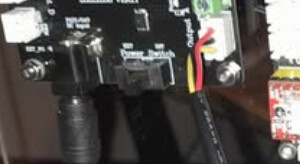

Post a picture of the board with your connections.
Is that Okay ?
It seems your switch is at the internal side…
Recheck the connections, not just the way the plugs go but also the name PWM to PWM, GND to GND, Power to Power, from controller to board and board to laser.
Sorry been out shopping, I have just tried it one of the wires was wrong but I have tried it ext & Int before you shown the picture but now it’s on I have corrected the wire it’s not lighting up at all now but Following Commands ?

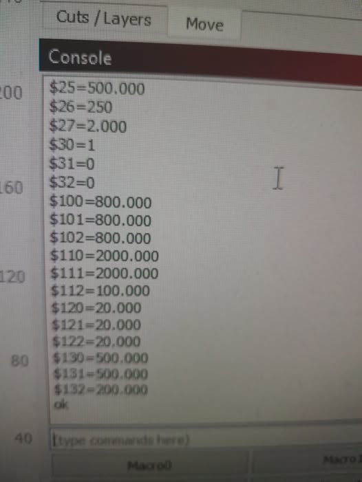

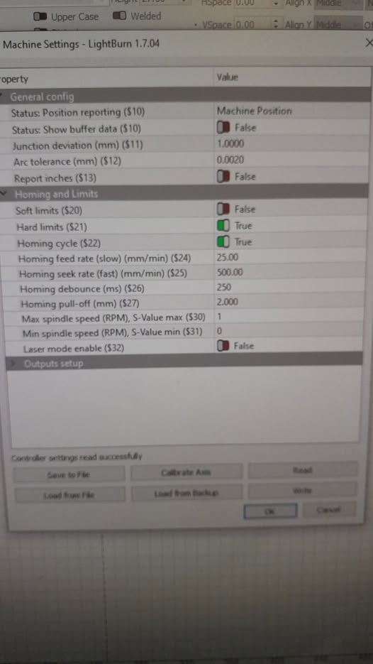

Does your laser $30 = S Value max?
Did you setup your laser as GRBL?
Type $I press enter
Type $$ press enter
in Lightburn console window and copy/paste here all the output.

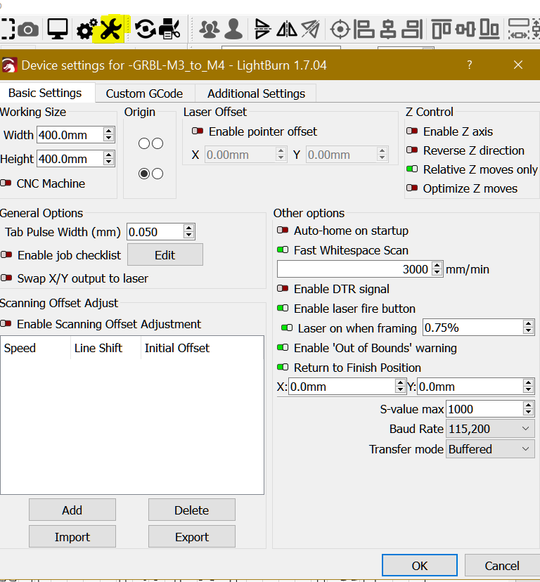

Also post a screenshot of your laser device settings:
s value max ($30) 1
You have to check Lightburn device settings S Value Max

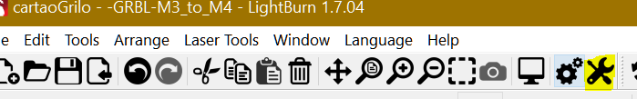

click the Tools symbol.

when i am putting these i have never touched these before I typed $I ENTER $$ ENTER
And the output for us to look?
