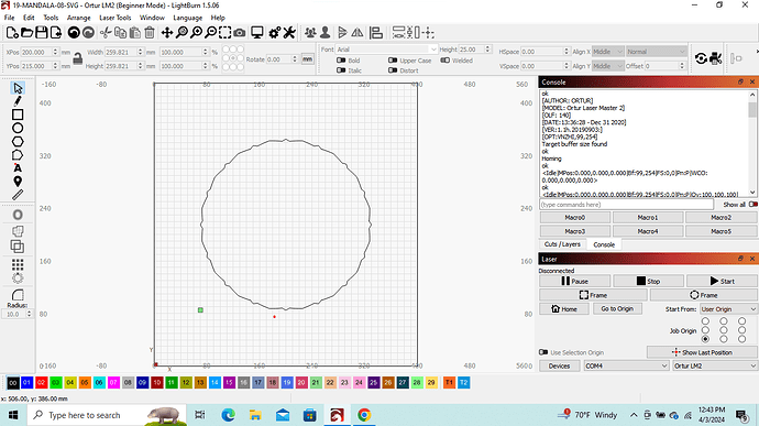

Why does my LM2 stop cutting just a few seconds short of the end of the cutting path. I have run the paths before without any problem but now the cut ends at exactly the same place every time I run it. doing this on ev every program and not specifically at a spot on the laser, just a spot for each program. Alarm3: Reset at step 0

I think that as the program runs, the last of the cut path is buffered to the laser controller and then a “reset” signal is sent out. Unfortunatley, the cut has not finished. Every program that fails does so in the same manner. even running a material test. stops somewhere on the last square of the grid before cutting out the outline.
Using a Toshiba laptop computer running Windows 10
Post please the following

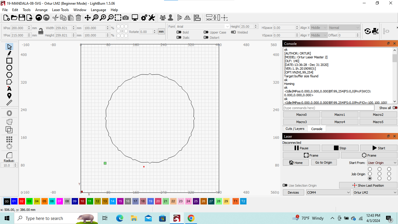

a) Image of your project open in lightburn

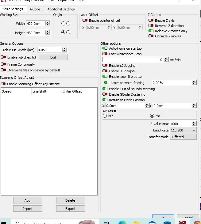

b) image of your Edit → device settings

19-MANDALA-08-SVG.lbrn2 (17.3 KB)
do a quick test with Absolute coordinates instead of user position, 1% power so you dont waste material.
You also need a update of firmware to 1.42
if i remember well there was a ltitle bug on 1.40 for vector work but should stop happening in absolute coordinates

however do that IF absolute coordinates fixes the problem Only
Absolute coordinates fixed the problem Thank you. Ill contact Ortur to see if I can get the updated firmware.
