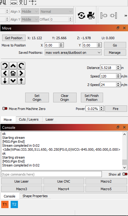

Laser won't accept Power lower than 1%
Hello Lazor ppl :smiley:
I have a little problem with my China Laser (its well made but you cant really tell what manufacturer)
Its not just in Lightburn, also LaserGBRL. Problem is, the Laser wont accept power level below 1%, it stays at 1%. Not that much of a problem, but for Framing it is. Since it is a 4x Diode Laser the 1% is already enough to leave marks.

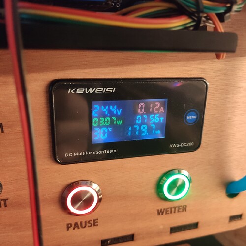

Everything above 1% seem to work fine. I dont have tools to measure the actual laser output, i just measured the power consumption of the Laser. And from 0,01 to 1% it stays the same. From 1% and up it raises.
I compiled my own GRLB Firmware and tried to find a solution inside the config.h but couldnt find any.
Anyone had a similar problem and was able to solve it?

Double check that S-Value Max in the device settings is the same as the $30 variable.
I don’t think you can get below the 1% value. I’ve never seen one of that will allow fractions.
All the pwm generators I’ve ever dealt with use whole numbers for the pwm generator…

You could increase $30 to 10000, and then 1% will be 0.1%
Still depends of course if the laser module will accept the PWM range, but it will test if the GRBL has some kind of floor on the number itself.
I’ve programmed the Atmel 386 and other micros… you can’t enter anything but a whole number in the registers that create the pwm signal … so how can shifting the range change it at the hardware level?
I’d like to understand your statements… I don’t see how you can go any lower than 1/max register value…
I can enter 0.1%, 0.2% and 0,3% and get different intensity from the laser, this correlates with GCode values of S1, S2, S3, since for me $30 is set to 1000.

I think thats it, the PWM Range of the Laser Module. After installing an Power measurement Display just for the Machine I could notice a very light diffrence between 0.01% and 1% of 0,8Watts.
Before that, I used a Watt-meter adapter Plug, it was to inaccurate I assume.
So my initial posting is wrong, it does accept low values. Problem remains the same, it burns :smile:

Theoretically, unless it’s an 8bit system, for the maximum resolution you can set your $30 and S-value Max to 1023, this means that for every 0.1% power in LightBurn you should be getting a different power level signal sent out from the GRBL control board.
Whether in your case the Laser module is receiving this signal correctly - and can use that full range to drive the laser is another question.
Maybe your laser module would work better if it was receiving the PWM signal at a different frequency? I think somewhere in GRBL the frequency can be changed? Mine is 1000Hz by default.

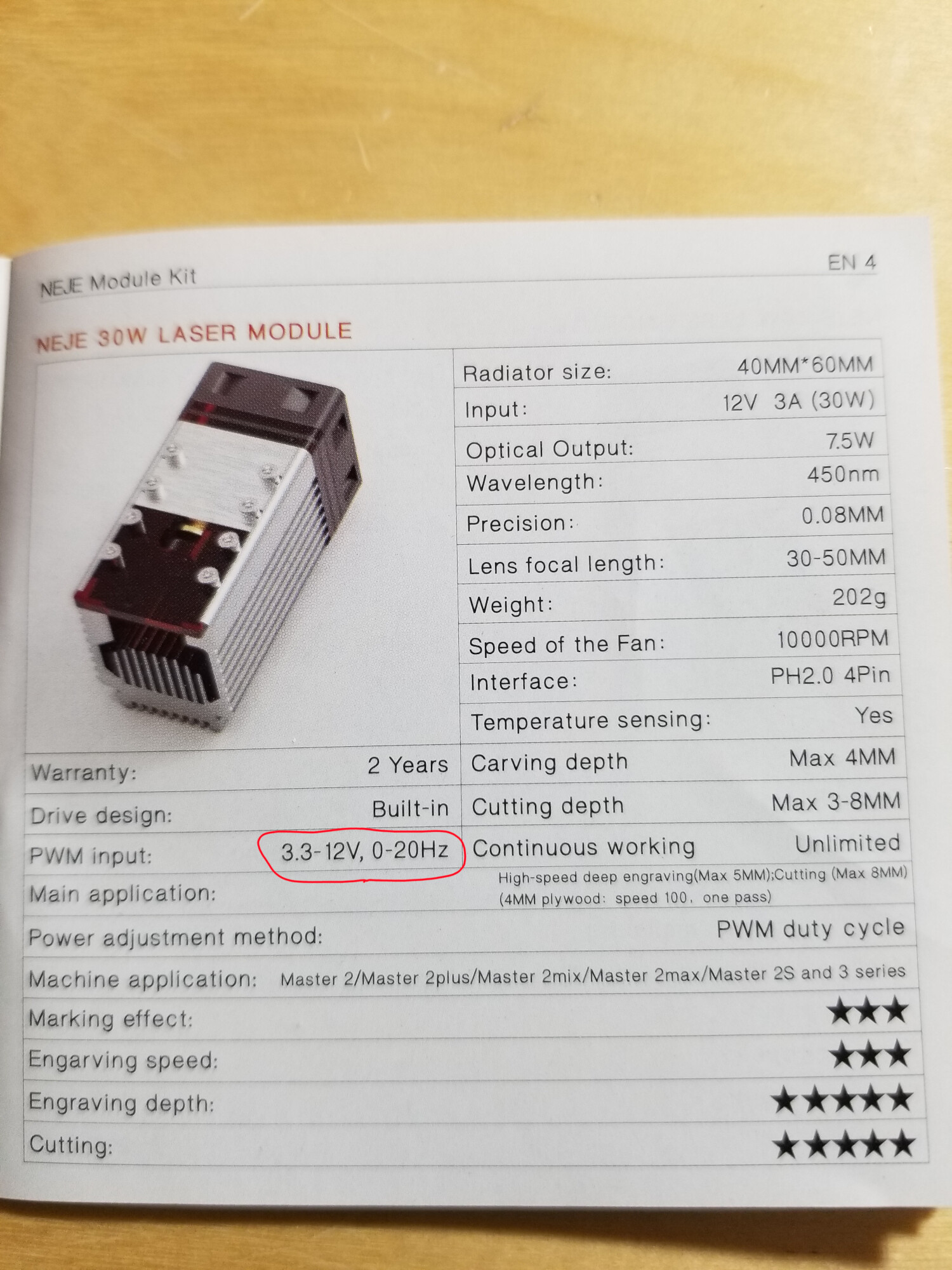

On a completely different note… this is my NEJE 40630 module… notice the pwm limits… :thinking:
I know many think it’s a typo… but is it?

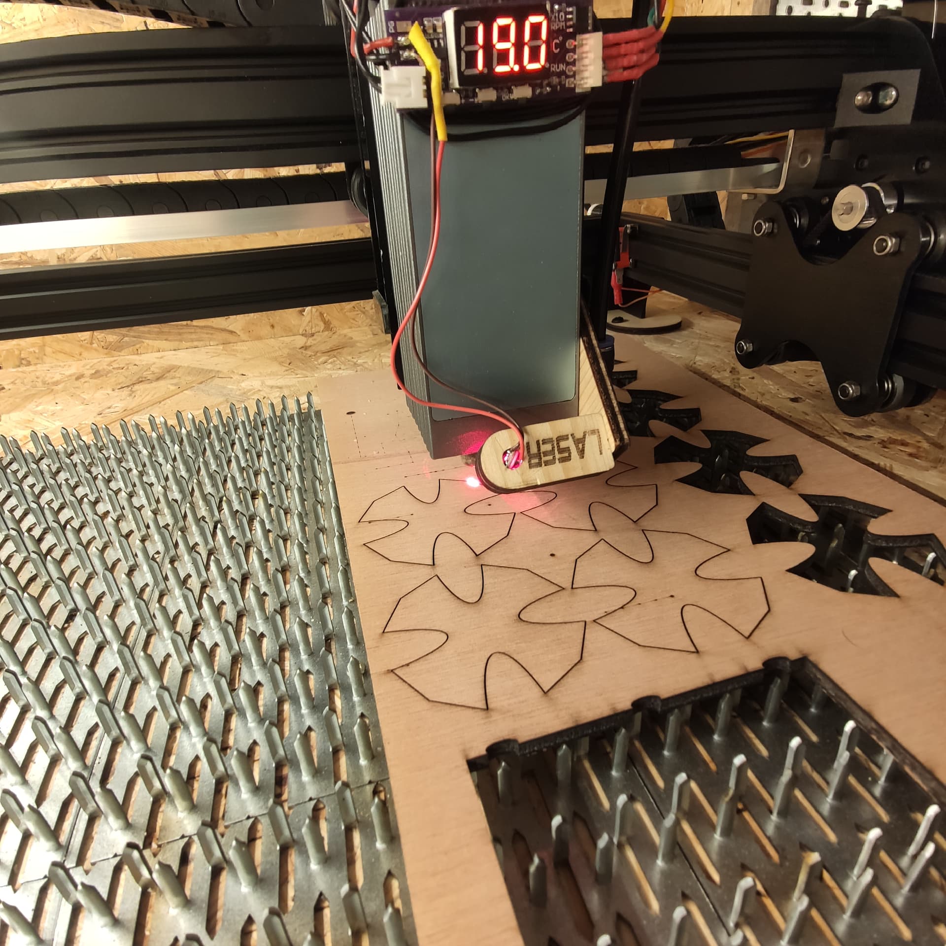

Not a solution but as a workaround have you thought of putting laser out of focus (Z axis raise) for the framing?
Hehe that was the final solution of the chinese seller. Works but not very satisfying.
