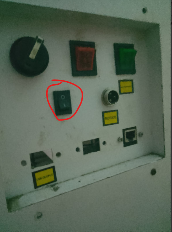

i cleaned the laser, noticed a loose cable, put it where i thought it goes, and the laser head isnt moving.
The machine does fire (hitting pulse), the machine connects to the PC. and lightburn detects it… i can make a shape and hit frame, but the laser will NOT move.

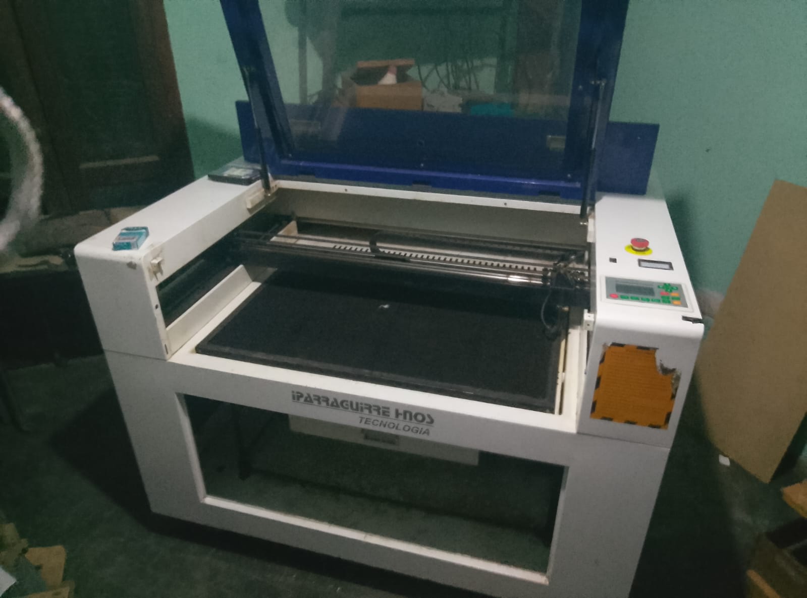

Its a 60x90cm 80w CO2, the peripherals (current stabilizer, air pump, extraction fan, and water cooler) all seem to be working fine, just that it will NOT move.
so ive taken some pics, perhaps you guys can detect something im not seeing.
i doubt both axis controllers would fail at the same time.

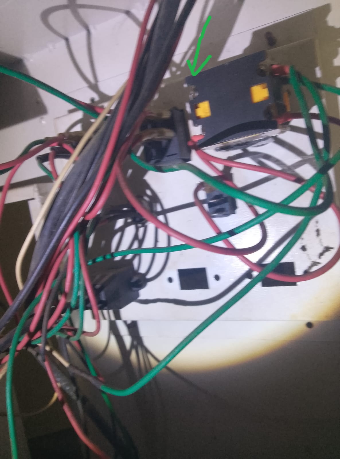

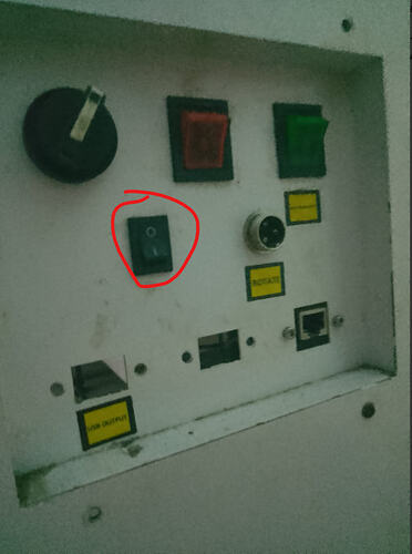

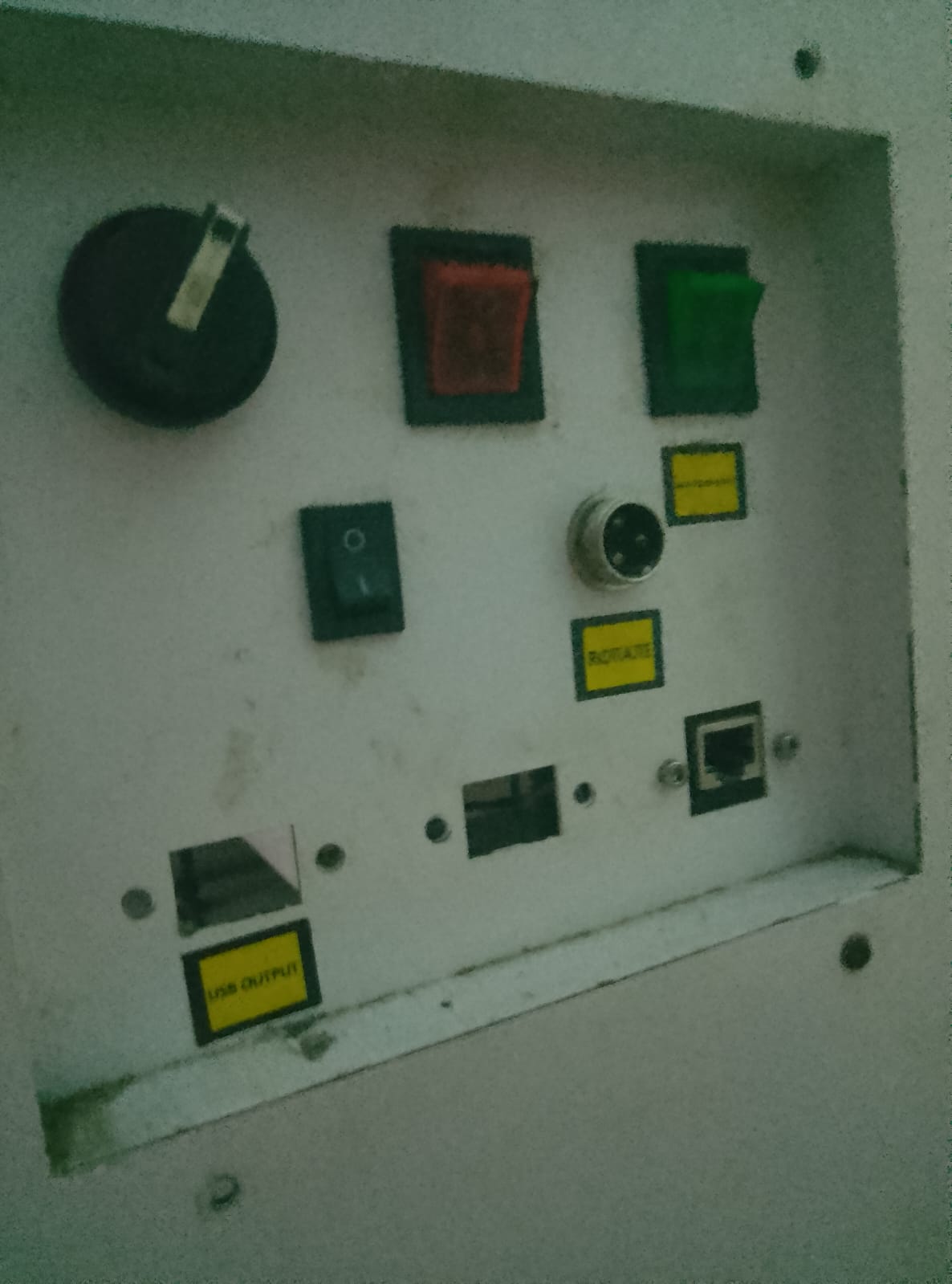

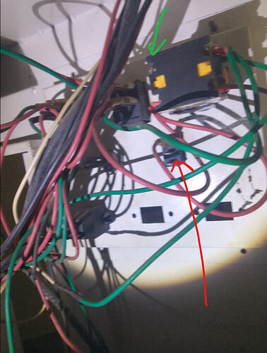

the cable i found loose, was a green cable, i stuck it in the main switch, the big yellow thing in the top right of the image, in the slot that had a loose screw, and no wires. (marked with an arrow)
i dunno, help!

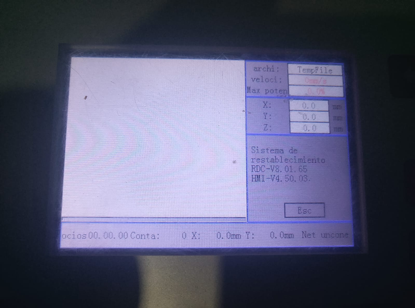

Here is a link to the video… of the controller (?) w the lights blinking… perhaps that helps diagnose the issue?

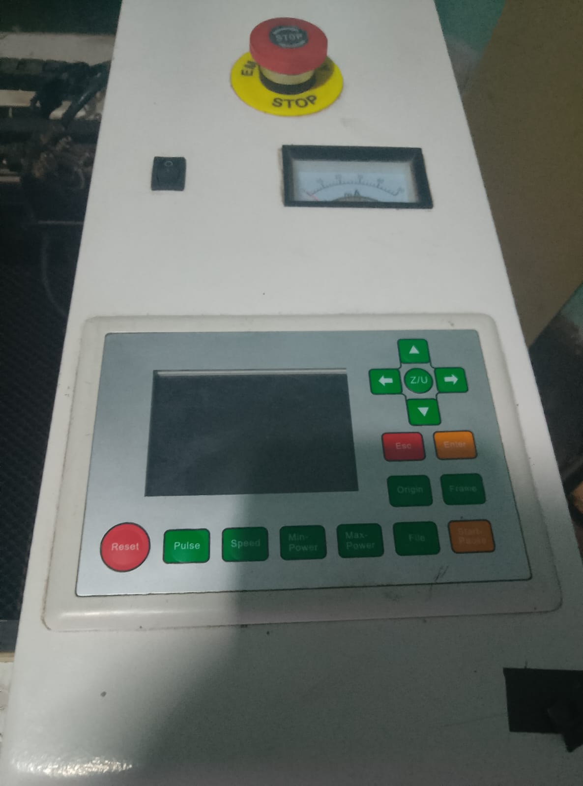

also, hitting the buttons on the ruida controller screen thing…. work
except the arrow buttons, the laser does NOT move. all other buttons do their job, like going into the files, or hitting escape, or pulse or whatever.
theres no reason, i guess, to think the arrow buttons are broken (and that lightburn isnt moving the laser head either)

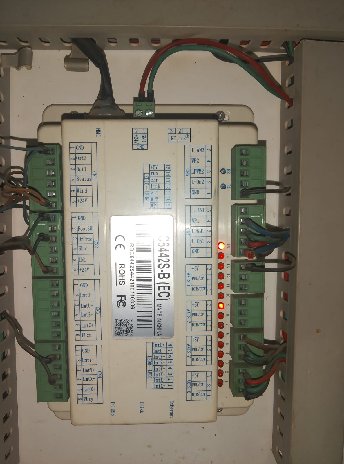

I see a possible water protect issue. LED 9 does it go off when you turn off the water?
mmmm water protection? but the laser head would still work, and hitting pulse shouldnt, id think?
Did it work before hooking the wire up? Where does that wire go? What does the switch control?Randomly hooking a wire up without checking is not something I’m comfortable with.
ok i restarted it…. light 14, the one that blinks… takes a bit to start blinking. 15 turns on immediately, 9 as well. I turn off the water chiller, and light 9 does turn off.
I read ur comment ¨not comfortable¨… yup! i was NOT comfortable either. The thing is the wire had a ¨metal post¨type connection. and the only thing that recieves that is the main toggle rotary switch,
it all worked last time i tried using it. i went on vacation, got back, and wanted to do a full cleaning and service. I cleaned it… turned it on, calibrated the mirrors… everything worked. that was light night. today… i go to use it, and it wouldnt move. i look and see the loose wire that appears to go to the rotary switch. the switch has 4 connections in the back. 2 have red cables.the other 2… one was empty with a loose screw and the other had 3 greens going to.
How does that happen with no cables in the controller’s PC-USB, U-Disk, and Ethernet jacks?
I’m serious: the controller has no connections to the outside world. If LightBurn is connected to a laser controller, it’s not this one. :grin:

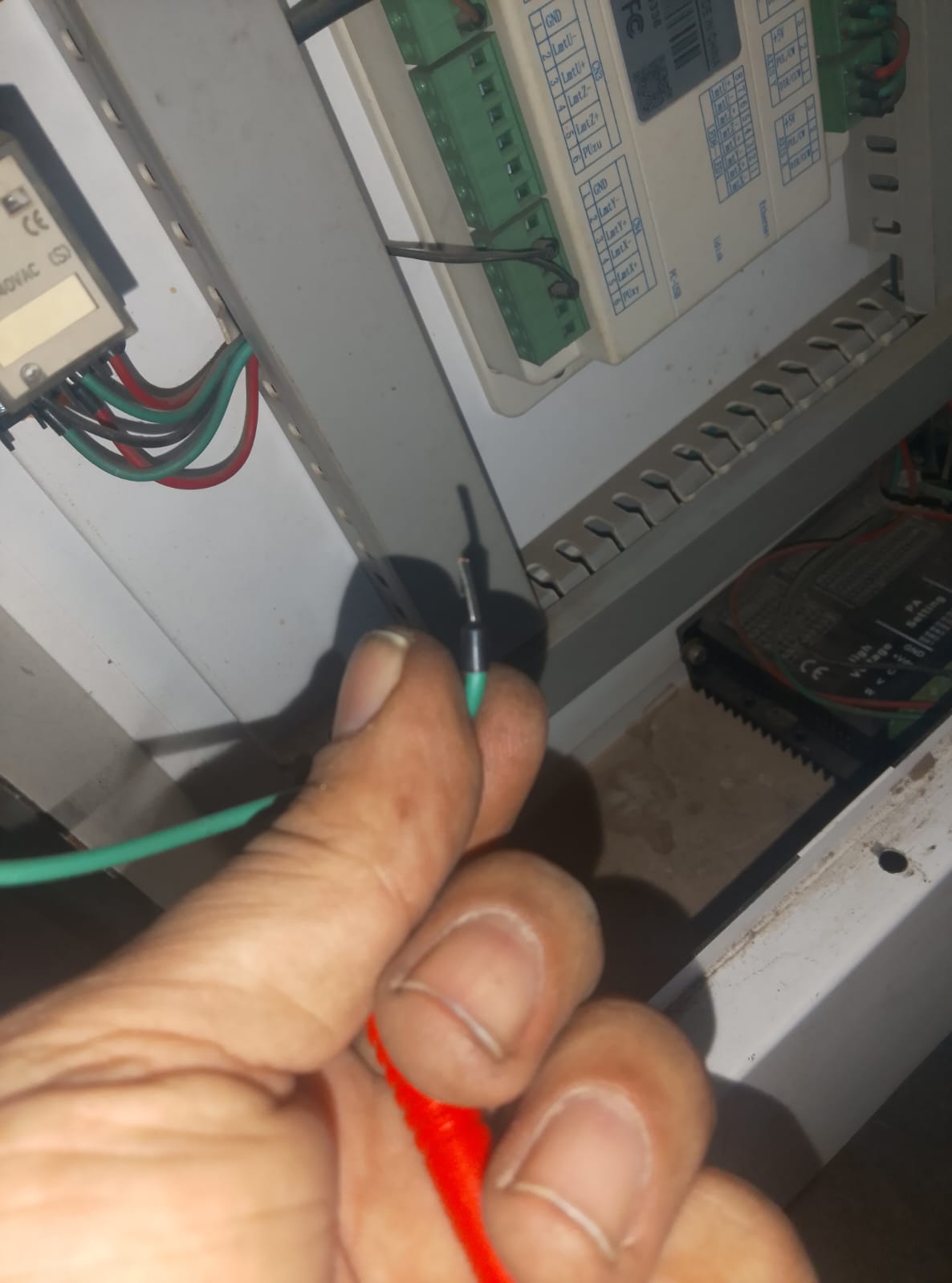

The stepper drivers for the X and Y axis have a green LED indicating they have good power and (maybe) a red LED indicating an error condition. For example, in my machine they’re near the top of the drivers:
What do they show in your machine? A photo will help us see what you see.

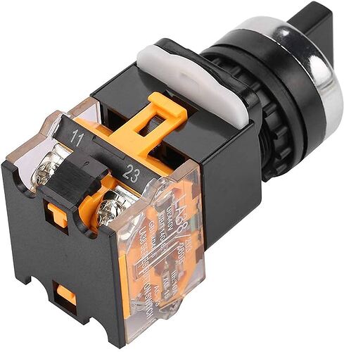

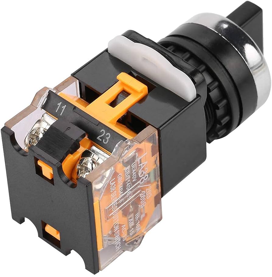

What does this switch do? It looks to only have 1 wire on it. Sorry for the dumb questions. I’m not familiar with your laser.
thats the rotary switch button, yea, the wire was loose, and i guess i took the pic while i had unplugged it to replace the terminal end.
Ok so… i checked continuity of the toggle switch, it seems to be working fine.

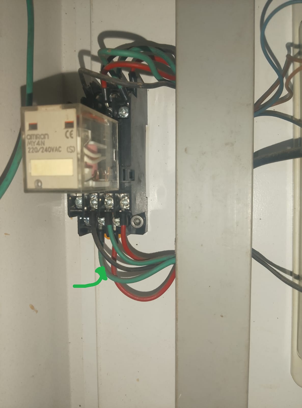

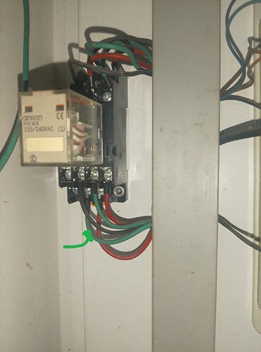

the green cable that was loose… i checked where it goes:
it goes to that crazy fuse looking thing, to the bottom, green, left cable… (theres 2 rows of 4 slots on top, and 2 rows of 4 slots on the bottom. its in slot 2, bottom, section, bottom row… green arrow in the pic.)
im going to grab a beer while i accept that this, laser problems and LB forums, has now become my friday night plans. you guys rock.
That’s what their green LED tells you.
That´s a relay that may switch the power for any part of your device (i.e. the stepper drivers).
It´s possible to mecanical override it to test if it doesn´t work and if that´s the case.
See https://files.omron.eu/downloads/latest/datasheet/en/j268_my-gs-r_my(s)_myk_myq_myh_miniature_power_relays_datasheet_en.pdf?v=6 on page #4
But be careful: Don´t bridge it without a hand over the emergency switch to not damage anything

On a Ruida, usually, when it’s illuminated it means active. So led 9 is Water protection input and it’s status is displayed on the leds. I think if you invert one of these, that hardware isn’t smart enough to realize that it’s been inverted by the user.
If you turn off the coolant pump or it fails, the led will extinguish. Of course, this makes the assumption that it’s wired up to detect this circulation failure.
These two tables on the Ruida identify which leds mean what.
Led 15 indicates you have 5V generated from the Ruida. Led 14 is the RUN led, it flashes after it boots, indicating it’s running.
Did you look at the motor drivers to see if the error led is lit?
