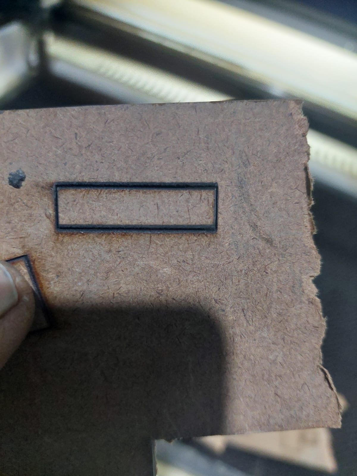

back left corner… (900,0) i go to cut a square, and the horizontal lines are THICK. (x axis), and the vertical lines are thin, as should be (y axis),
front left (900,600) and front right (0, 600) both have thin kerf lines.
and back right, (0,0), has thin kerf lines. Here i can cut with double speed and half potency as the rest of the work space. a 4mm MDF is cutting here at 10mm, 30% Power.
the rest of the work space is cutting at around 5mm, 50% power. Ive NEVER had to go so slow, or so high potency for this mdf before, or had such variation accross the workspace.
what could i have done wrong or overlooked? ive also never seen a kerf line vary in width depending the axis!
Ill get a pic to show it. its very unexpected.
thanks guys!
kerf variation in x and y routes:

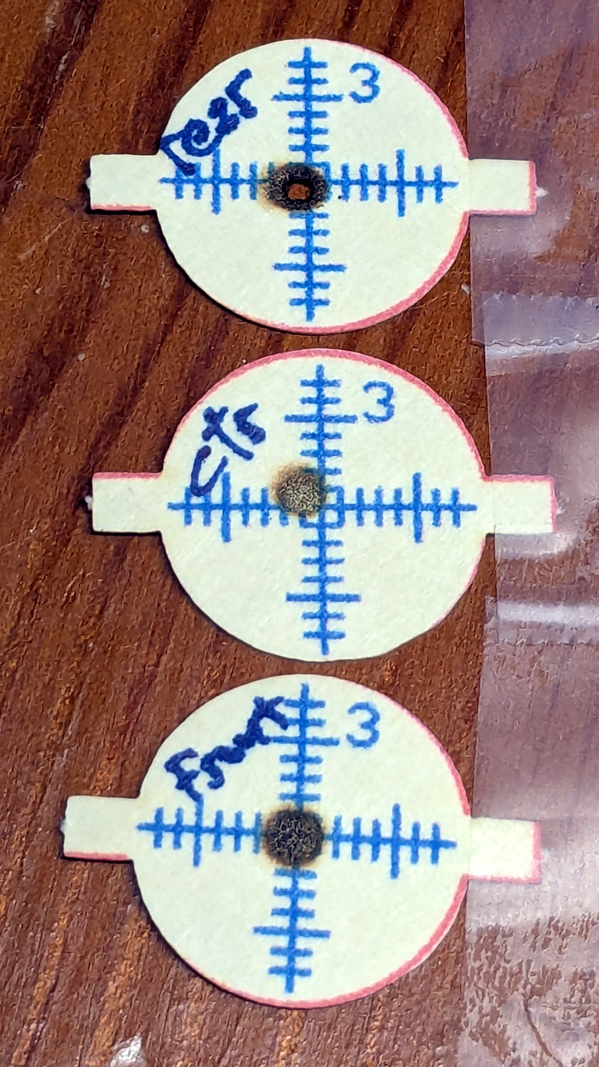

Most likely, the beam is not at the middle of all three mirrors over the laser head’s entire range of travel, so it hits either the edge of a mirror or the edge of the nozzle.
I use manila targets to located the beam at each mirror:
Verify the beam position on the mirrors at both ends and the middle of each axis, then check that it’s in the center of the focus lens and the nozzle:
While you’re in there, make sure all the mirror lock rings are tight and the focus lens is installed with the flat side down and the lock ring snugged on the silicon O-ring.
The next possibility is that the tube is not resonating in TEM00 mode, so the beam cannot focus correctly. A previous discussion describes what’s going on and how to check for it:
All that may seem tedious, but when you’re done you can show off the targets to prove the problem lies elsewhere … :grin:
