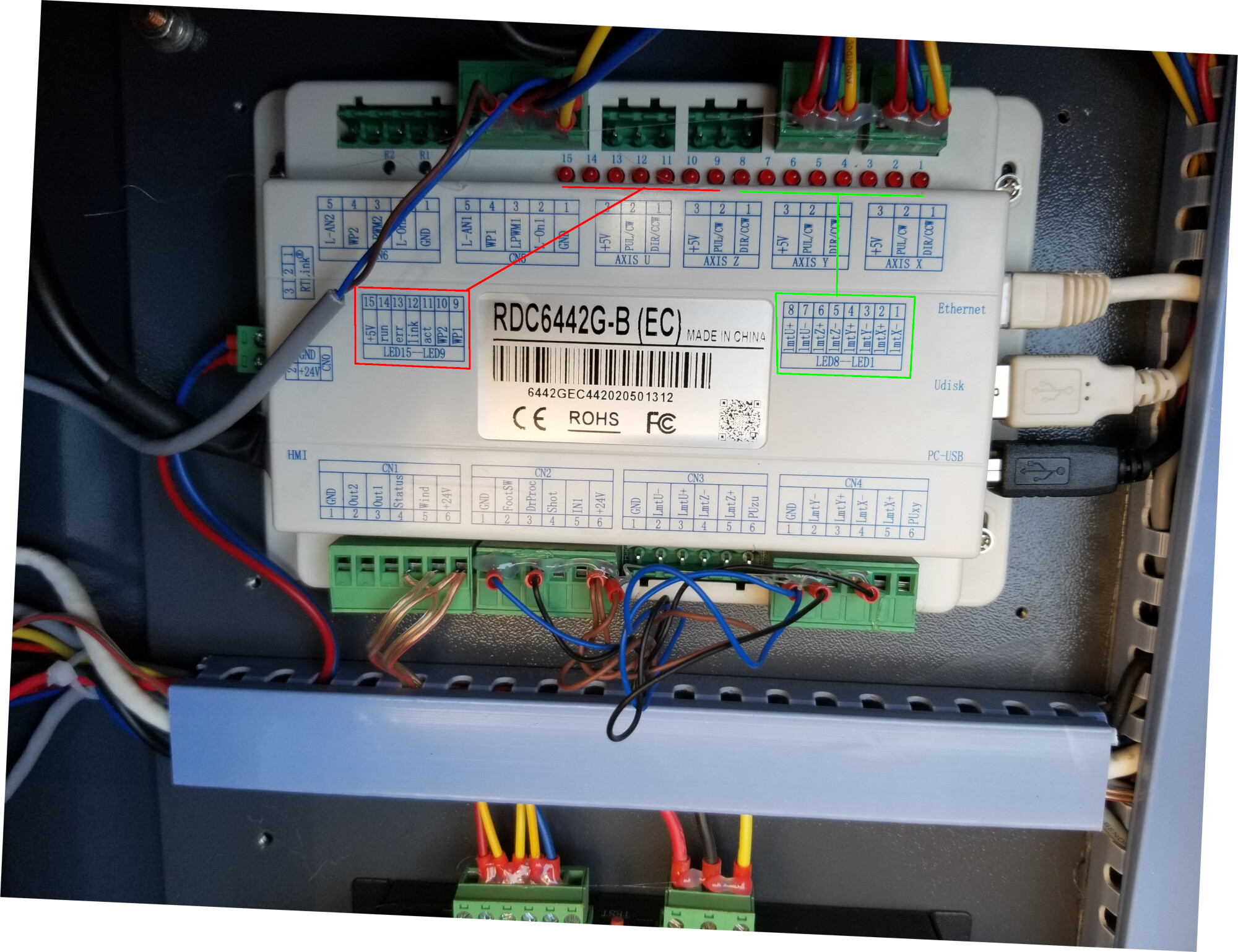

Laser wont move, i need to work! Lightburn is never the problem!

On a Ruida, usually, when it’s illuminated it means active. So led 9 is Water protection input and it’s status is displayed on the leds. I think if you invert one of these, that hardware isn’t smart enough to realize that it’s been inverted by the user.
If you turn off the coolant pump or it fails, the led will extinguish. Of course, this makes the assumption that it’s wired up to detect this circulation failure.
These two tables on the Ruida identify which leds mean what.
Led 15 indicates you have 5V generated from the Ruida. Led 14 is the RUN led, it flashes after it boots, indicating it’s running.
Did you look at the motor drivers to see if the error led is lit?
