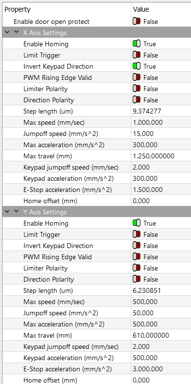

  • Screenshots (not phone pictures) of the Machine Settings values for the X and Y axes

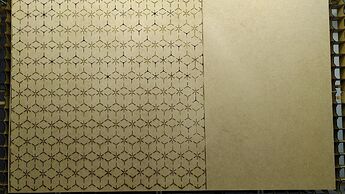

Cut overview\Detailed Photo and Machine Settings are attached
The Intersection of those two red lines should be ‘L’
But as you can see it is about 10mm of in the Y direction
The Closeup is roughly the red Square.
These are the Settings for the second Cut with 10x slower accelerations.
For the previouse cut I used X-Max Acc 3000mm\s², Y-Acc 50000mm\s²
Contrary to what I expected, LightBurn doesn’t go through the image in a consistent direction, but it does draw most of the patterns while traveling along the X axis.
What’s significant:
  • Very few of the six-point shapes are misaligned in the Y direction and those few aren’t off by much
  • The three-point shapes generally have a single misalignment at the far left or right end of a line, then the rest are consistent
Scrubbing through the Preview suggests the misalignments happen when the head moves to a new row and starts drawing a three-point shape.
