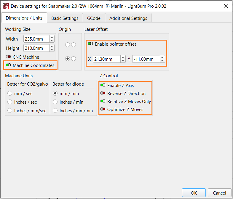

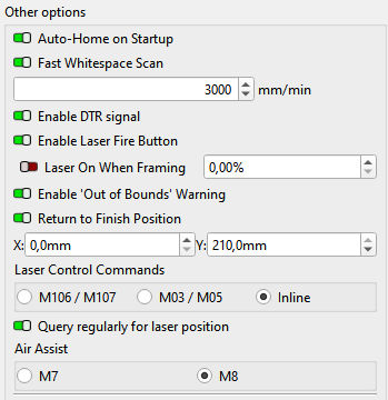

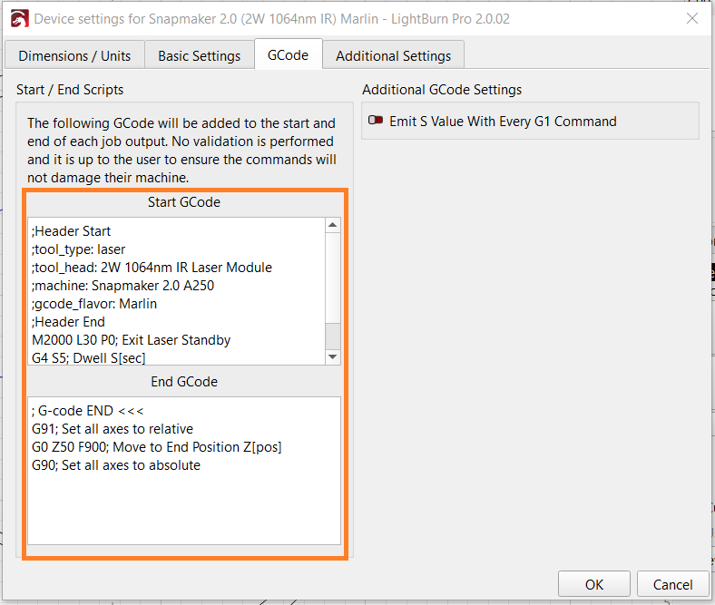

Hello Burners!
After some other work (many thanks to my lovely wife :wink: ) I found the time to do additional testings with the Snapmaker and Lightburn.
I created a new device from scratch:
Device: Marlin
Name: Snapmaker 2.0 (2W 1064nm IR) Marlin
Units: mm/min
Size: 235 x 210mm
Origin: Front / Left
Device Settings:
Important settings:
Dimensions
Important to use Machine Coordinates, Enable pointer offset and Enable Z Axis
Basics:
Usage of Inline laser power control and M8 for Air Assist.
GCode
Some additional (mostly comments) as Start- and End GCode.
The Basics setting window needs to be enlarged a bit to get the Laser Control Commands and the Air Assist section visible! (<- Bug?)
If someone want’s to review or test the settings, I attached the device profile here.
Snapmaker 2.0 (2W_1064nm_IR) Marlin.lbzip (2.2 KB)
Currently it seems all is working as expected (Get Position, Move commands, Macros, Start button…).
Machine: Snapmaker 2.0 A250
FW: 1.20.3
Laser: Snapmaker 2W IR
LightBurn: Pro 2.0.02
If any additional information is required, please don’t hesitate to contact me.
Many thanks and happy sizzling, :sparkler:
Jörg

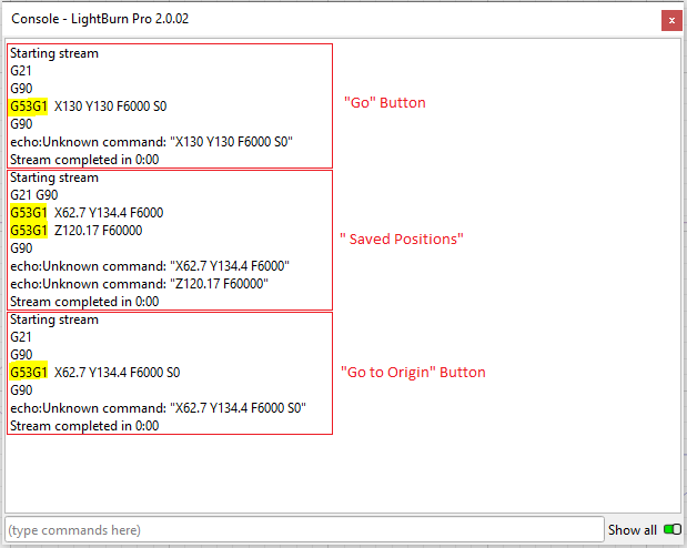

Hello from my “underground”,
I’ve done some further burnings now and found an additional issue with LB together with my Snappy:
The Go and Go to Origin button as also the Saved Positions movements are not working, because of the transmitted GCode. In case of pressing the Go button the device returns
Starting stream
G21
G90
G53G1 X130 Y150 F6000 S0
G90
echo:Unknown command: "X130 Y150 F6000 S0"
Stream completed in 0:00
If I use the console command G53 G1 X130 Y150 F6000 S0 (with a space between G53 and G1) the move is done as expected.
So, it seems LB has a small bug with the commands in the move tab.
I’ll try to open a case for this issue soon.
Jörg
You sure you do not have this in the GCode window? I did not see all of the commands listed.
GRBL does not allow multiple Gxx commands on the same line. Is GCode Clustering turned off?
Hello Mike,
many thanks for your answer!
And yes, this is exactly the output I get in the console window if I use the Go button.
You mentioned if the GCode Clustering is turned off. Currently I’m using Marlin as device controller. So, I assume, due to this I don’t have this switch available in Basic Settings.
If I use the command G53 G1 X130 Y150 F6000 S0 (with the space between G53 and G1) in the console the command is executed and acknowledged by an Ok.
Jörg
Hello again,
to get some visibility to this case, here’s a screenshot of the console window if I press Go, Saved Positions and Go to Origin Buttons:
Jörg
We are at the point that I am sure it is a software issue, apparently Marlin specific. Those last images, and your statement that having a space works, show this needs to be escalated by @JohnJohn at Lightburn.
Thank you for being patient with me. I am not a Marlin guy, so it took me a few postings to figure it out. :nerd_face:
