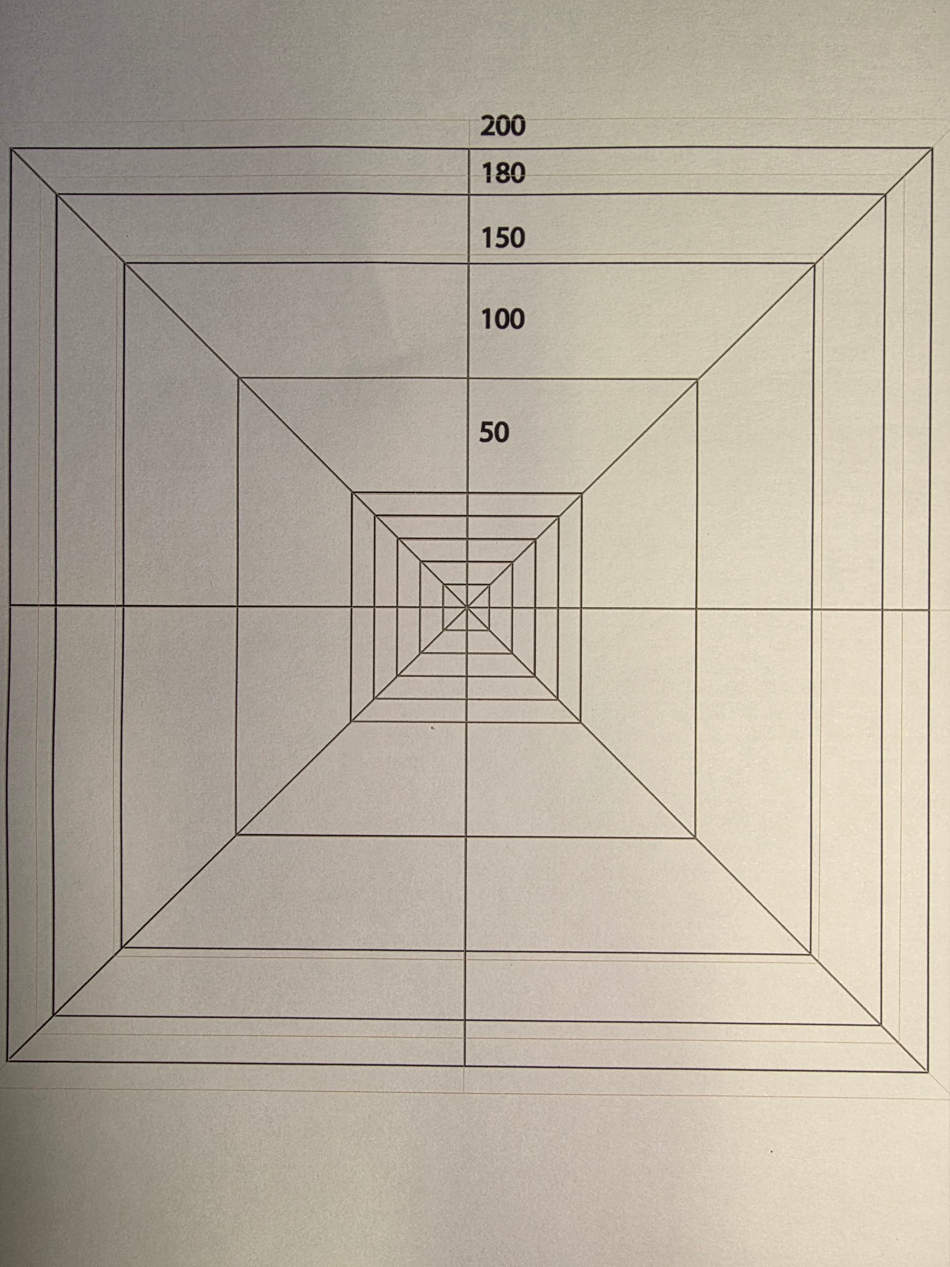

I’m using the new ComMarker Omni X which I believe has a BSL board.
I managed to get the 250mm lens pretty square but runs into this scaling issue.
The referenced 200mm box is spot on, but subsequent smaller boxs are off by more and more.
Is anyone else running into this issue?
Can it be fix?

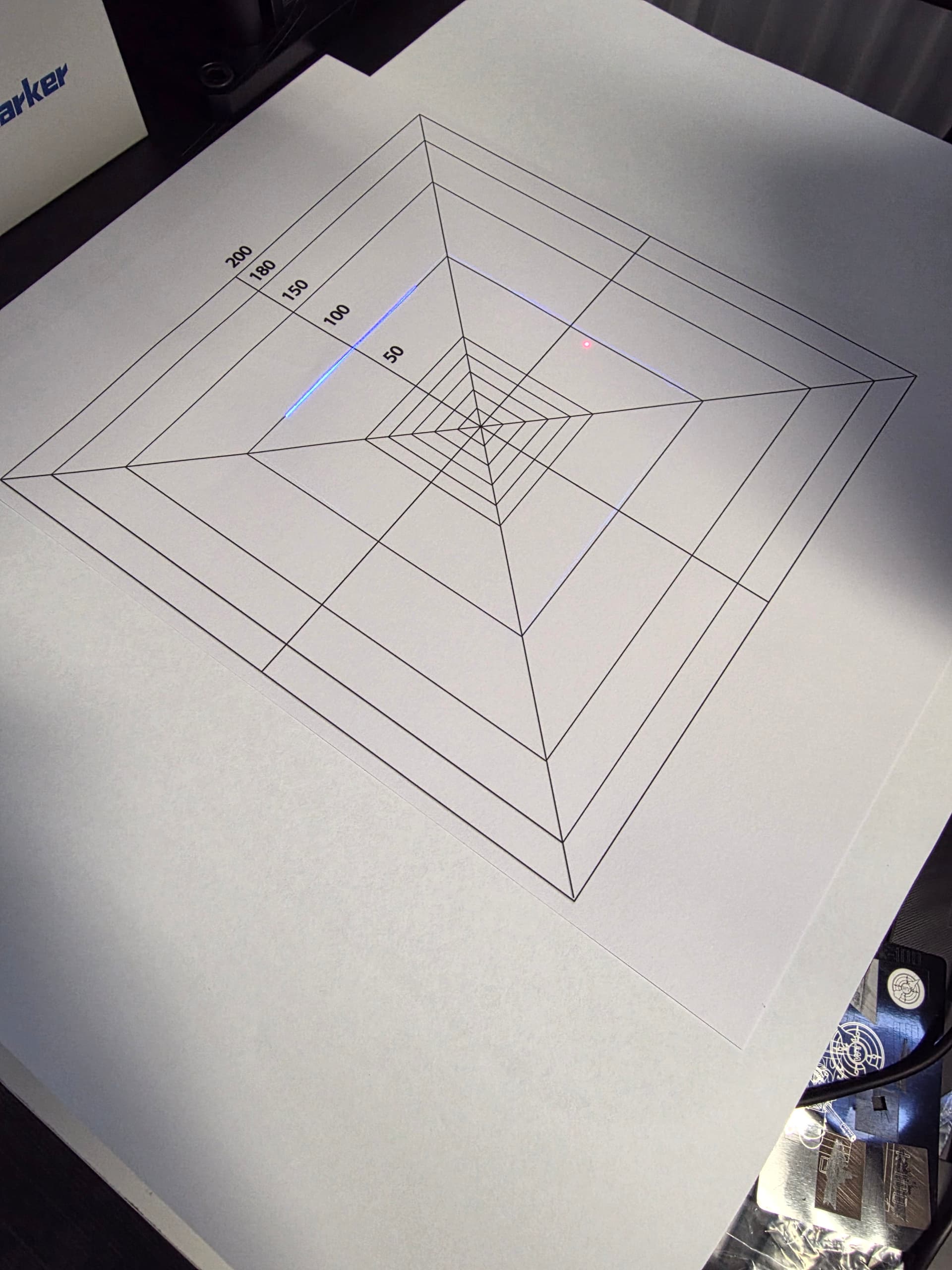

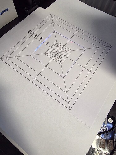

Try setting it up at 100 and then check 50 and 150, 200
This is peculiar.
The test suggested by Albroswift could be revealing.

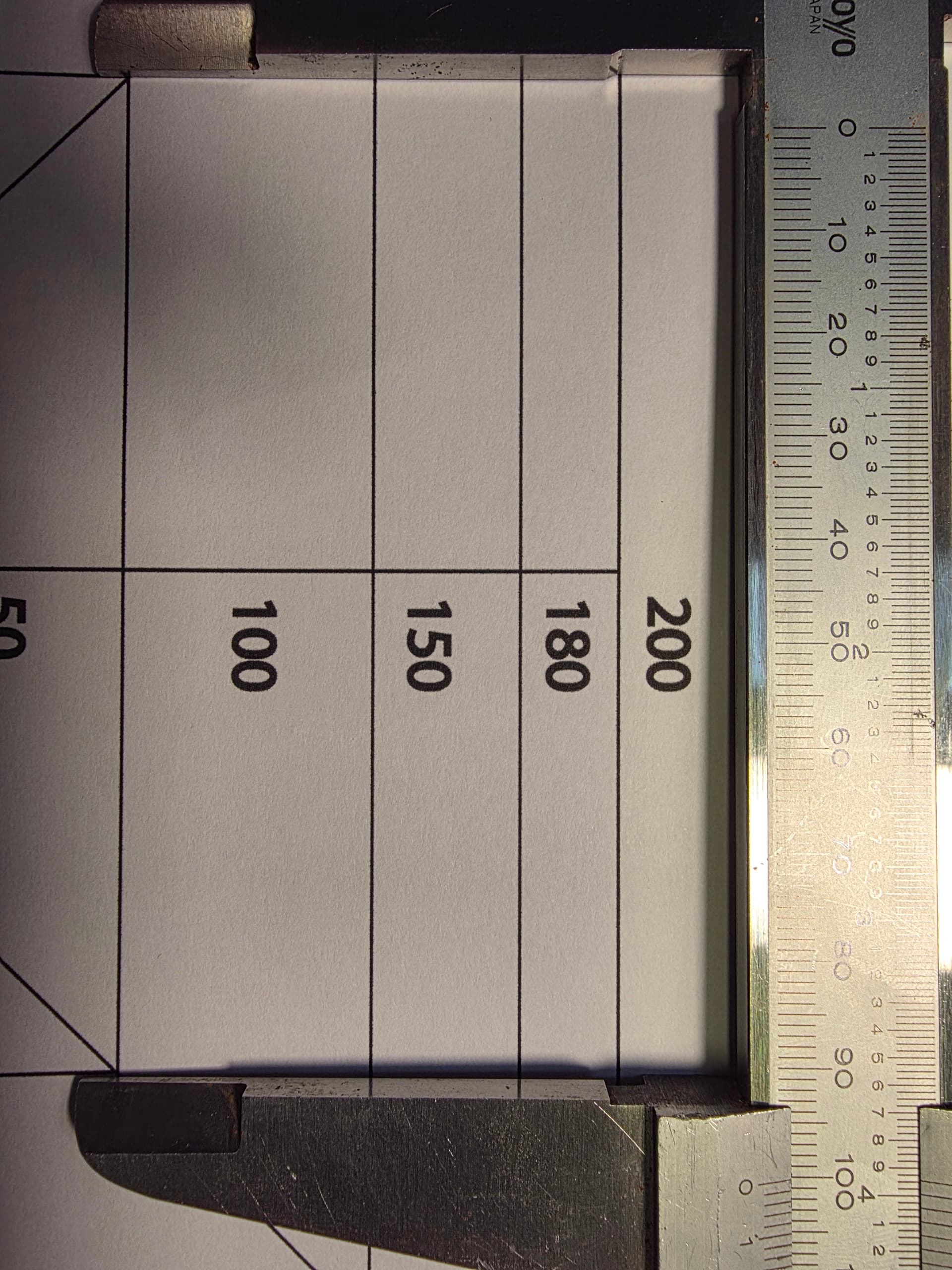

Just as a sanity check: Can you verify the dimensions the printed rectangles with a (calibrated) tape measure?

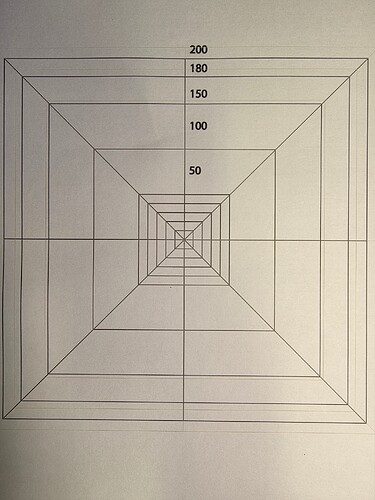

Setting proportion to align with 100mm resulted in 50mm and under being pretty good. Still a bit off, but usable.
However, 150mm and above are still out.
Printed squares are the size labeled.
