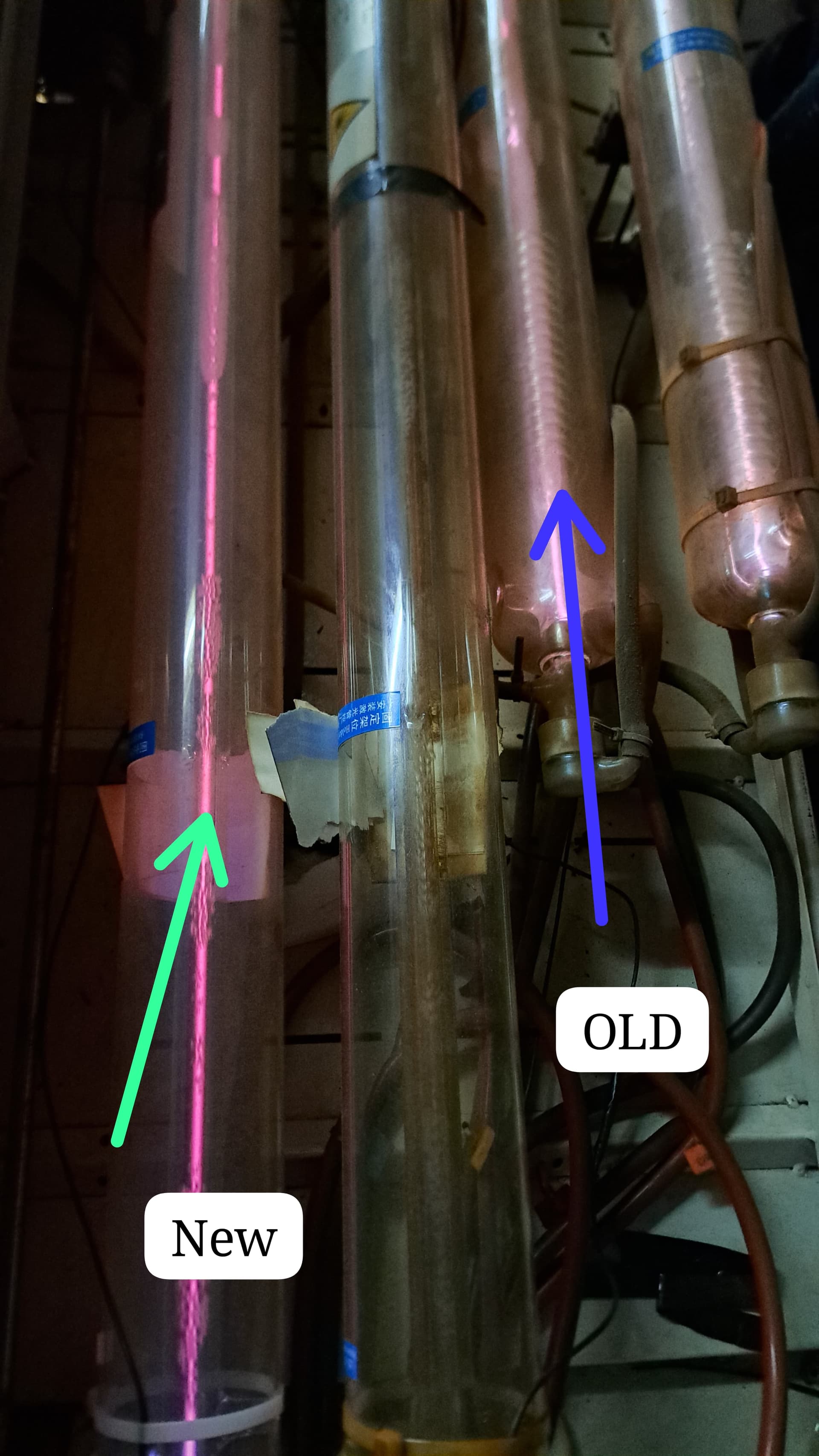

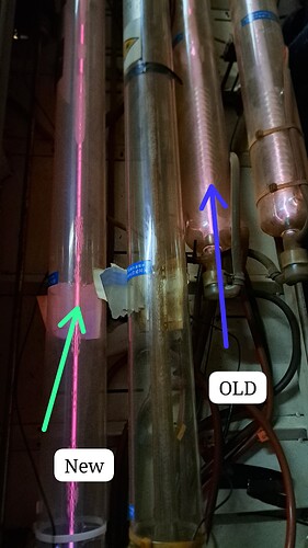

Hello friends, I come to fill myself with wisdom. In our machines we have observed deficiencies in the cuts, solving by changing to a new tube. My questions are. What parameters can I observe when the useful life of my tube is already fulfilled? If they are 170 W tubes, how long is the useful life working an average of 12 hours a day. Thank you very much in advance.

A CO2 tube usually does not die from one day to the next and you will be able to compensate for a given time for the tube’s deteriorating effect by turning up the output effect on the machine. But it only goes in a bounty time. Something completely different is it if the tube is not in TEM00, then most often it cannot be used (for production) anymore.
The lifetime depends very much on how the tube has been treated. Has it always run on max effect?, Has there always been the right cooling without air bubbles?
The max effect on my nominal 60 watt tube is about 18ma which corresponds to 65% in LB, then my tube doesn’t give extra power, no matter how high I set it. I stick to the limit and think my tube is fine for the additional 1-3 years. But I don’t produce as much as you at all, I have effective 4 hours/day laser operation and in summer I mostly hold a 2 -month vacation, in this league I play.

Hahaha, they only look dirty on the outside, we are changing the drinking water for demineralized water with refrigerant, the hoses are purged. Just like the chiller tanks. Generally we produce 120 pieces per day per machine, the cutting cycles are 12 minutes, with 20 mA.
