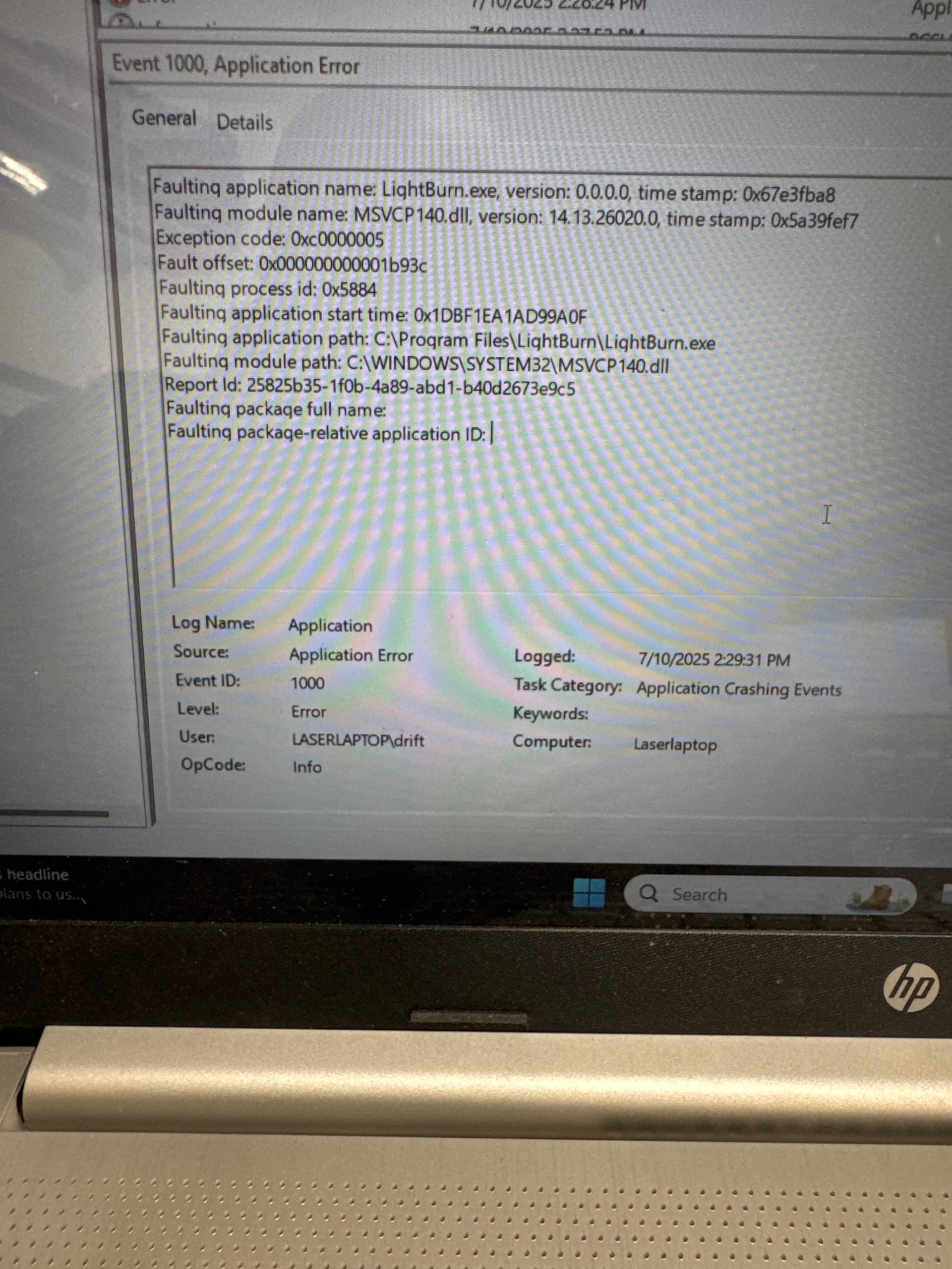

Went to open lightburn this morning and it won’t open. I just updated it to the new version the other day. I tried reloading the 2.0 software, I tried uploading the old 1.7.08 software, I updated the C++ redistributables and reinstalling the software…. Nothing. The pic is what the event views is saying.

Please follow the steps described in this forum post.
Recent Windows updates have been known to roll back C++ Redistributables, which LightBurn - as well as other programs - need to correctly function.
Let us know if that worked for you.
