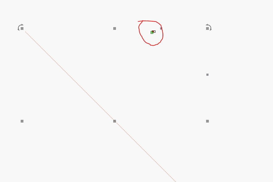

I drag a line. Rotate 45deg. and it’s in the middle of nowhere.
Don’t understand that comment.
This is my work area.
Where do you have the ‘9-dot’ selector set? If I select the center dot, then type 45 into the ‘Rotate’ edit box, the guideline rotates around the center of the line. Yours may have been set to one of the ends as the rotation point. :slight_smile:

Ok, getting the hang of it. The 9 dots never seemed to have an effect when I would rotate a line etc.
Ahh… I was rotating with the comma and period.
If I deselect the center of the nine-box and use the Rotate Field to rotate I get what you are seeing.

I believe those rotations are fixed, and set to rotate around the center. Double-checking this…
Yes, that’s how they’ve always worked for me. Found it odd they didn’t spin around those anchor points.
That’s why I dug deeper into the rotation 9-box and realized it only worked with the input in the field beside it.
Would be a good enhancement to work in a logical manner. But my logic and someone else’s usually aren’t the same.
I click on different dots but everything rotates around center. I don’t find documentation on them. I thought they were supposed to control where when you grabbed something and rotated it , it would rotate around that dot axis.
So now I know when the 9 dots work, kind of seems like it makes two-point rotate redundant.
