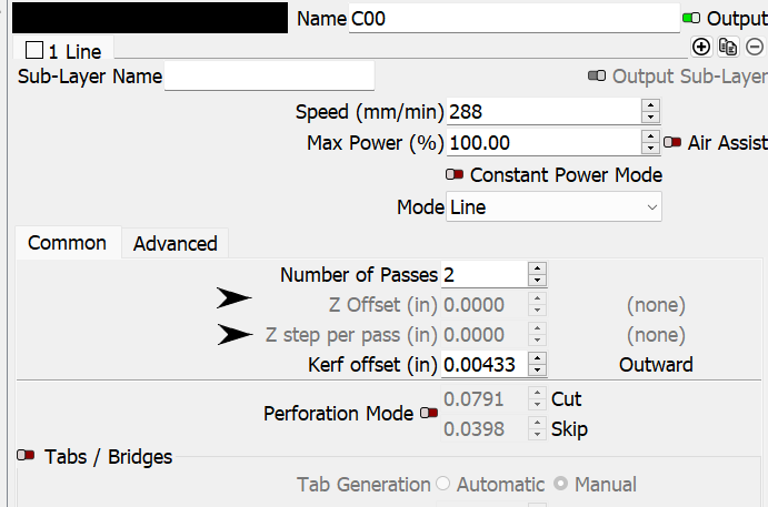

Thanks. I enabled it after 15 install. But no go. Supposedly a ā€œMaterialā€ option is to be added to the drop down Menu where ā€œline and fillā€ are found for selection.
Disable Relative Z Moves only. That will show you the material height setting.

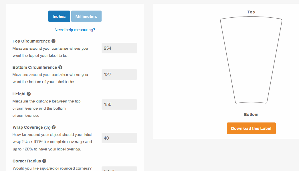

Issue with Taper module. I’m inclined to believe it’s rendering the taper upside down.
When a round or square image or vector is placed on the taper (where the taper is larger* at the top), the burning size is compensated to be larger in distance/circumference/diameter. This is so that when it is looked upon directly it appears to be a perfect circle or square.
Having a larger rendering at the bottom, as in LightBurn 1.5 demo, would make it wrap way too far around at the bottom of the image/vector at the lower portion of the tumbler.
As mentioned in a previous post, I do have Silhouette Business Edition that I’ve used in the past. Also, to confirm my findings, I’ve been playing around with other online taper conversion software. All of the others show the stretch to be larger at the top than at the bottom.
*FWIW, most tumblers are in fact larger at their tops, but I do have a coffee mug that’s much larger at the bottom to be used while boating. It’s a neat mug, but I digress…
Anyway, see attachment:
All were created with the same dimensions. However, some apps are done in diameter or circumference so I had to convert accordingly. Don’t let the differing numbers fool you. They’re all the same. Having said that, some apps generate a template that requires you to manually stretch your object. Horrible situation but apparently some have no real issues getting satisfactory results.
Taper Comparison.lbrn2 (426.0 KB)
By golly, your right. It is upside down.
Noted and verifying now internally.

Hi Steven,
I occasionally have to print tapered product labels and understand your point but in Lightburn you are not printing a label that wraps around a container, you are printing directly onto the container. The two processes aren’t dimensionally inversed but the direction of compression and expansion are directionally inversed. if you look at the top and bottom lines of the Silhouette taper you will notice that the lines are curved to compensate for the pitch of the taper and the curvature of the container, the Lightburn taper doesn’t have that curve.
edit: I should have said this first, The rotary isn’t rotating on the center axis, it’s rolling around on it’s circumference and printing directly onto the container.
I’ve confirmed that the Taper Warp is to account for the warpage on tapered tumblers. If the tumbler has a smaller radius at the bottom, the bottom of the design needs to be stretched to correct it, so this feature is acting as intended.
How about this…
As the glass rotates, the upper moves XX.x mm. the bottom, being smaller, has to rotate farther to cover the same XX.x mm linear distance. So in a sense, the bottom is stretched to get that extra distance.
Make sense?
Now that you’ve provided that explanation, yes it does.
