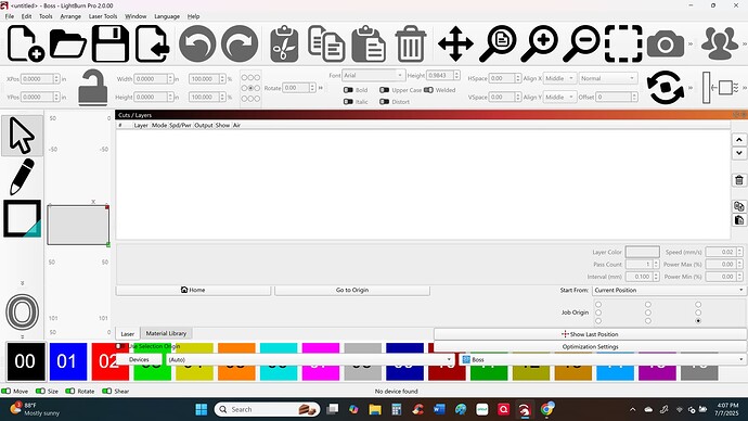

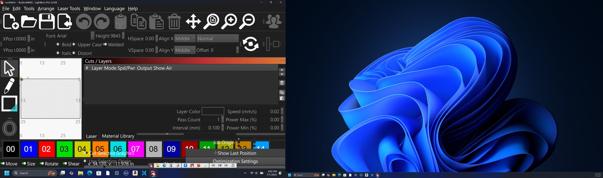

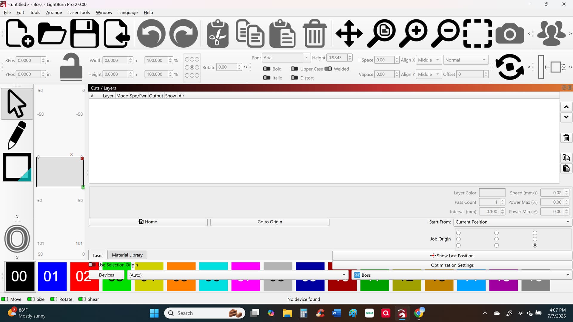

The pop up came on my screen asking me to upgrade. Not a good choice. Can’t even use the program now. Everything is screwed up, proportions are out of whack, no place to revert to previous version (which should be an option). Please run beta testing before putting these updates out - I was able to revert back to a previous version I had on my computer (thankfully). Here is a screenshot of what it did to my screen, as you can see - color codes are out of whack, no place to even include your file because everything is out of proportion.

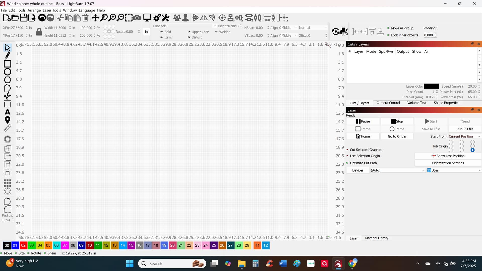

I upgraded to your recent version. I was using version 1.7.07 which looked like this. I didn’t change anything except upgrade to your new version.
and that was a screen shot after I reverted back. everything looks fine. If I download your new version it just automatically looks like the screenshot I included.

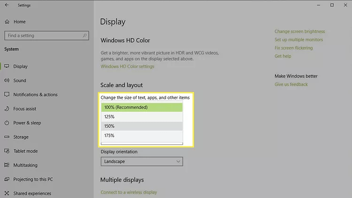

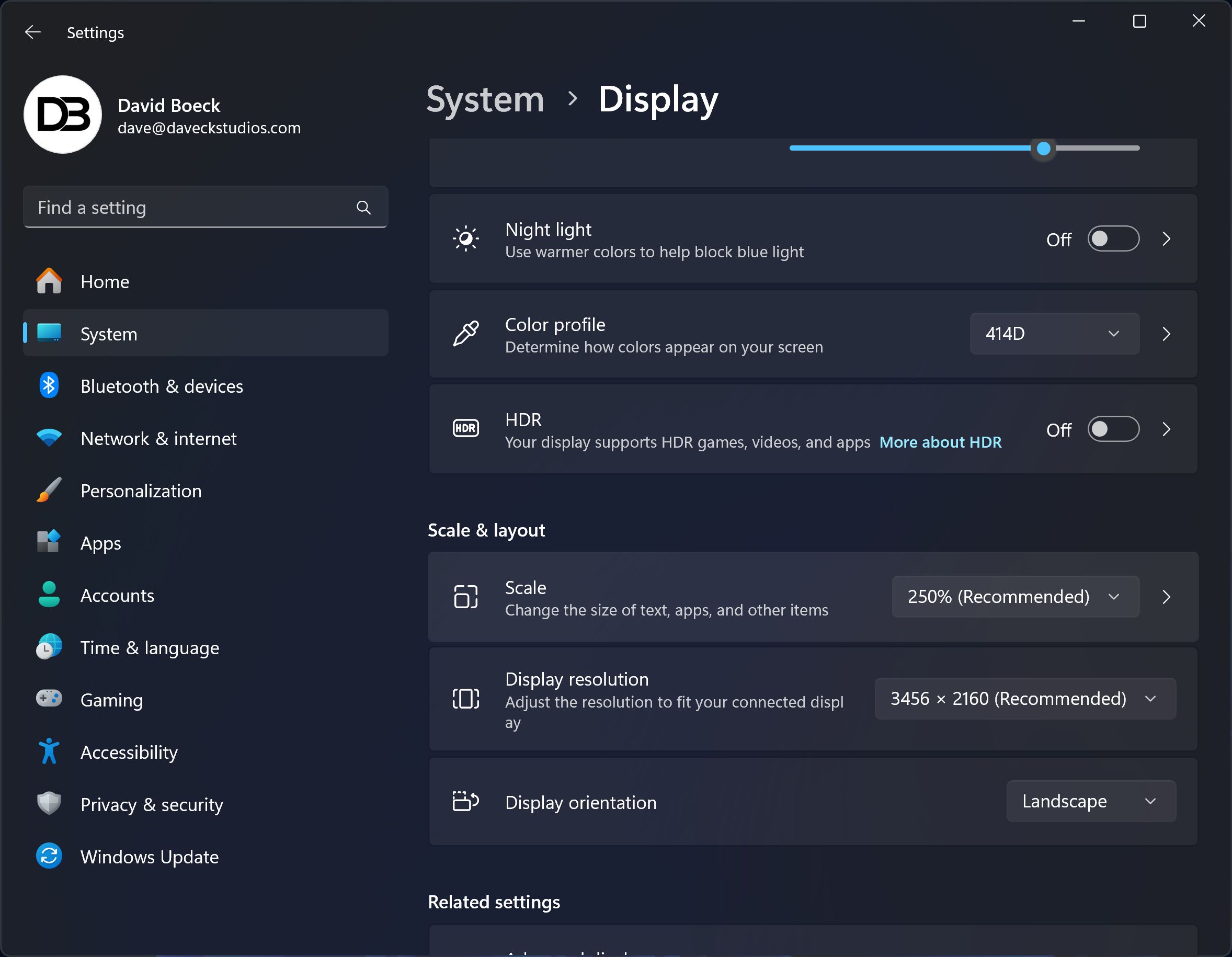

Also on your windows
Navigate to Settings > System > Display.
Under “Scale and layout,” you’ll find the current scaling percentage
Can you tell us what it is set at?

Your 250% scaling might be changing things

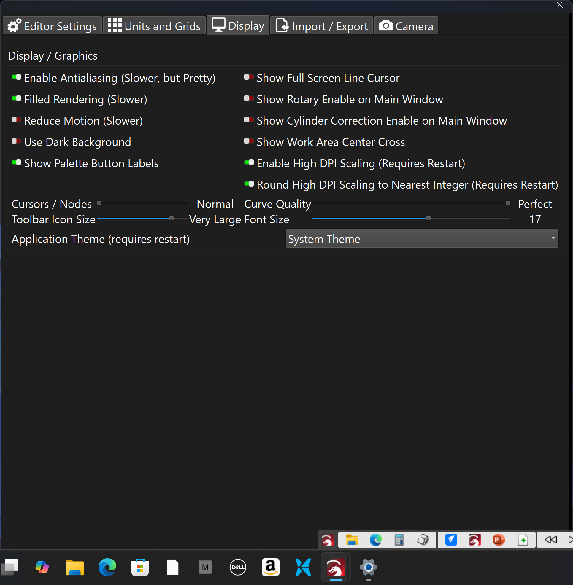

Screenshot of Lightburn display settings before…
Also show it is in the dark mode now, was light mode before.
Try this for me
Set Toolbar Icon size to - Normal
Font size = Default
system Theme = Light
(your windows is set to dark mode, so LightBurn will try to mimic)
Will that set your icons/text correctly as it was before?

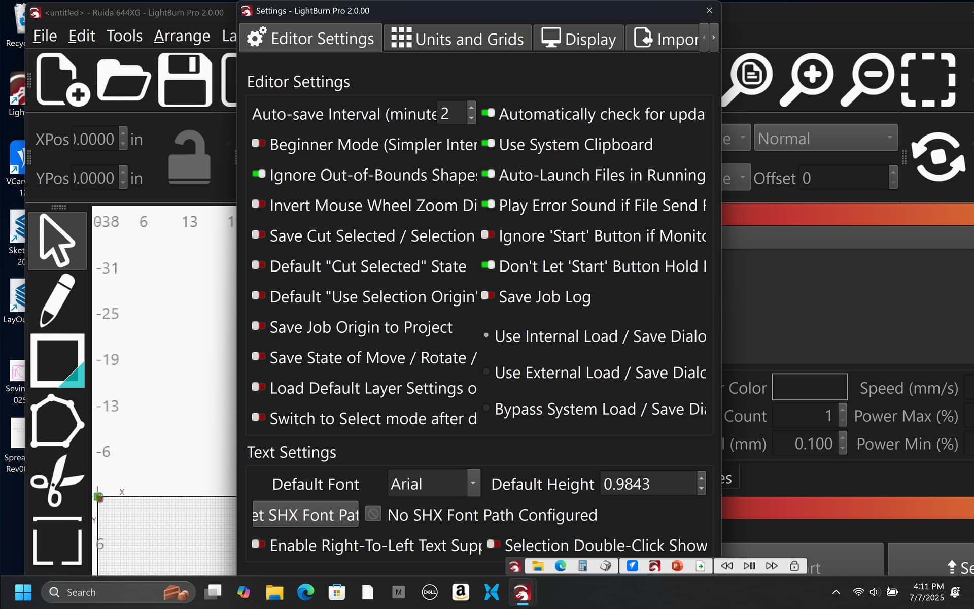

adjusted the suggested setting and it appears to be downsizing on the main window. Cut and Lser menu windows stay rather large

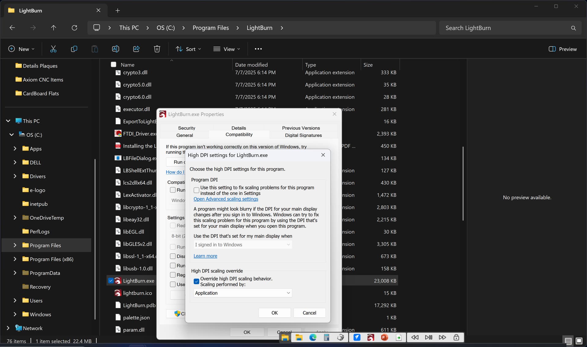

If it does work - try this for me as well

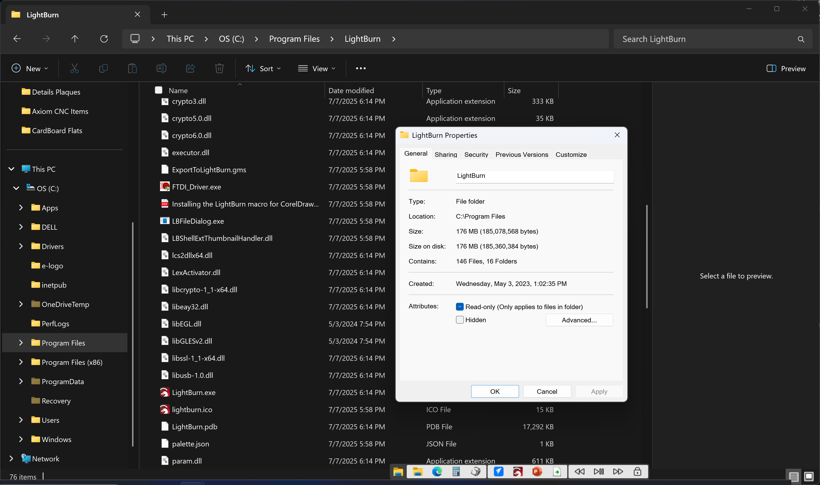

Navigate to C:\Program Files\LightBurn
Locate LightBurn.exe and right click > Properties
Then can you tell us what you see in the Change High DPI settings please?
This is what I have
Might have not explained fully
Right click LightBurn.exe → properties
The at the top Tabs, click the Compatibility tab
Click “Change high DPI Settings”
Then can you take a screenshot, as above?
This is odd, see the same as last screenshot … Restarted Lightroom and now I see all the tabs.??
Please uncheck “override High DPI Scaling behaviour”
LightBurn 2.0 will not require that any longer, and is what caused the issue initially - that is my theory at the moment
@GCCD could you also check this please?
That did the trick. Main window and side tab windows correct size now. I readjusted the Icon sizes etc to my preference as well.
