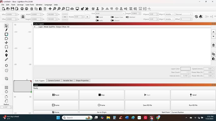

Ok I was able to try this suggestion and it has not resolved the issue for me. It still looks like this which is super frustrating. When anyone updates a program, they don’t want to have to reconfigure settings, change things within settings, it should have just updated the program. This doesn’t fix it for me… what is your next suggestion??
Hi I’m having exactly the same issue since updating to 2.0.00, for all intents and purposes the update is behaving as if it’s running in safe mode, there has no changes made by me other than clicking on the suggested update, it has now rendered the program pretty much useless. How do I revert back to the previous version?
Hi Guys, I have just gone back through the posts and followed the instruction to change the high DPi (within display settings) buttons to off, the issue for me resolved.
Thanks to all.

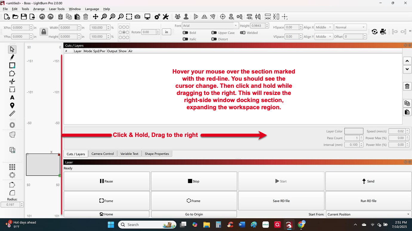

Below I show examples of how to resize the locations of docking windows. :slight_smile:
