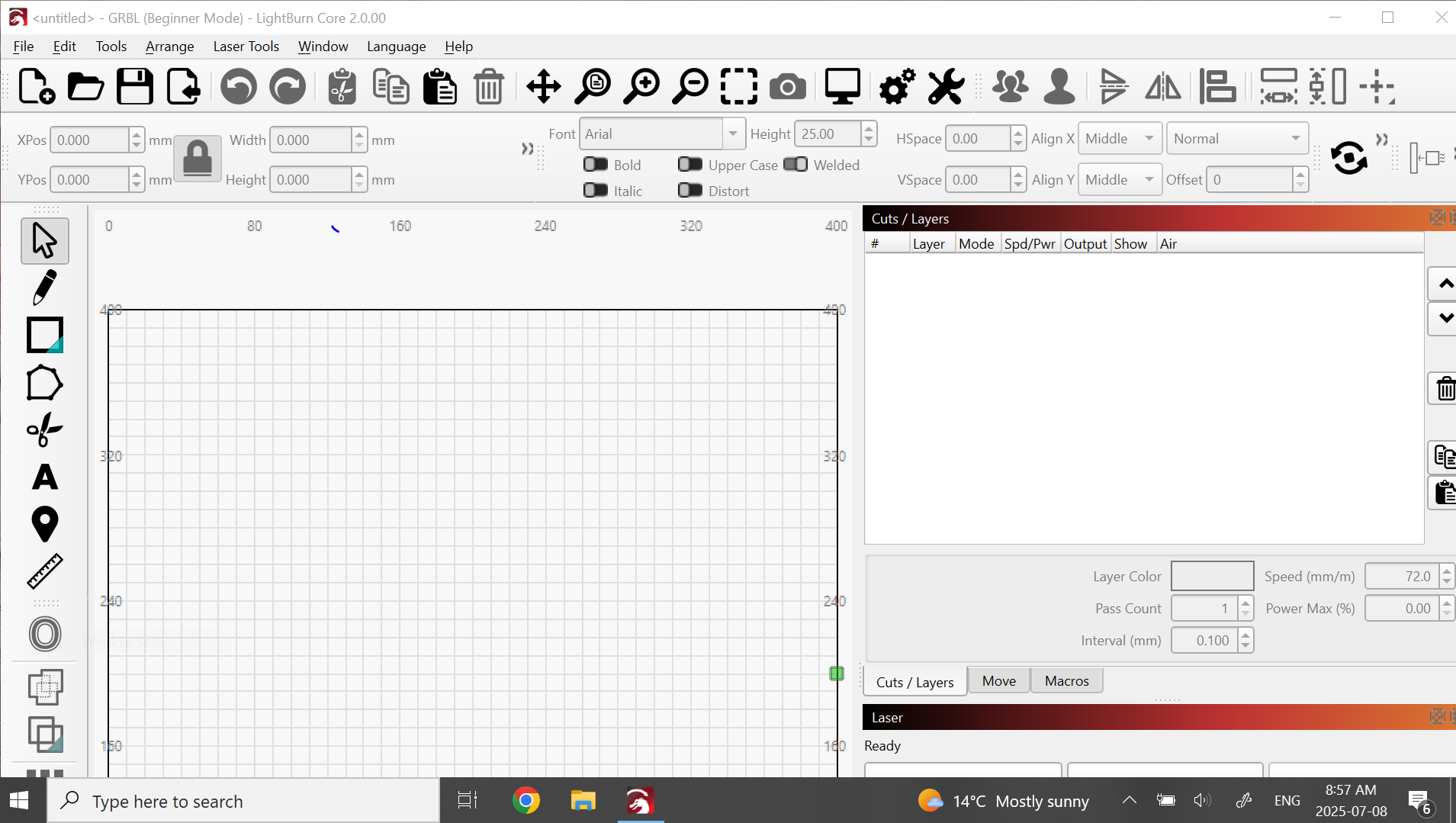

Lightburn 2.0 today - Scale Issue

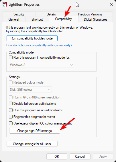

I am unable to locate the compatibility tab

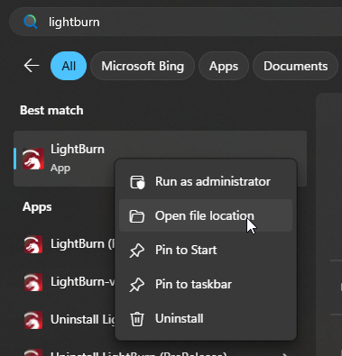

Try these alternative steps if you are on Windows 11
Click the Start menu
Type Lightburn

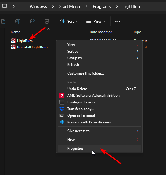

Right-click the entry
Open File Location
Then right-click LightBurn Icon > Properties
It should show this window
Okay. Got it. That is unchecked.

I am also having scaling issues. I have the following screenshots based upon the thread above. I can get more, if needed.

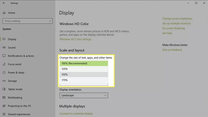

Navigate to Settings > System > Display.
Under “Scale and layout,” you’ll find the current scaling percentage
Can you tell us what it is set at?
Resolution: This was my issue… all fixed since changing back to 100% (mine was at 150%)
I had the same thing happen and I fixed it. windows scaling no more than 125% other wise it gets to big.

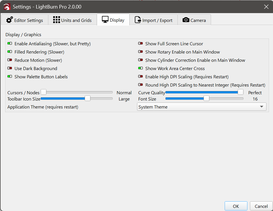

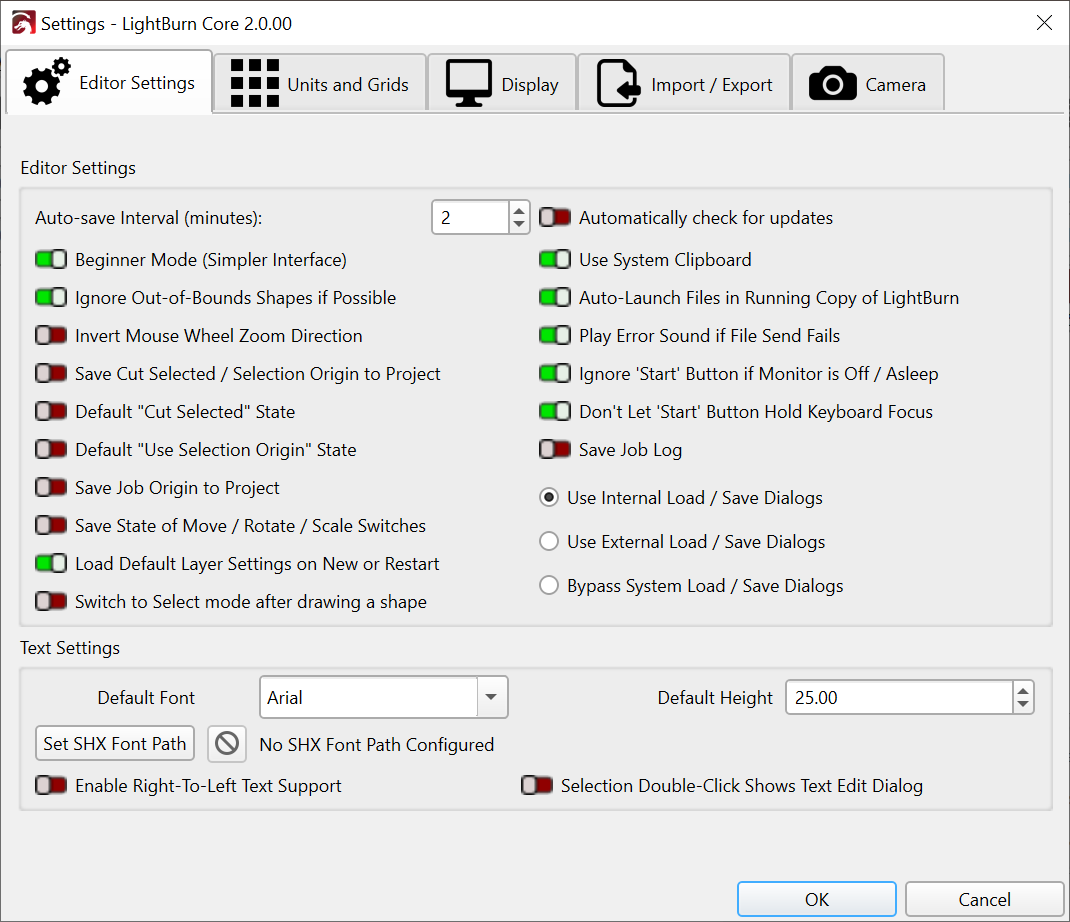

In this case, if you wish to have independent control on scaling From Windows and LightBurn try this
a) set Windows scaling for your preference
b) navigate to Edit > Device settings
Display Tab

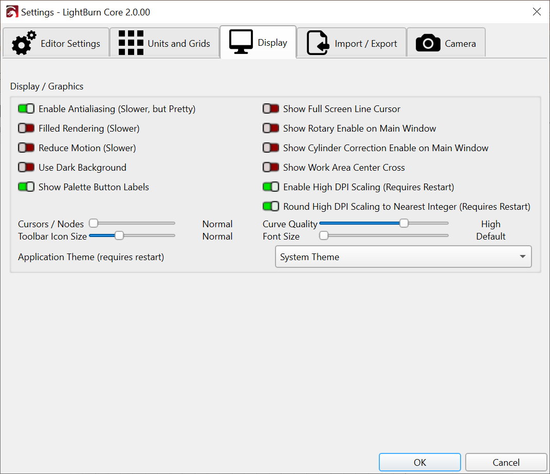

Disable both High DPI settings on Edit > Settings
Restart LightBurn
Now the font/Tool bar sliders will scale LightBurn to your preference independent of Windows Scaling:

Do you have a high res monitor with Windows scaling set higher then 100%? Try unchecking the 2 High DPS settings in Lightburn.
Thanks - this was the correct fix for me.
I have a 4K monitor (windows recommend scale is 150%) and that is needed to make all my desktop icons large enough… but this caused blurry / ghosted text in the menus, as well as larger than normal toggle switches in the Cuts/Layers window.
By de-activating those High DPI toggles as you described I was then able to use the sliders to dial everything back to correct size and so all appeared clear & crisp again.

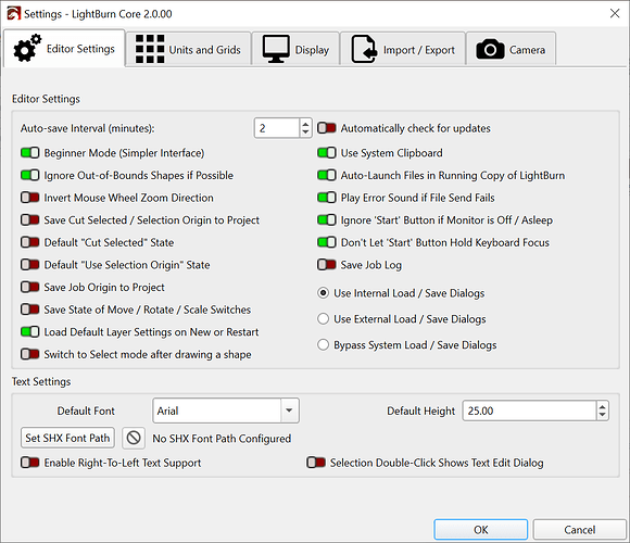

I have the same issue, this is not resolving the problem unfortunately!
Have you tried these steps?
b) In LightBurn disable High DPI settings on Edit > Settings
Restart LightBurn
