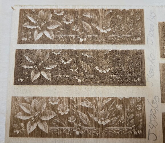

I’ve been doing some messing about this morning. I know that apparently CO2 lasers are better for this sort of thing and also that wood is not an ideal medium. Just getting that out of the way.

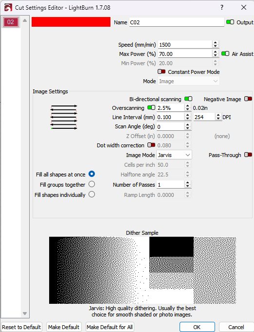

So I took a grayscale PNG that is intended to be used as a depth map for making a 3D illusion engraving and experimented with various settings on my machine engraving on a piece of Baltic birch plywood. Thought some others might find this useful and save them some time.

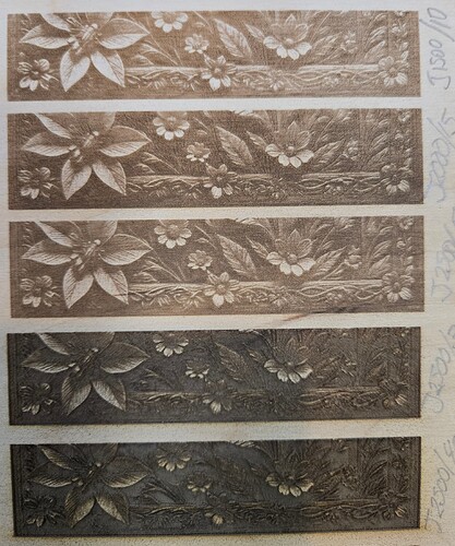

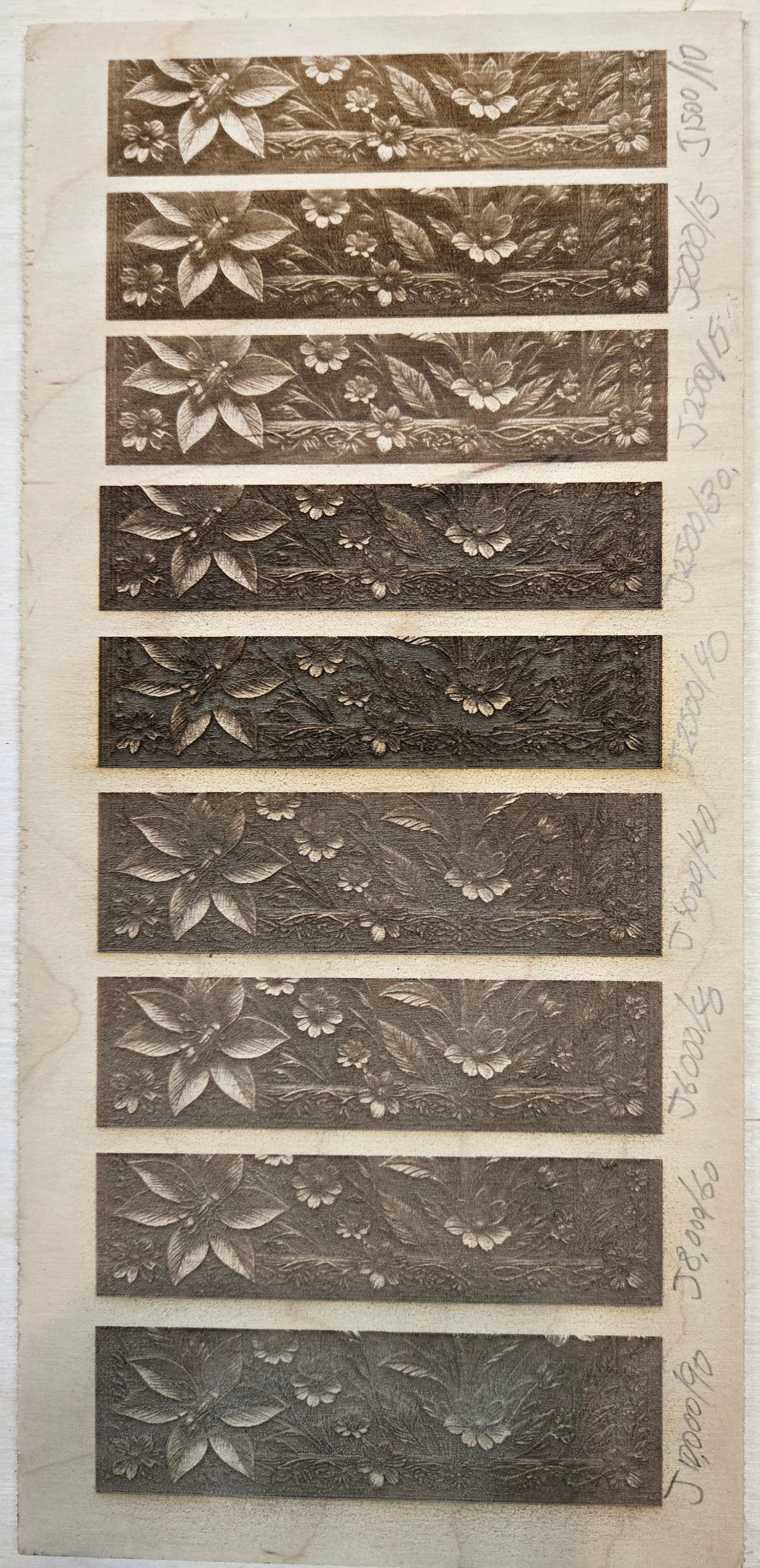

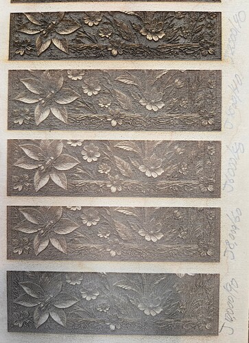

All of these tests were done only by varying the speed and max power on the image cut layer. I used Jarvis mode for all of them. In the pictures I’ve written the speed/power next to each test. Note that having the laser scan with the grain vs. across the grain makes a huge difference in the smoothness of the engraving, which I suppose makes since.
In the cut settings window are you supposed to make the line interval DPI match the DPI of the image? I have no idea why lightburn chose the DPI it did.

Lightburn did not choose, it just remembered the setting from a previous project.
I have no idea either. But I do know burning burning wood tends to reduce the resultant resolution. Most times, I use 254LPI (0.1mm interval) because I see little improvement at 318LPI with my 10w diode.

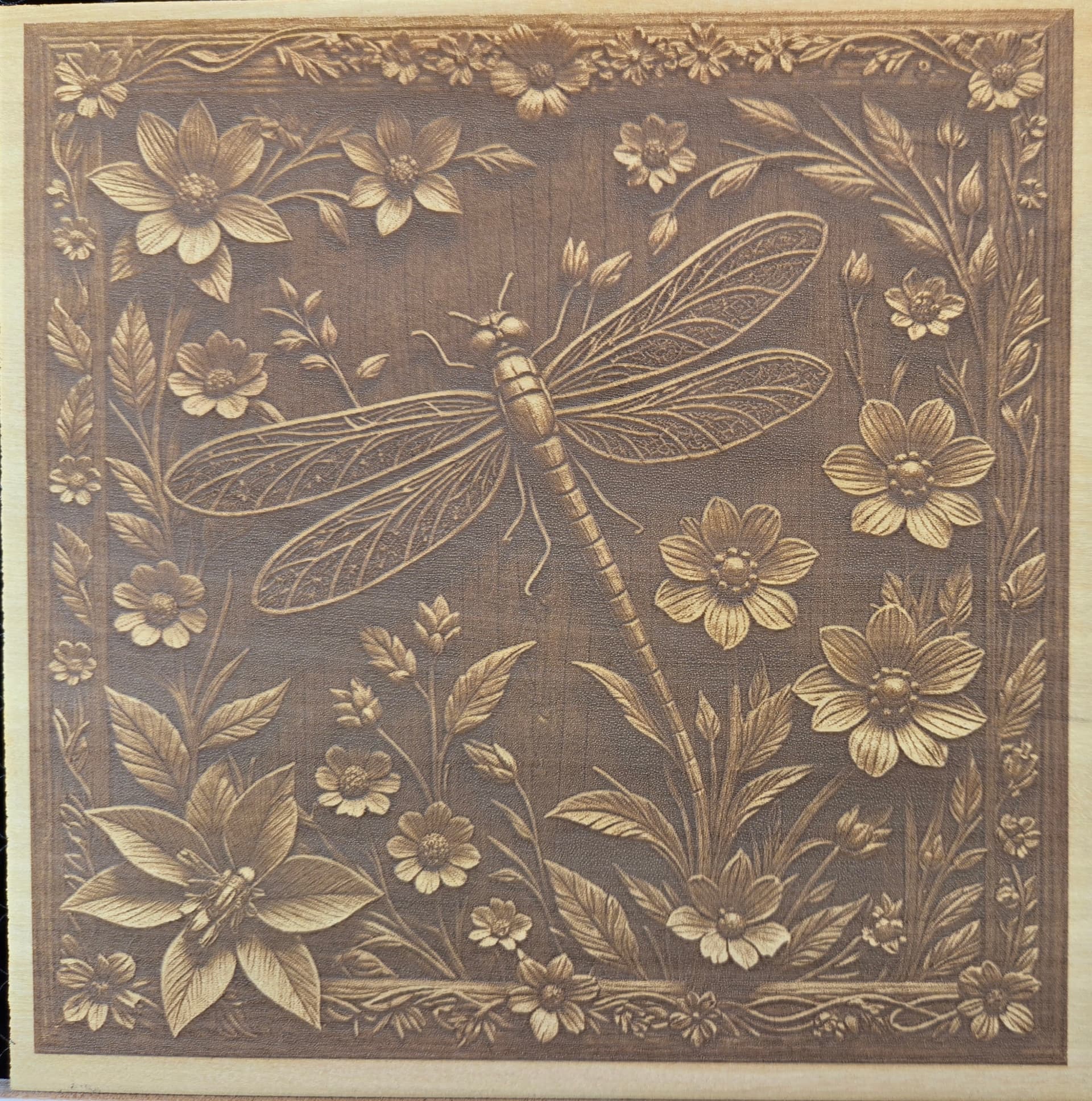

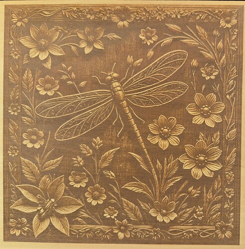

Here is the entire image engraved on a piece of yellowheart wood. Using Jarvis, speed 4000 and max power 15%. The first pic is the first engraving. Second I ran the whole thing again with the same settings. Third I lightly sanded with 220 grit.

If you wish Lightburn to not modify the original artwork, you use the passthrough option in the cut/layer edit window. This is used with output, such as Imag-R or other processed images when you don’t want Lightburn to change the created image.
If passthrough is not enabled, Lightburn will dither or make the dpi as the user has set within the cuts/layer window.

Those are two different settings that should not be mixed. The DPI/LPI setting in LB defines the steps it uses to raster your image. If you set it to 1 LPI, it will do one (scan) line per inch and the hop another inch and do the next line. You need to match this with the capabilities of your laser. It’s a physical value. You should set it to the height (size) of your laser spot. When doing so, each line that is lasered is directly following the next line. If you decrease the value, you will get space between the lines, if you increase it, the lines will overlap.
