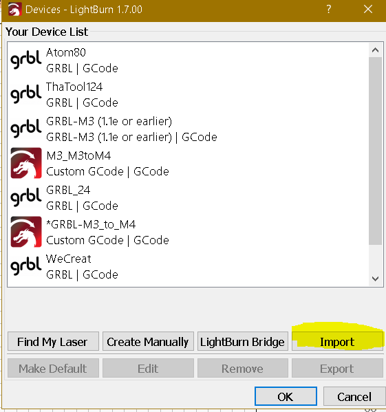

Setup a new device by importing this xTool-D1ProV3.lbdev (3.9 KB)
Come back with more questions.
Yup; did that. It got me connected to the xTool, but with the issue described.
