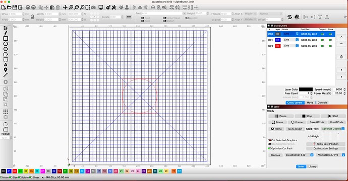

Also, please include a full screenshot of LightBurn with your design loaded, Cuts and Laser window showing.
Below are the commands I ran from the Console. I can’t figure out how to upload the screen shot. If I paste in this window, there is no image.

I figured out how to add the screen shot.
I don’t see anything odd in the output of the commands.

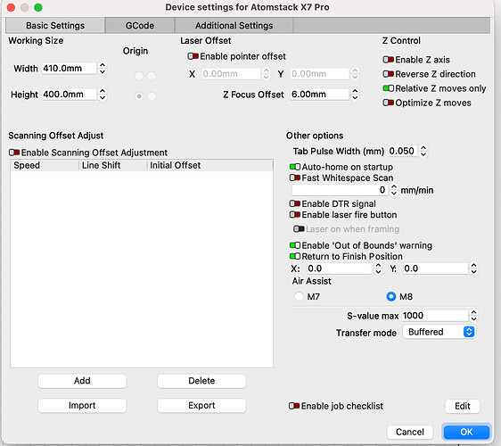

Can you provide another screenshot? Please go to Edit->Device Settings and take a screenshot there.

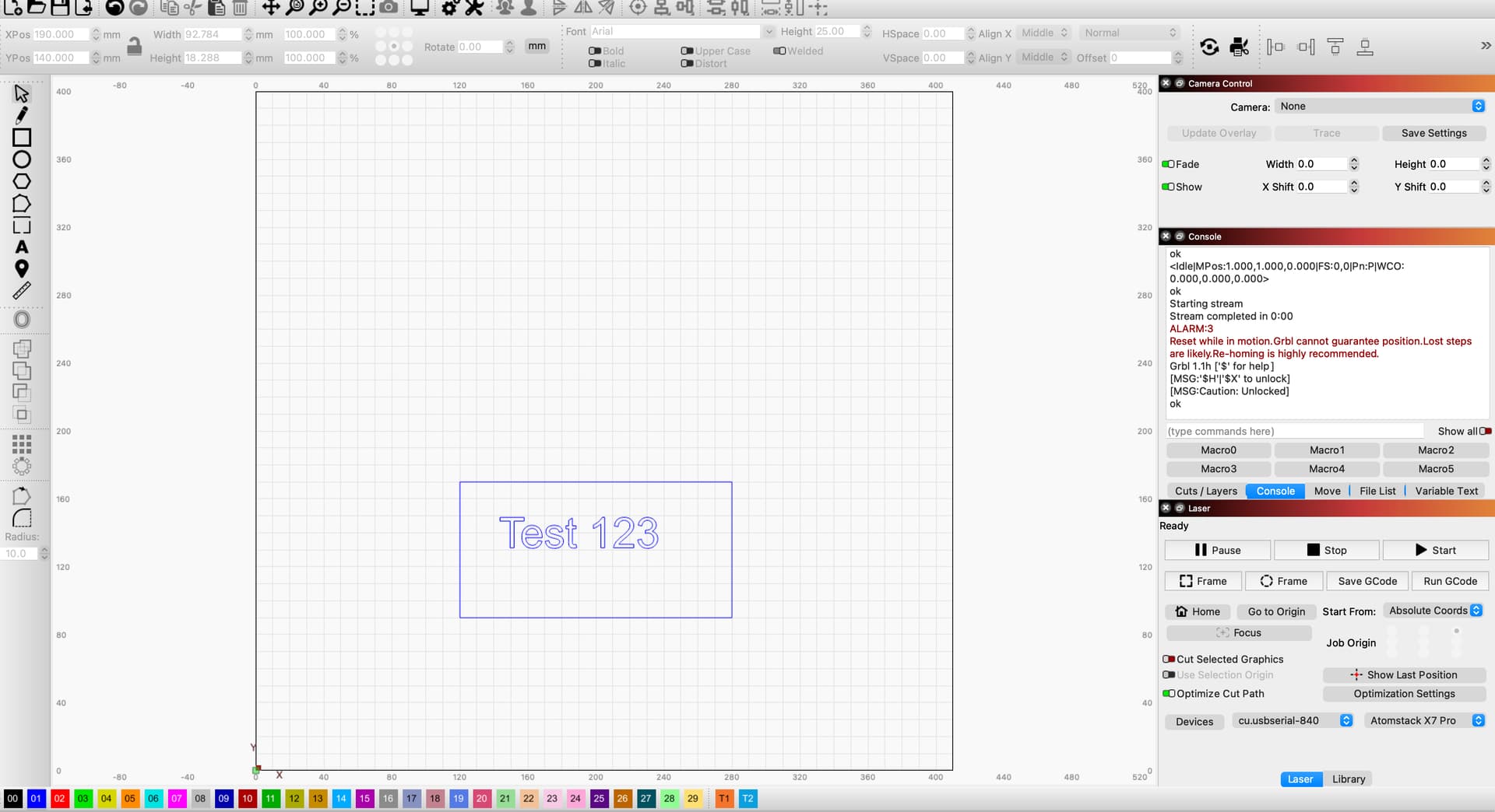

Here is a screenshot of the device settings; I also created a simple file with just text, When I push frame, the laser will go to the spot and stop, it never frame.Will send you a screen shot of that next.
Here is the frame screenshot. The laser will move to the position and stop. I have to press the stop button to move it by hand . Tis was a new file I created and it does the same thing.

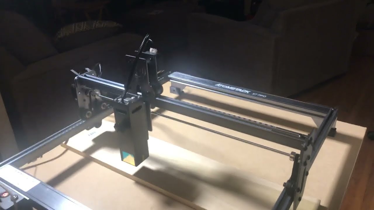

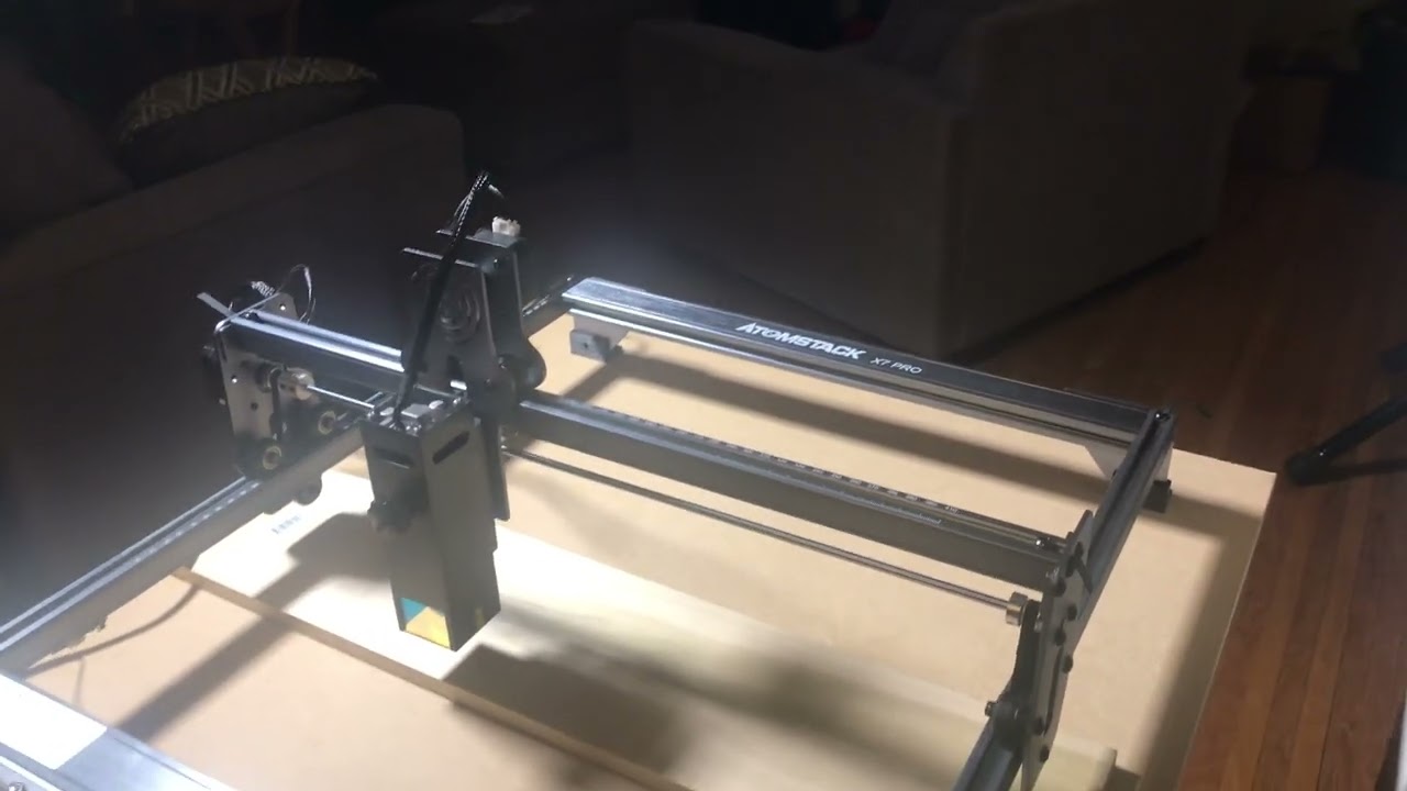

I’ve uploaded 2 videos to YouTube, one is framing the the other is burning. Noticed that the laser will stop in one place for both frame and burn. I also just removed and reinstalled both Lightburn to v1.2 from 1.3 and the device. However it still does the same thing. See YouTube links below.
Framing
Engraving
Note that you may have missed my previous post.
I’ve just reviewed the videos. Interesting behavior.
