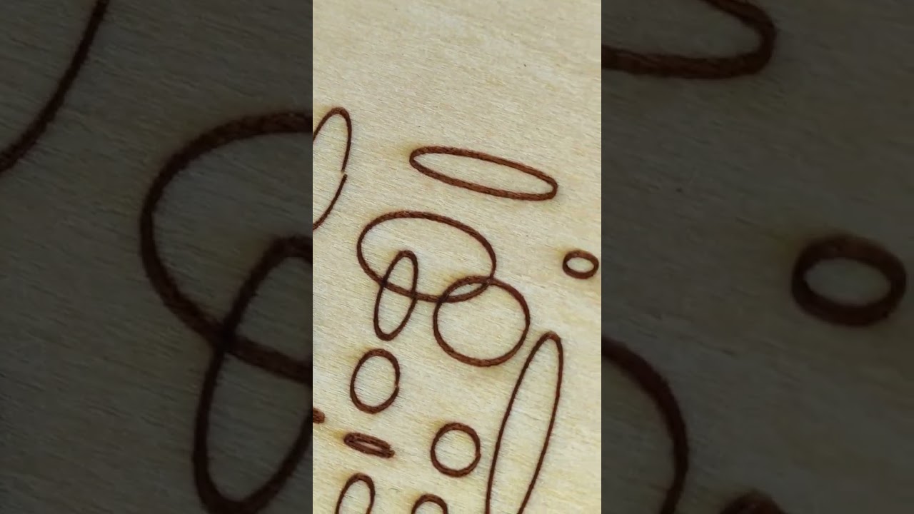

I am new to Laser engraver and just got Atomstack A20 MAX, and making some test engraving with LightBURN software.
As to the accuracy, I do not get quite satisfying results as shown on the photo,
On LightBurn, the graphic is firmly designed but after laser processing, the lines do not match (circle cannot be completed in a firm way, path does not connect exactly)
Could this be potentially a setting issue?
Or any potential defect in the hardware?
-I have cleaned up the rail and confirm there is no debris or any objects on the rubber rail that might hinder the smooth motion of the rail
-I use the genuine focus scaler to set the focal point,
-I need to carry the engraver hardware around every time I use it as my workshop is not fully ready yet, but no physical damage such as dropping, bumping the machine to something else etc
-I use the Honeycomb, the wood plate to engrave is firmly placed on Honeycomb with not bend
Could anyone help to locate potential solution for this, highly appreciated, Thank you in advance.

I found out that I cannot even make a simple circle, drawn on LightBURN

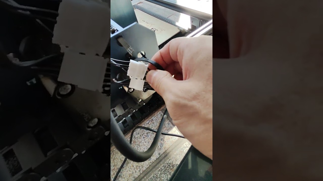

I did some more adjustment,
  1. Assembly
    Check specifically that the pinion gears attached to the stepper motors are properly secured. The grub screw should be tight against the flat of the stepper shaft.
→ I found the 5mm shaft that connects the left/right pinion gears was moving wavy when I moved the X frame back and forth, I realized that the gurb screw needs quite a torque to firmly hold the shaft, I screwed it again tighter and now the shaft moves intact horizontally when moving.
It seems that the gap of circle is now smaller than before, but not fully firmly connected.
As to the belt, I pulled with possible max tension and gradually loosened it on Left/Right-Y and X axis, with the max tension the circle’s junction point’s gap was large, as I loosened the belt, the gap became smaller but at one point the belt got slack and cannot loosen further (gear does not interlock anymore), thus this solution did not fully solve the gap of circle.
  1. I also did some change in Backlash adujstment (as per the information on websearch, changing 200mm, 400mm, 600mm, 800mm speed’s setting value to + and -) for 0.1, -0.1, 0.5, -0.5, etc, so far there is no change.
    I fired the Loren’s file onto the woodplate and I saw around 1mm width difference on the vertical 2 lines, I might need to do some more experimentation on this setting.
Overall appearance of my device is uploaded for your reference, if you could have a quick look and see if there is any anormality, please adivise, highly appreciated.

Circle is a full round circle with 5 - 8 mm diameters,
please see the shot test result with backlash adjustment OFF,
Red square is the concern, it is still there. I found out that the line (laser) width of vertical and horizontal also differes, could this be a clue?

Asymmetry of laser dot is typical so not a complete surprise.
I see that some of the cirlces are actually circular. But others still show an issue. Does the problem only show occasionally?

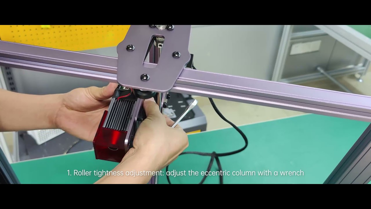

Revisit X-axis mechanics. Are there any other joints other than between stepper motor shaft and gear? If not, double check the grub screw again. It’s very likely that there’s still some movement there.
Here’s another user with the same issue. His fix was to adjust the eccentric wheels
Here’s a video on how to adjust eccentric wheels. Done make them too tight. Just make sure there is no wobble on the X and Y axis
From what I remember of that Topic the issue was slightly different. The problem they were experiencing was distorted shapes. They were not experiencing disconnected circles.
Distorted shapes would point to belt tension or wheel tension issues.
I don’t think that’s what OP is experiencing.

I remember there was a hex wrench was inside the packing, not sure to use for what because it was not described on the paper manual, but I will go now and try,
and will report back soon.
With the latest try with Loren’s input,
unfortunately it still happening that the circle is incomplete,
The hex nut seemed to be already optimal, no wobble,

it happens to the same position of the same shape no matter where I start,
This is the newest try (Ellipse):
The gap is getting minimized, but still not suitable for very accurate drawing or metal cutting (could be used for wood cutting,) I want to make a nice signboard for my wife’s restaurant, I hope I can clear this issue soon,

I dont think you need to loosen the belts. Just move the gantry all the way forward and make sure both sides are touching the front plate then adjust the eccentric screw so there is no wobble. Then see if there is any wobble in the x axis and adjust the eccentric screw as necessary. Dont make them too tight, just tight enough to eliminate any slop
