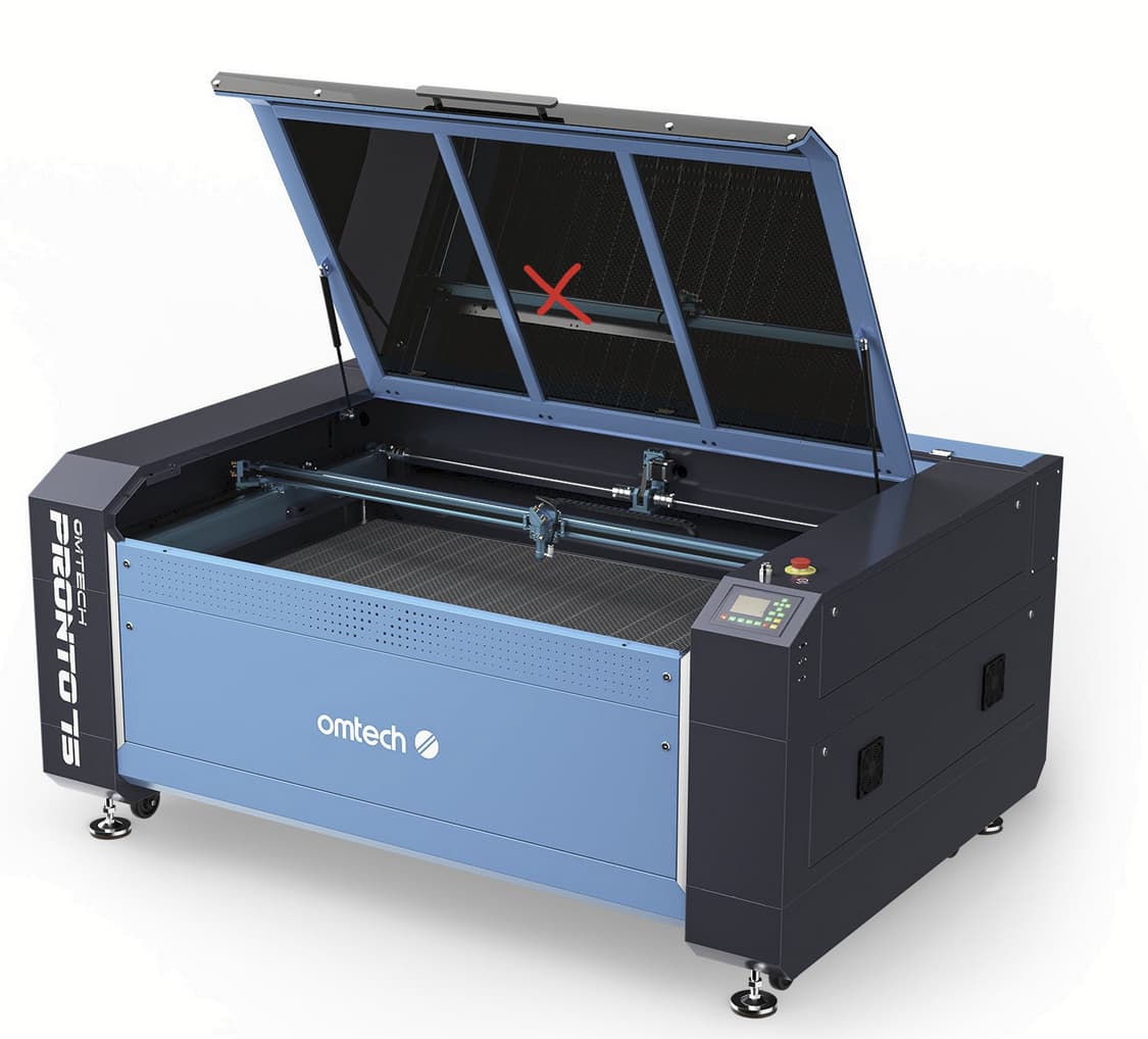

I just recently purchased (awaiting delivery) an Omtech Pronto 75 with a 1600mm x 1000mm bed which I’m told by Omtech has a lid open height of 1330mm, I’m trying to decide which 8mp Lightburn camera to get, the 85 degree FOV camera needs a 1384mm mounting height for that size bed, the 120 degree FOV camera only needs 700 and something millimeters mounting height.
Am I better to get the 85 degree or the 120 degree camera?
What do they consider “lid open height”?
The important part is the mounting height from the bed to the camera. See here
With the lid open, you mount the camera where it is roughly in the middle of the workarea, pointing straight down.
On this machine, that would be about here:
I’m leaning towards the 120 degree camera.

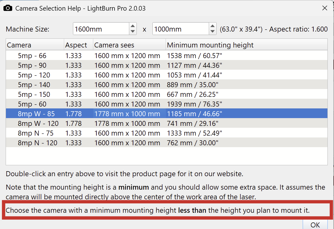

Here’s a screenshot of LightBurn’s “Help > Camera Selection Helper”:

The maximum possible accuracy is directly related to the size of the working area and the resolution.
In this case: 8 megapixels (≈ 3840 × 2160 pixels), spread across a workarea of 1600 x 1000mm
Thanks Aaron, that’s interesting and useful info. It also covers the relatively low resolution from my replaced LB camera, 85 degrees at 4 mp, that’s right on the border of a necessary resolution.
