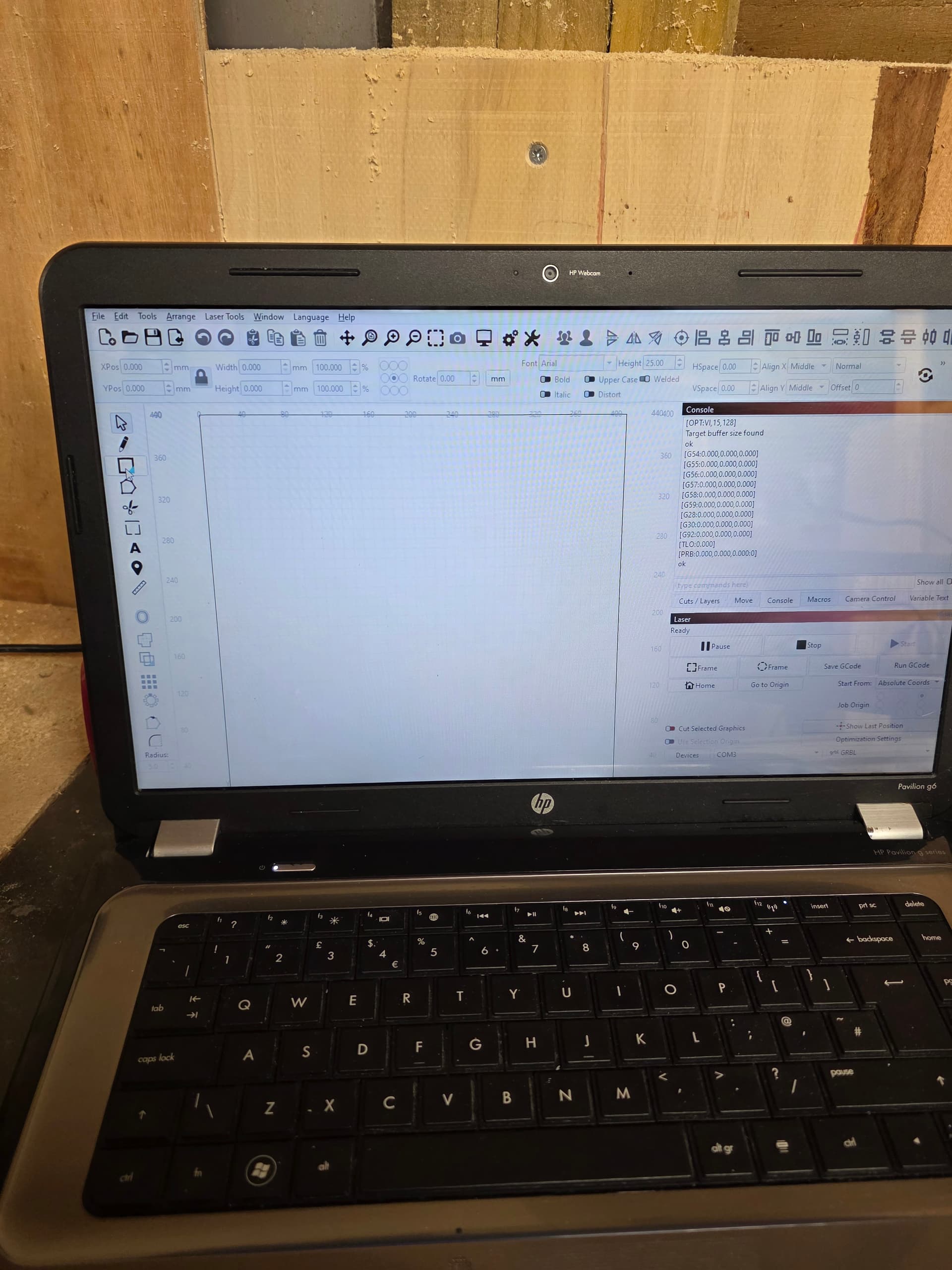

Thank you. I eventually found the driver online and got it up and running. I am however finding a new problem. I downloaded the trial version of lightburn and have watched countless videos of how to set it up etc. I seem to have a few things missing from my version (downloaded directly from lightburn), one being the circle tool on the left hand toolbar, and another is the coloured tabs at the bottom. I am probably doing something wrong but jist can’t figure it out. Any help would be greatly appreciated

I can’t see the LightBurn Version on your computer either. Top bar is also missing.
With LightBurn 2.0 and on, the added features are needing more screen area.
I looked up the HP Pavillion G6 and the screen size is something we refer to (in jest) as ‘The Devil’s Resolution’ because of the 3 sixes in the pixel count.
The 15.6-inch display features a standard 1,366x768-pixel resolution and is LED backlit.
Please test the suggestions linked below to rescale LightBurn to fit your monitor.
Please let us know if this gets you up and running again.
If you are missing the red Close “X” at the top and the row of Layer colors at the bottom, a quick fix is to use WinKey + UpArrow. This will maximize the window.
Thank you thank you thank you. This fixed it straight away. I can finally try and get to grips with creating.
